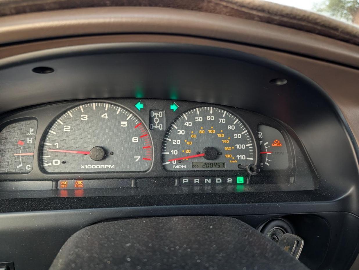

Since the neg. batt. term. pull, no codes displayed with my AD310 scanner.
I have the AD310 with me now so the next time it happens and the dash lights up like this, I can display the code.

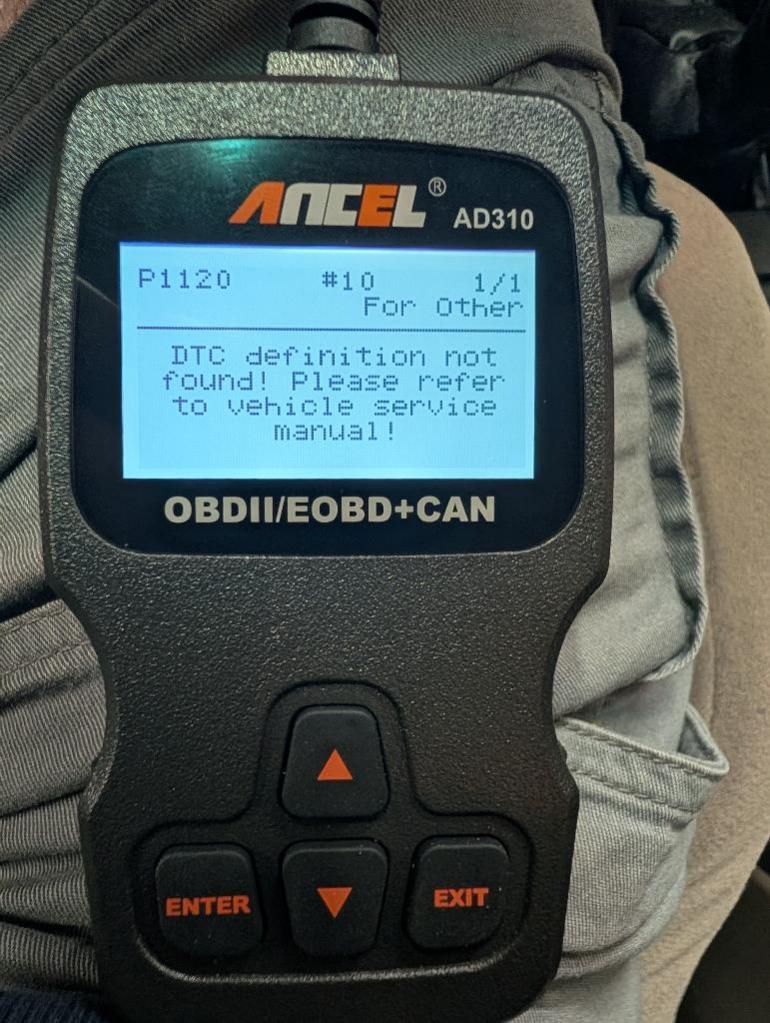

I think we're getting somewhere folks. Just went into LM on the way home from my Mom's ALF. Same as last time, which is crazy.
Anyhoo, it threw a code and here it is. I'm so durn excited to know what I'm dealing with now.
Updates ASAP.
Eddie
Updates ASAP.
Eddie
Code P1120 indicates a fault in the Throttle Position Sensor (TPS) or Accelerator Pedal Position (APP) sensor circuit
I've been down this road twice.
Someone here may have the procedures to test both of those items.
If you need a new throttle body shop around and look for Toyota sales. They're not cheap. Goodluck!
