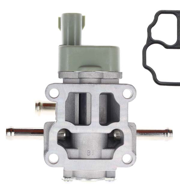

I had the same issue and found a way to fix it and it solved my problem. Clean the Idle Air Valve. At times this is the cause for high idle where the inlet groove are filled with black tar.
[MENTION=143488]binqker[/MENTION] Good suggestion for other folks, but the OP mentioned he already cleaned the IAC (he called it an AIC).
