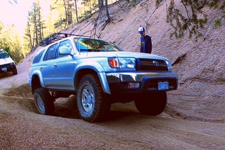

I was on a trail. Got stuck/wedged in a HUGE dry rut. I managed to get almost out, and then my front left wheel lost all traction. I believe it was airborne. I backed up...nothing. Put it in drive...gunned it a bit too hard...moved only about 2 feet...and then braked hard to stop the wheels from spinning (why did I react this way?) -- and POP....off goes my CV axle, and my 4wd barely worked. All kinds of teeth got chewed.

This was me right before I hit my brakes and shit broke...
