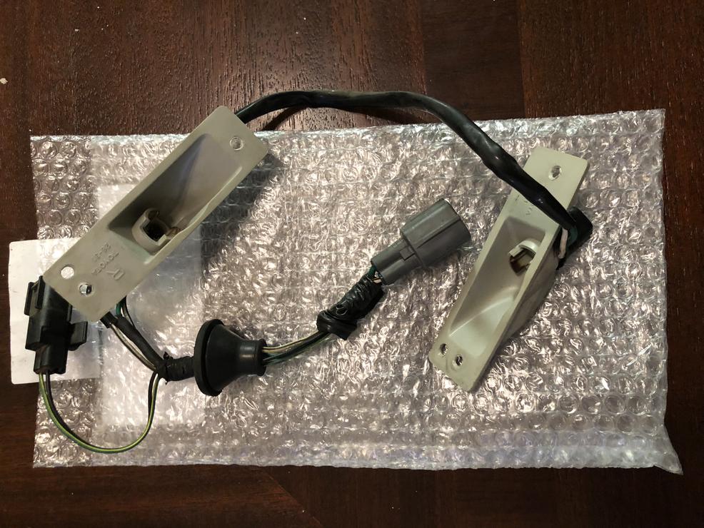

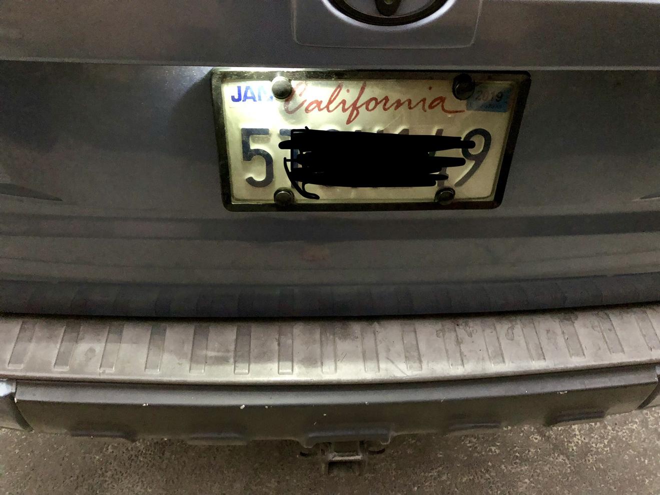

Sorry to bring this tread back from the dead but I just don't know what to do.:shrug: I have a 2003 4Runner. The right license plate light was not working so I replaced the bulb and still nothing. I've had LED's in the vehicle for about 6 months now and no issues. Next I proceeded to think it was a wiring issue so I replaced the whole harness where the lights attach together, and nothing. The left side works perfect but not right. I would check the fuse BUT since the left light is working fine wouldn't both be non-operational? The reverse lights are working fine as well. Left me know if you guys have any solutions. Thanks You
