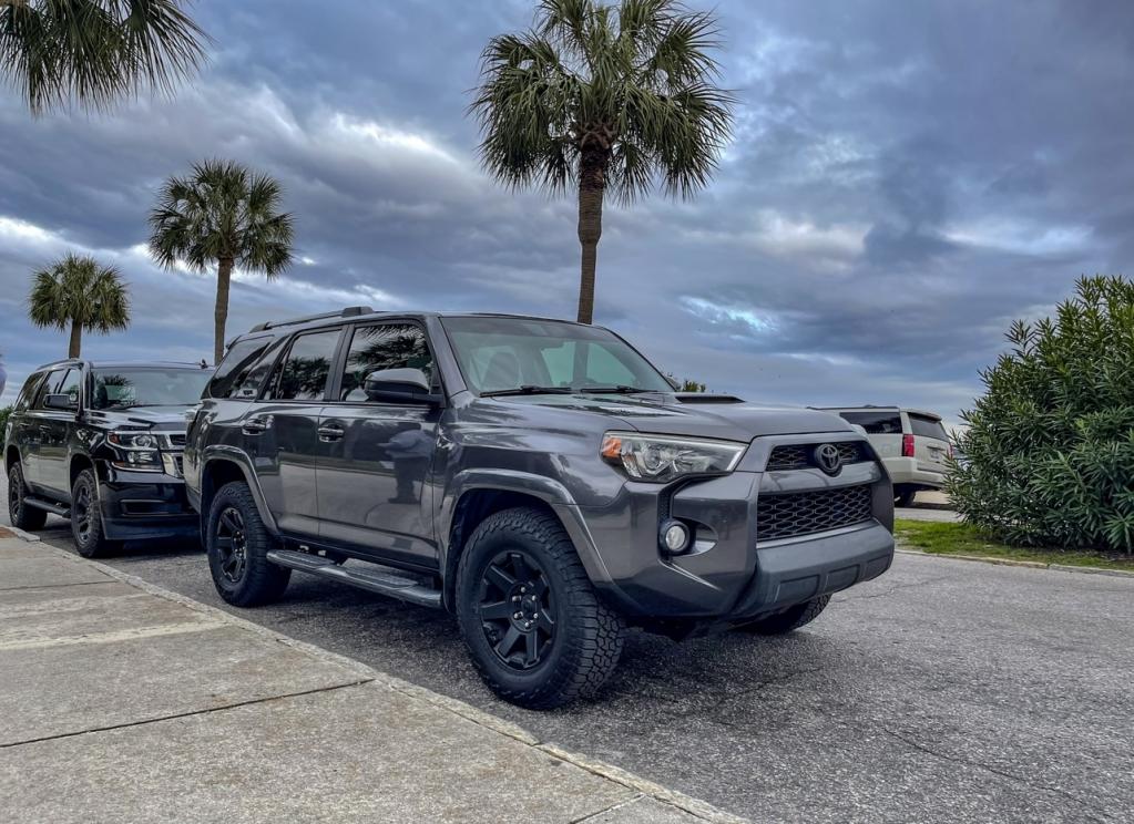

That's a clean-looking Trail right there, and I LOVE the mag grey color it was my first choice but the super white I found was too good a deal to pass up. Welcome back to the family.

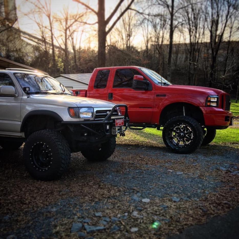

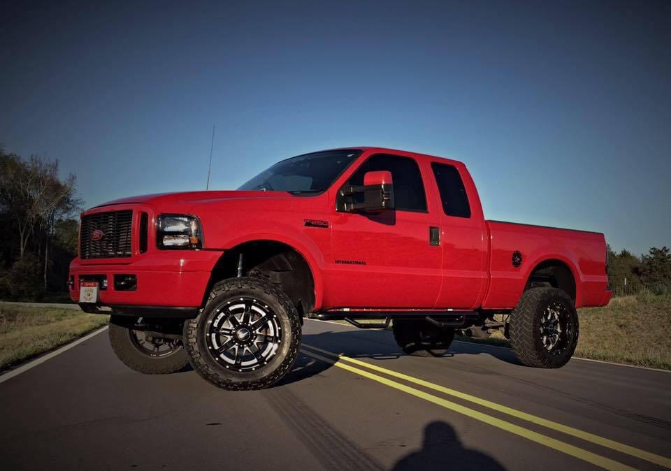

Let's see the Powerstroke! Looking into one shortly for another tow rig.
It’s a 2000 7.3! I added the 2006 front end and 2008 back end. My plans are to lower it a couple inches and get rid of the stack, it’s not as cool as it used to be haha. It’s been a great truck though, I’ll never get rid of it!

Sweet trail, but the 13 trail would’ve been even better looking! but yea can’t wait to see it come together !
Nice. I'm looking into the 7.3 gas motor. No need for a diesel for me.

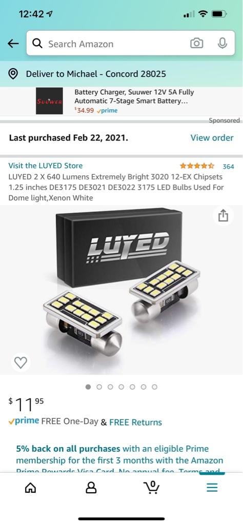

The first thing I did was tackle the rear hatch lights. The previous owner swapped some LED’s into them, but they were so dim they had to be worse than stock. I found the drop in 4Runner specific LED panels that are around $100, but I really didn’t want to spend that just for hatch lights. So I found these bulbs on Amazon, and for $12 I figured it was worth a shot.
The swap was easy, just pop the light housings out (push in on the gold clip), take the lenses off and swap the bulbs. I couldn’t believe how much light these little bulbs put out, it’s like daylight under my hatch now!!

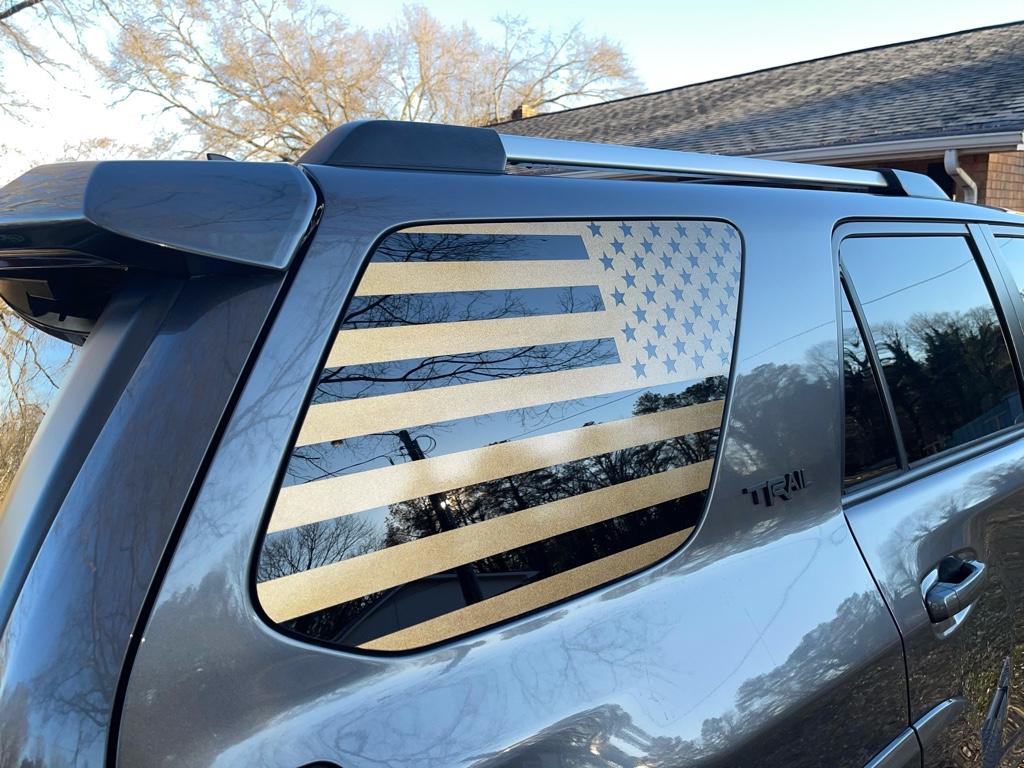

The next mod was the classic, maybe overdone, but still cool American flags in the back windows. Because ‘Merica. I run a sign shop so this was an easy one. I cut them out of 3M black reflective, which is a little twist on what most people have. I think they turned out cool!

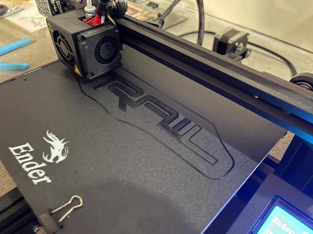

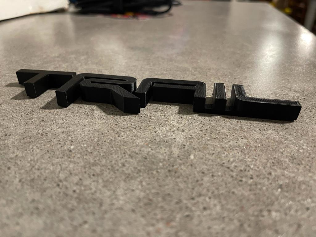

The last thing I’m working on are some replacements for the “Trail” emblems. The previous owner 3D printed the ones that are on it, but I wasn’t happy with the font. I have a 3D printer so I decided to see if I could improve on the idea. I drew up the file and got some help with making it ready to print on a 3D printing forum. After a few attempts, I’m happy with how they came out. I’m working on sanding and painting them now and then I’ll update this when I put them on.

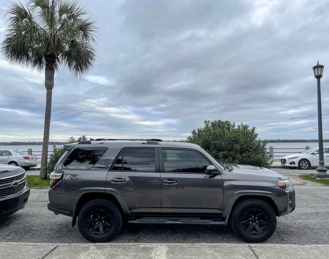

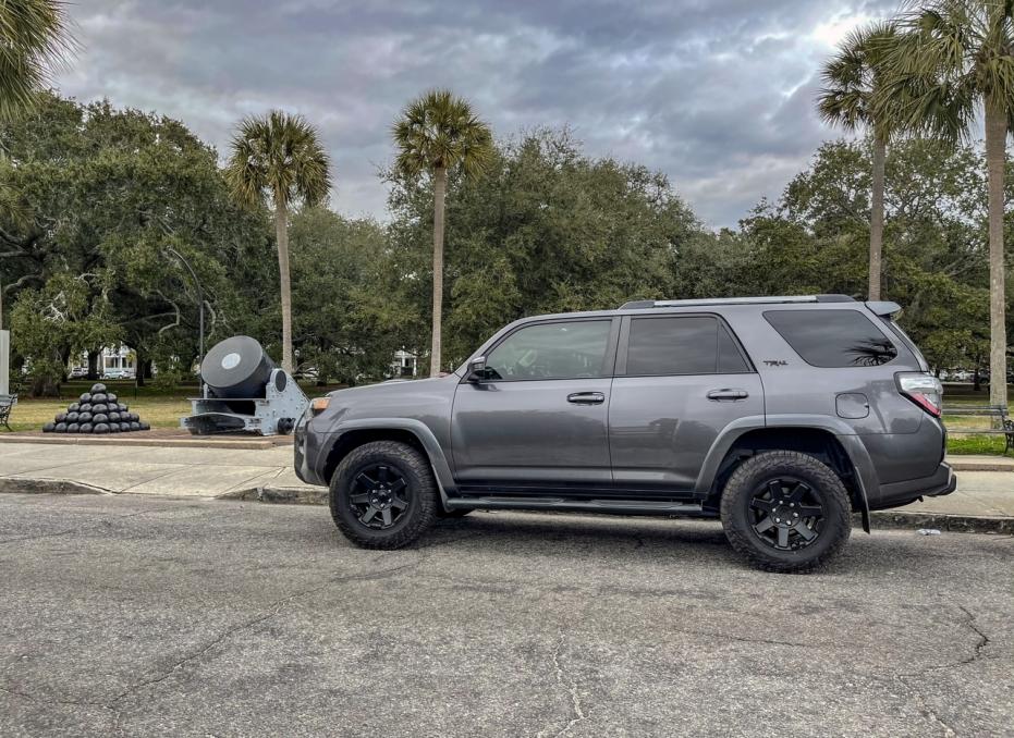

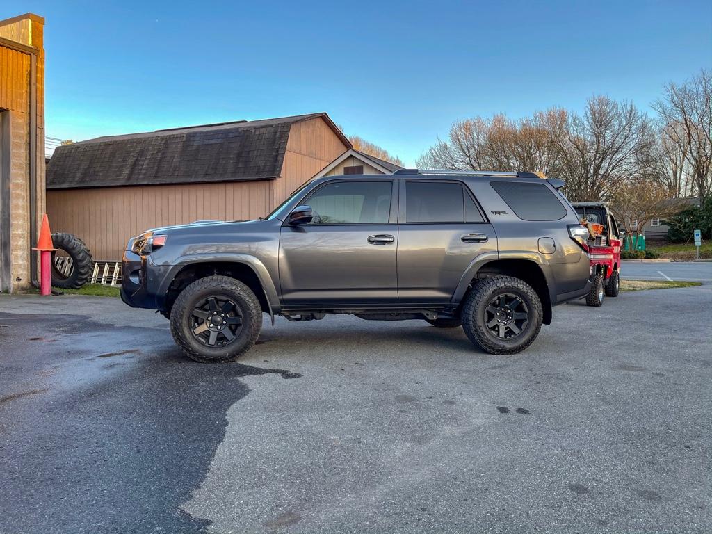

I knew I would be bad at updating this thread... haha. So some updates. Lift/level kit is on. I went with Bilstein 5100s all the way around and 1” Cornfed rear spacers. I was nervous going into it because of all the posts about KDSS nightmares, but there is really nothing to worry about. It went smooth and the KDSS didn’t cause any issues. I set the front at 1.75” but now I’m wishing I would’ve went all the way up. I still have a slight forward rake but with the way the wheel wells are offset on the 4Runners it still looks like I’m nose diving. I’m debating on taking it all back apart again to move the front up.
I also added the Pro grille, Raptor lights and a front tag holder. All of that was a very fast and easy install. I know it isn’t a Pro, but in my opinion all of the 4Runners should have came with this grille from the factory. I was going to paint the letters MGM, but honestly the dark silver they came in looks nice. I also know that the Raptor lights are “played out” and overly popular, but I like the look.

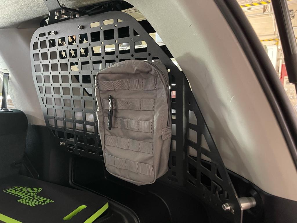

After the leveling kit, I dumped the Westin running boards and ran across a few deals. I ordered an Artec Venture Series front winch bumper from Dino’s Offroad and also bought a set of Rago rear window panels from a guy on one of the 4Runner Facebook pages. I installed the rear window panels (very easy install) and ordered a Rough Country 9,500 lb. winch for the front bumper.

Looks good! I have a 2014 Trail w/ KDSS like yours. Agree that all the horror stories about putting a lift on a KDSS equipped 4Runner is mainly smoke. The rear is pretty straightforward (just put my 3rd set of springs in). The front gets alot easier with the use of ratchet straps.
