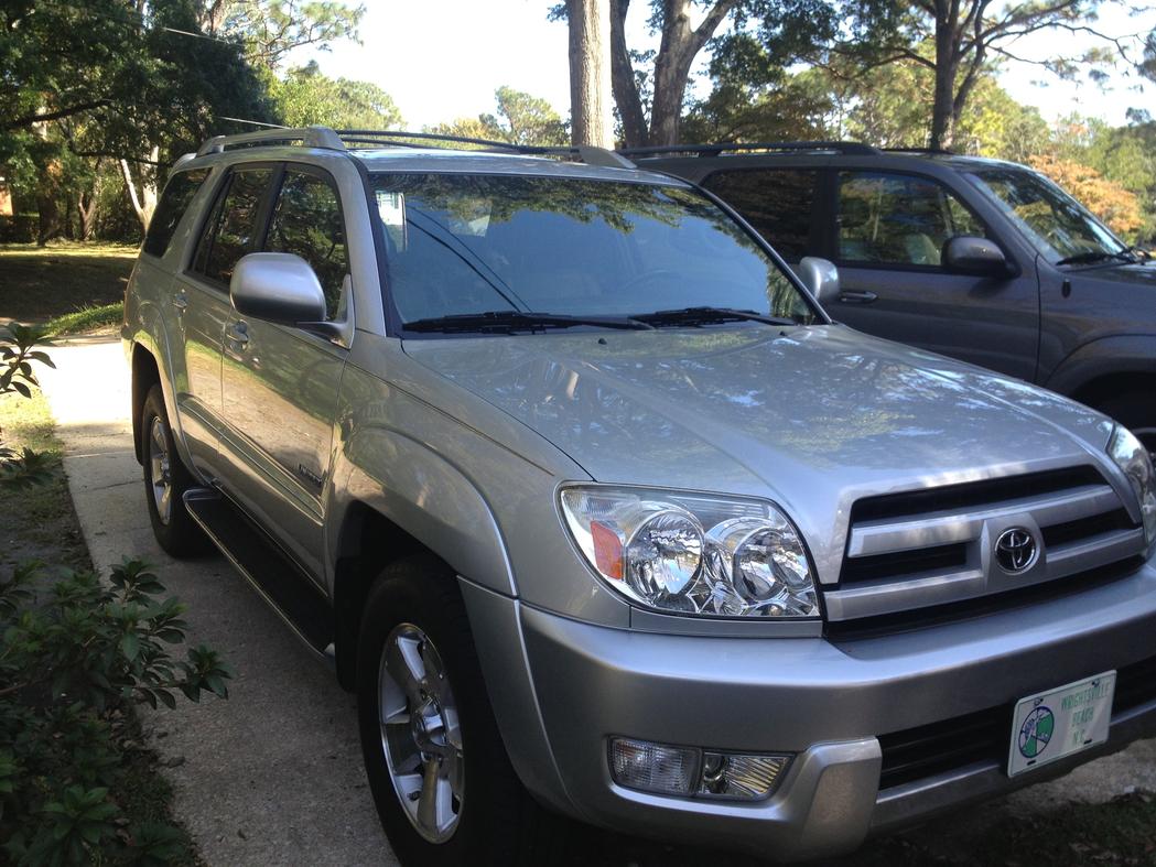

My New 4th Gen (pic), sunroof question
tnichols
I recently purchased a 04 4Runner limited, 6cyl 2WD. Yeah, I know... 2WD. I feel ok without the 4WD because where I live, snow will not be an issue. I don't go wheeling, and when I need to tow things I will use my Sequoia. Just needed a reliable everyday driver and came across this one. 80K for milage which I consider low for a Toyota, in great condition, and I was able to get it for 14K, so I went for it.
