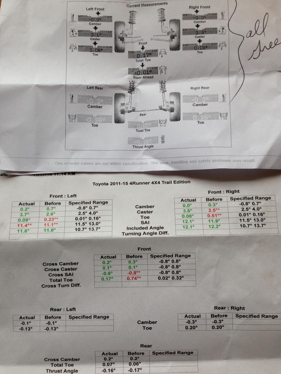

Had my 4R aligned 1 week ago today at dealer, top sheet with the after numbers.
Today had post lift aligned at Les Schwab, below sheet, their sheet showed different before numbers than dealers after numbers. Do different alignment machines read different.

All your angles look good. How does it feel on the road?
Yes, you may see different numbers on different machines due to many factors. If I saw huge differences I would be concerned though. It's not uncommon to see different numbers on the same machine from just driving around the block.

Felt good so far, hit I-5 in a bit heading to work, will see how that feels. I did ask the tech to work the caster closer to 4.0 with out sacrificing other specs.

Just made the drive to work, hard to judge the high gusting winds had me fighting. Be a few days before the hight winds die down weather reports say.
Stupid me! Just hit me of cousre the numbers would be off from dealer alignment, the shop had the suspension apart for the lift.
