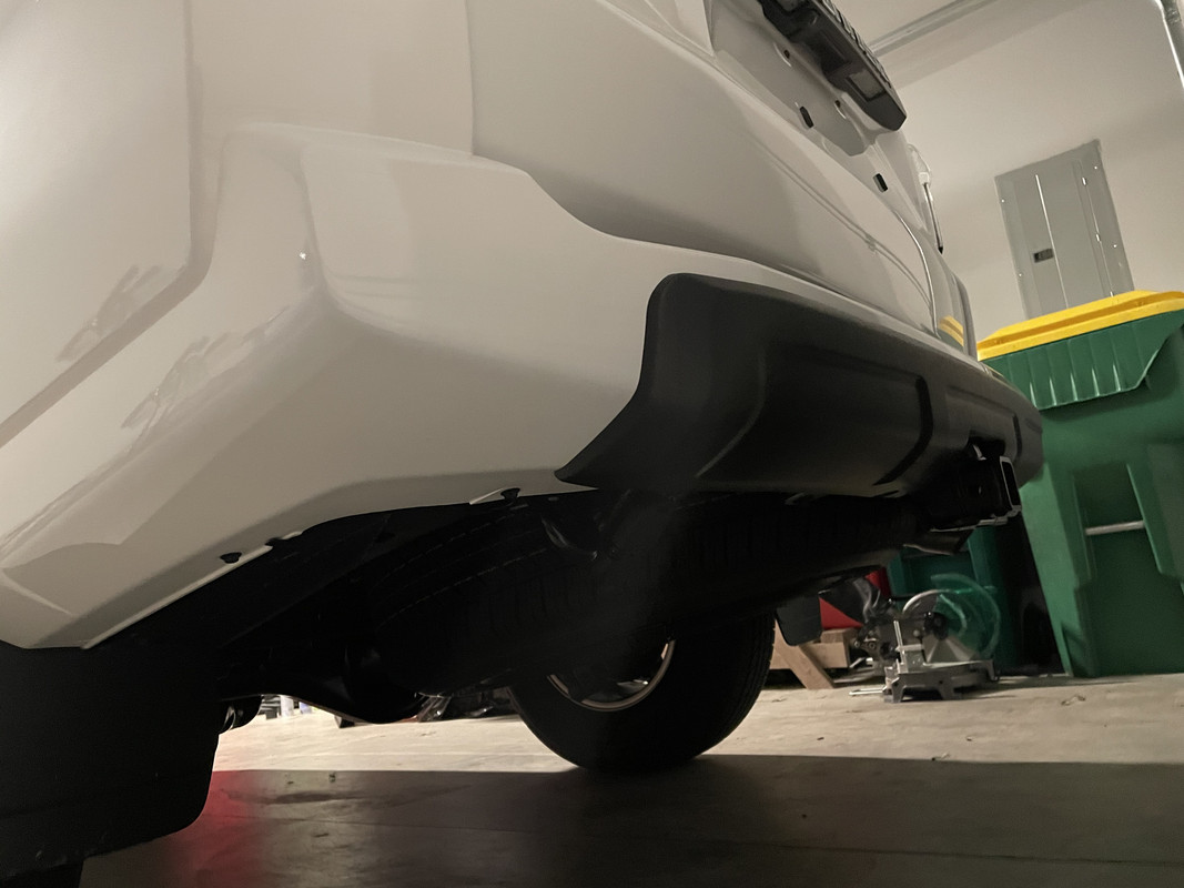

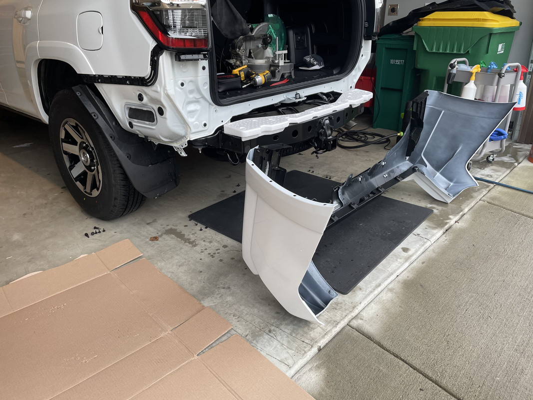

The first "official" mod was to pull the front and rear valences off for plastidipping. I know that it's not the most permanent solution, but my wife loves the blacked-out look so we're installing OEM Toyota black-out badges and I wanted to do the valences to match. We'll see how durable the plastidip ends up being, but the worst case scenario is just buying the Pro valences online and installing them later. I have to admit that removing the bumper from a ~48 hour old vehicle was crazy, but it came apart painlessly.
The front valence removal was much easier, although reinstalling the clips requires some contorting if you have big hands or long arms.

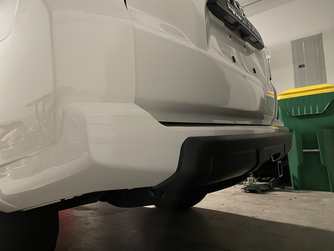

Spraying the valences outside.
Finished product. I'm not sure I love the texture of the plastidip, but it seems pretty durable and is 100% reversible if I end up hating it.

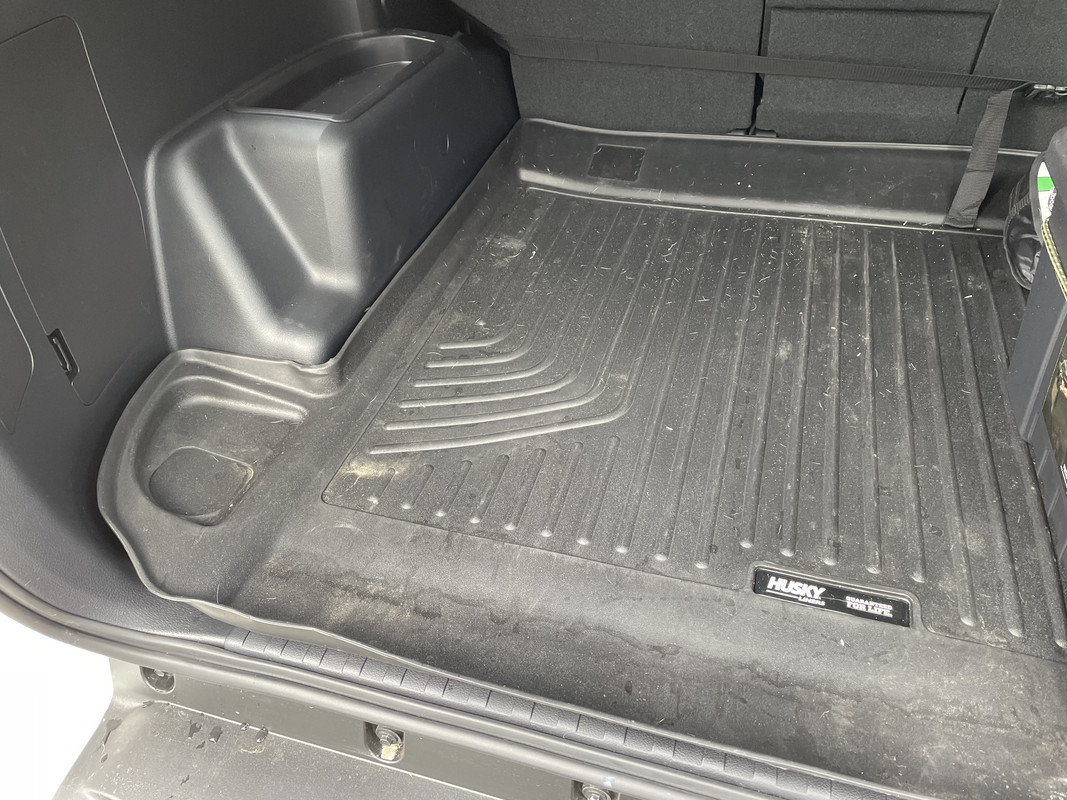

I've always been a WeatherTech guy, but the forums led me to look into Husky as a cheaper, slightly "softer" alternative. I still have WT mats in other cars, and while I prefer they way that they look, they are hard and can be a little slick when wet so I found a great price on the Husky mats via Amazon and was able to get front/rear/cargo mats for the same price as just the front/rear WT's. I also like the fact that the Husky front liners to over the door sill and that the cargo mat covers the entire rear area, including the two bump outs near the door.

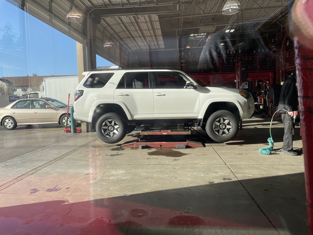

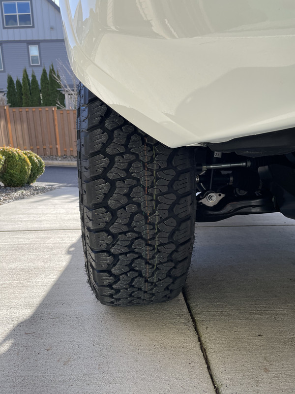

I set a new personal best for the least amount of time I've owned a car before swapping tires. The duelers only had 309 miles on them before they were removed in favor of 265/70/17 P-load General ATX courtesy of Discount Tire. I'm usually a Costco tire guy, but they screwed me on my last 2 orders and I've sworn them off. DT was fantastic to work with.
Cya, duelers:
Helloooooooo ATX:
Those Grabbers need some dirt on them.
They've only been on the truck for ~3 hours, I'll get 'em dirty this weekend!

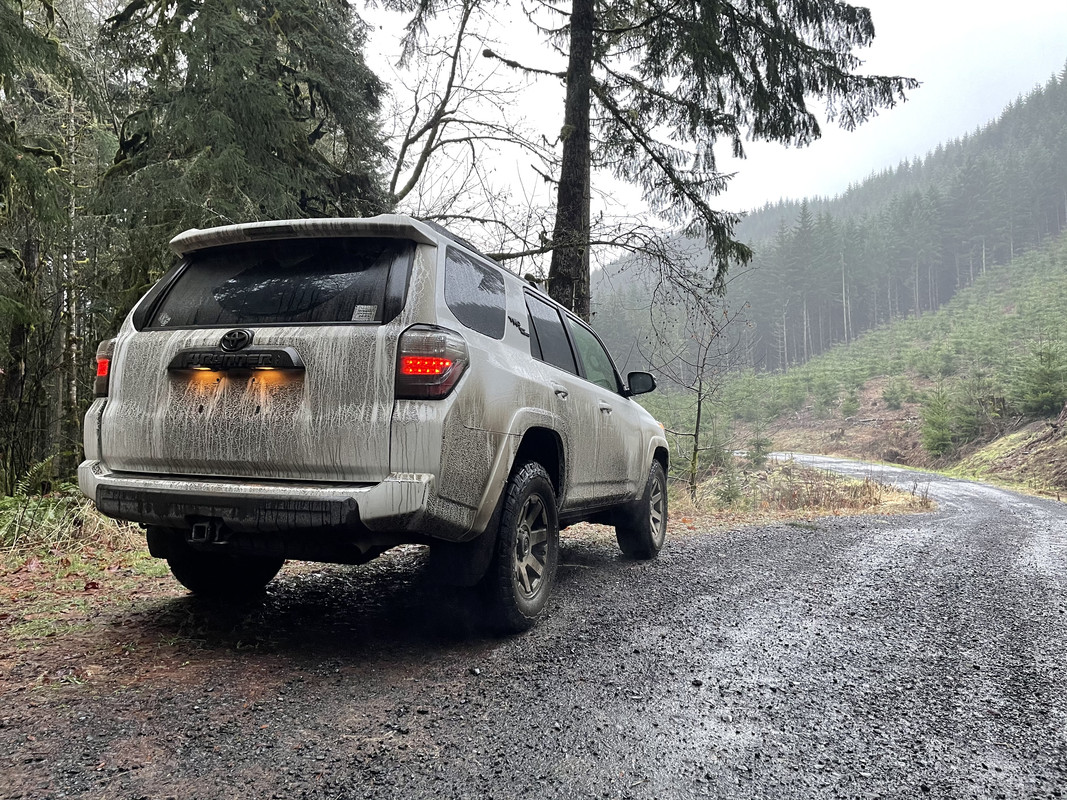

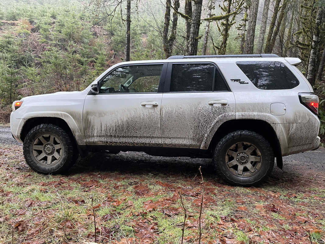

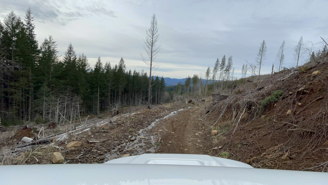

After that she had a week or two of daily driving duty and then we spent last Saturday exploring some of the logging roads near Oregon wine country. This was her first time she got particularly dirty, which felt pretty good.
Several hours of obsessing the next day and it was clean again:

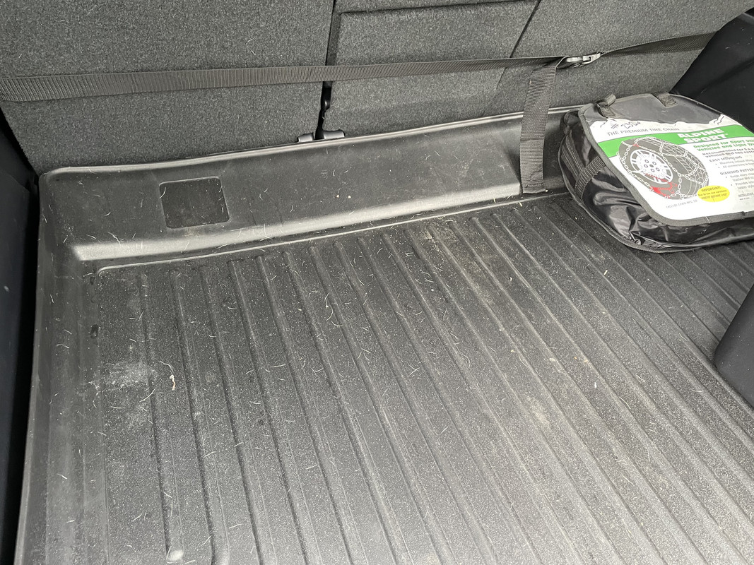

Any chance you could post a pic of the husky cargo liner in place? Wife wants the WT's but I would love a liner that actually covers the entire cargo area including the bump outs. Thanks.
I much prefer the design of this to the WT.

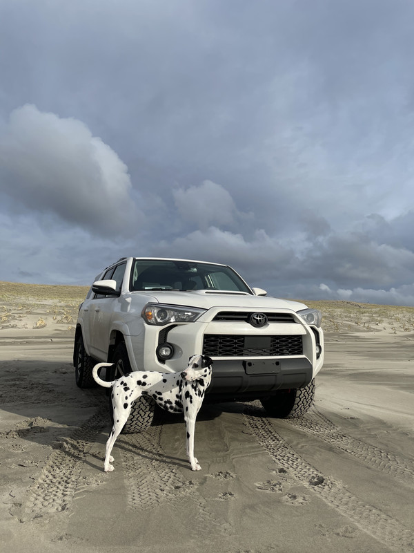

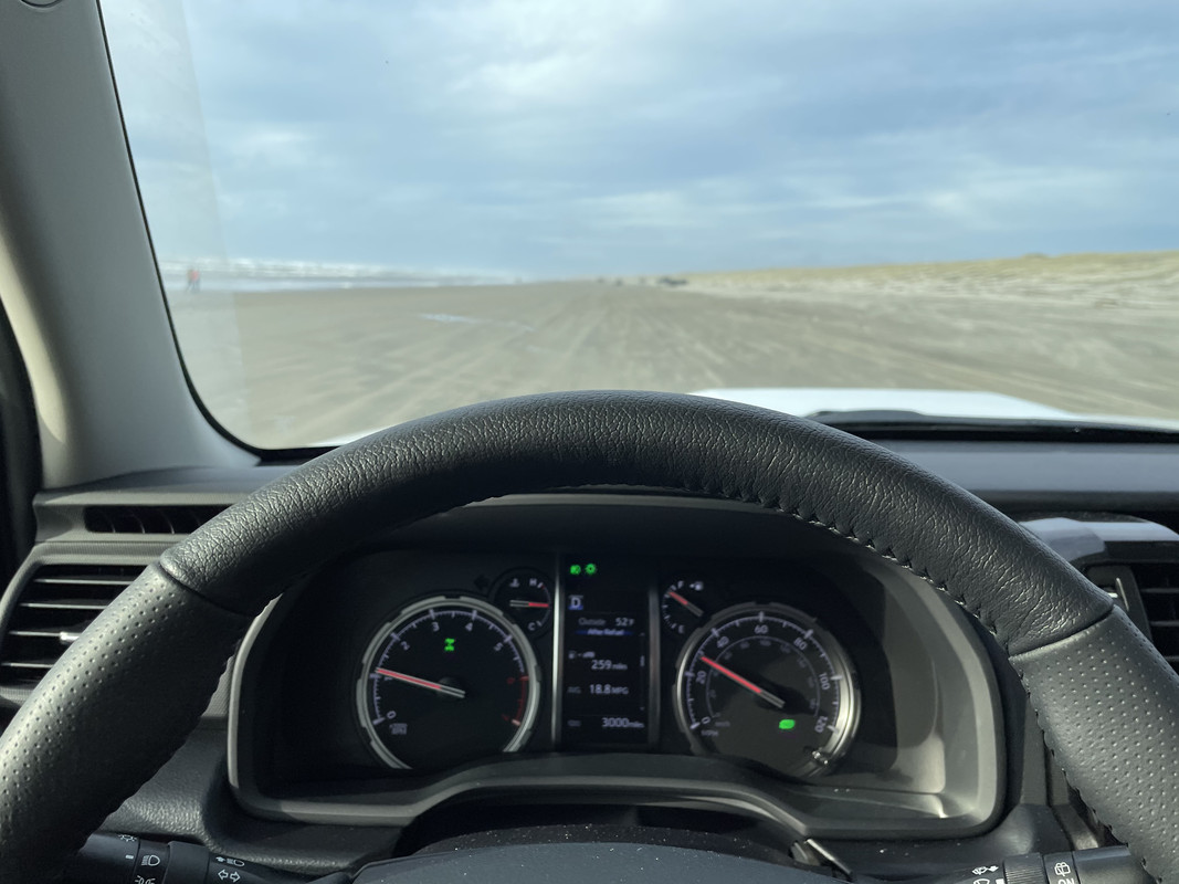

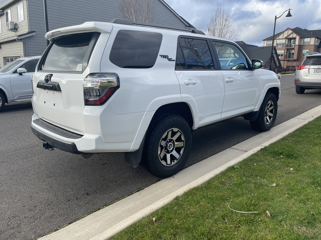

The after only 2 months of ownership the truck rolled over 3k miles this weekend while driving along the Oregon coast. We needed to get out of the house and I’ve always wanted to do this drive, so we spent the sunny-but-cold afternoon enjoying the salty air.
Spotted copilot
Peter Iredale wreck
Tried to find some forest roads to explore but every single gate was closed. Saw a few locals on the side of 101 when we headed home.

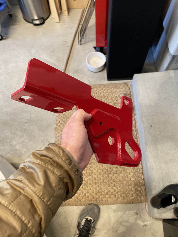

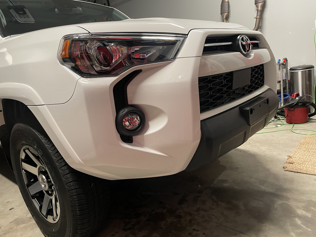

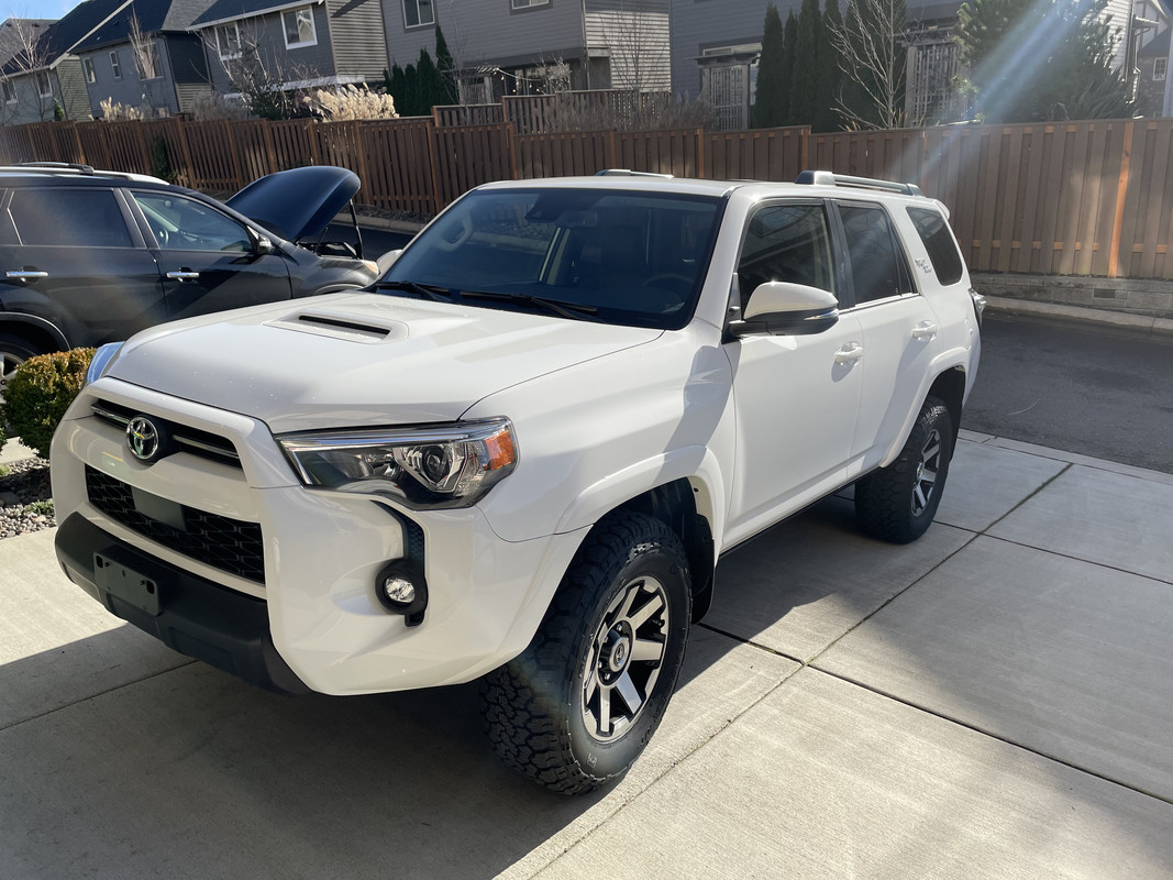

So I finally got around to installing my Apex Overland (aka LFD Offroad) front recovery points. While they could be removed with the stock skid plate still on, it's much easier if you remove it and the associated black trim so that you can drop the sway bar more easily. I had to cut and remove some black tape-like substance over the frame to access the large 19mm bolt hole, and the bolts that mount the sway bar back to the frame were an absolute sonofa***** to get threaded on the driver side, but overall the install was pretty easy. My torque wrench was on the fritz and I snapped the lock washer on the driver side, but Apex helped me source new hardware for it. I'm hoping to stave off a front bumper as long as possible, so these make me feel better about either getting stuck or helping someone else that is stuck.

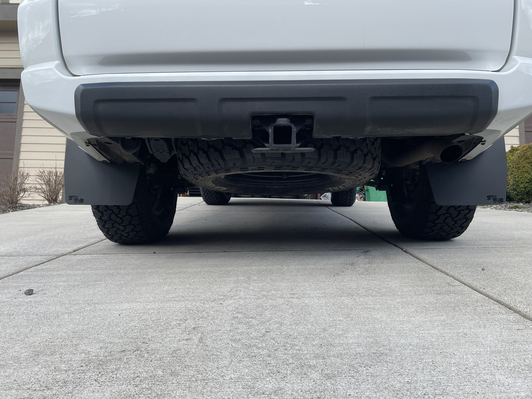

My other project over the weekend were Rokblokz mud flaps for all 4 corners of the truck. We spend a lot of time on gravel forest roads out here in Oregon, and my Grabber ATX's pick up and fling rocks like crazy. I already have a sizeable chip on my passenger rear door from a trip a couple of weeks ago which bummed me out. While I know larger mud flaps aren't the coolest thing in the world, I care too much about the paint and underside of the truck to let it get sandblasted constantly. These install easy and I think may even offer a little bit more clearance for when I upsize the tires due to the way that they notch near the frame on the front wheels. These are the normal size (not XL) and took about 10 minutes to install. So far I'm really, really happy with them, as they seem to have already put a serious dent (LOL) in how much gravel is kicked up by the tires.

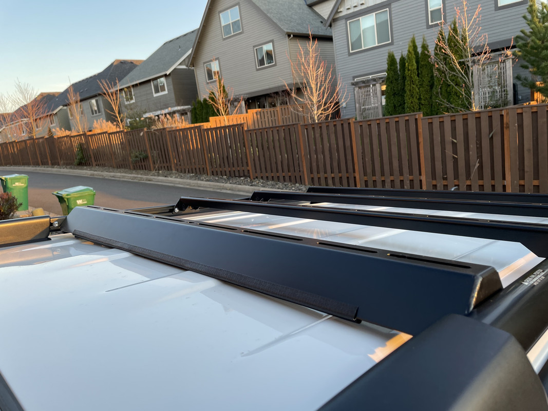

I finally got to install my LFD ruggedized crossbar set and so far I'm extremely pleased with them. No wind noise with the integrated front fairing, but our PNW rain has found a few holidays in the powder coating. Installation is very simple and I was able to do it myself with a small ladder in the garage. I'm a nutcase and measured the distance between the bars to equally space them, which snugging the T-nuts allowed for. If you want a more sturdy and versatile option to roof-mount things like ski racks and traction boards, look no further. I can't see why most people don't install these over something like a roof rack.
