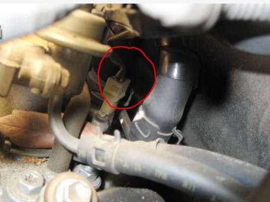

Edit - this is the location, right?
Yes, it sounds like you might have the same thing. It’s not a difficult part to change, you can do it in less than an hour. That said, it’s also not expensive to get an OEM one, they’re around $55 plus shipping (you’ll also need 5 crush washers). I just went with the OEM. Less than $100 to fix something two mechanics couldn’t (wouldn’t bother, really) figure out.
Thanks - does the pic I added in my previous post show the correct location? I found it on an older thread here...

Of you do change the coolant temp sensor - I can’t see the pic me mentioned - but it’s between the banks in the front behind the timing below cover. Yes, five crush washers, once for the sensor and four for the fuel rail banjo bolt you’ll need to remove for access.
