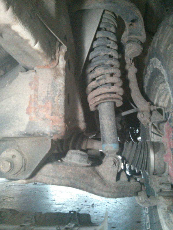

I bought a 98 4runner, 4x4 about 2 years ago. The guy that sold it to me told me that he had a 2.5-3" lift installed but I didn't think to ask any more information about it at the time. So now that the front suspension is shot and needs to be rebuilt I am left wondering exactly what I have installed, so I know what to put in when I rebuild it, or at least so I know what I have so I can upgrade. I snapped a few pics that should hopefully help you experienced folk out there to identify what’s what.
The front struts were labelled/stamped with:
Toyota
48510-35080
J.H.2
Tokico
Japan

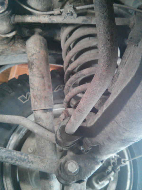

The rear struts were too badly rusted to get any info off them. It did look like there was some sort of sticker/label applied to it at one point...

that front number looks like an oem shock when googling.
maybe there is a spacer on top? If not, then I'd guess a body lift.

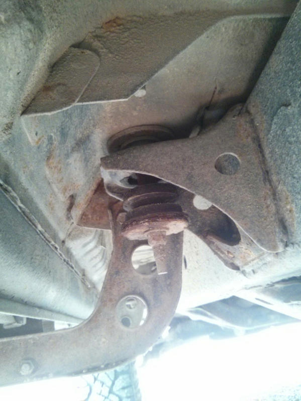

Hrm, I don't think its a body lift, check out the picture of my body mounts.

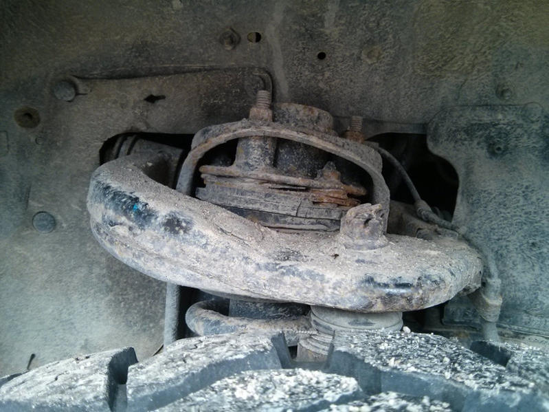

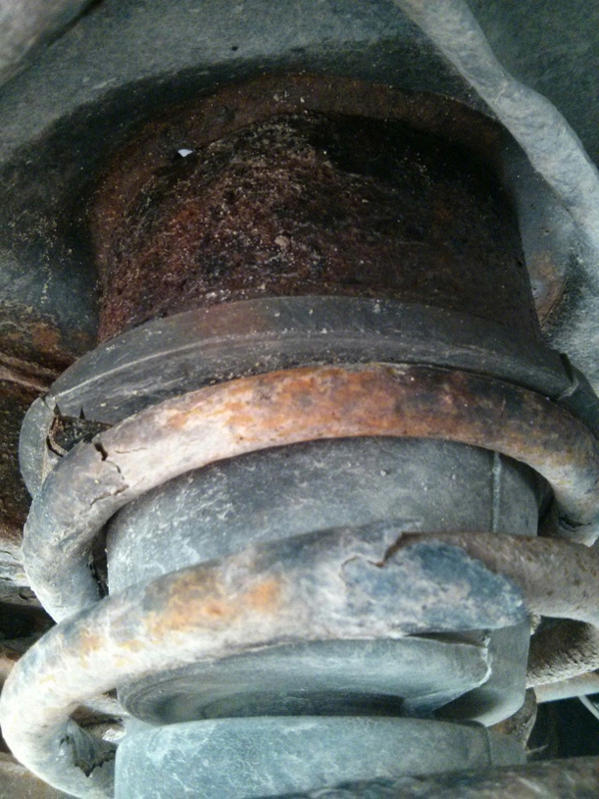

Maybe a top spacer. I took a picture of the top of the front and back suspension. Does this look like there are spacers installed?

Spacers front and rear. I'm not too keen on my spacer lifts but that rear one looks sketchy. I think it's supposed to fit over the coil, which would require removing the cone bumpstop.
On a side note, you might look into replacing your lower ball joints. Those look original and spacer lifts are especially hard on our disastrously-failing LBJs
ANYTHING you install from here-on will be an improvement. Now, just pick out what you want based upon your needs and your budget.
