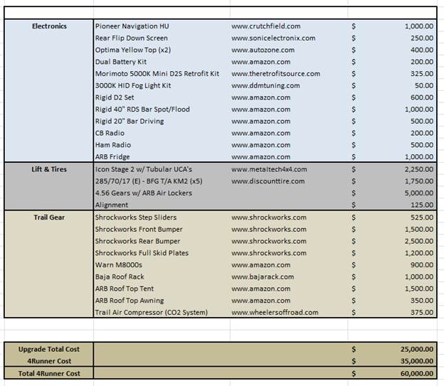

Here is what you need. This was my old build list...then I had kids and gave up on adventure travel. Because for the money (little more) I could get a 5th wheel toy hauler (shower, running water, generator, tv) and a diesel, put me a rubicon jeep in it and be happy. <--- still my retirement plan only 25 more years to go.
But in all seriousness if you need to ask a bunch of random people on the internet to tell you what you need to live/survive out in the wilderness for any given time while trying to travel in a vehicle you're not ready to undertake that just yet. Camping is different from overlanding. Overlanding more or less turns your truck into a miniature 4x4 RV.
I'd suggest a bunch more reading and a lot more vehicle based camping before attempting to build an overlanding rig.
