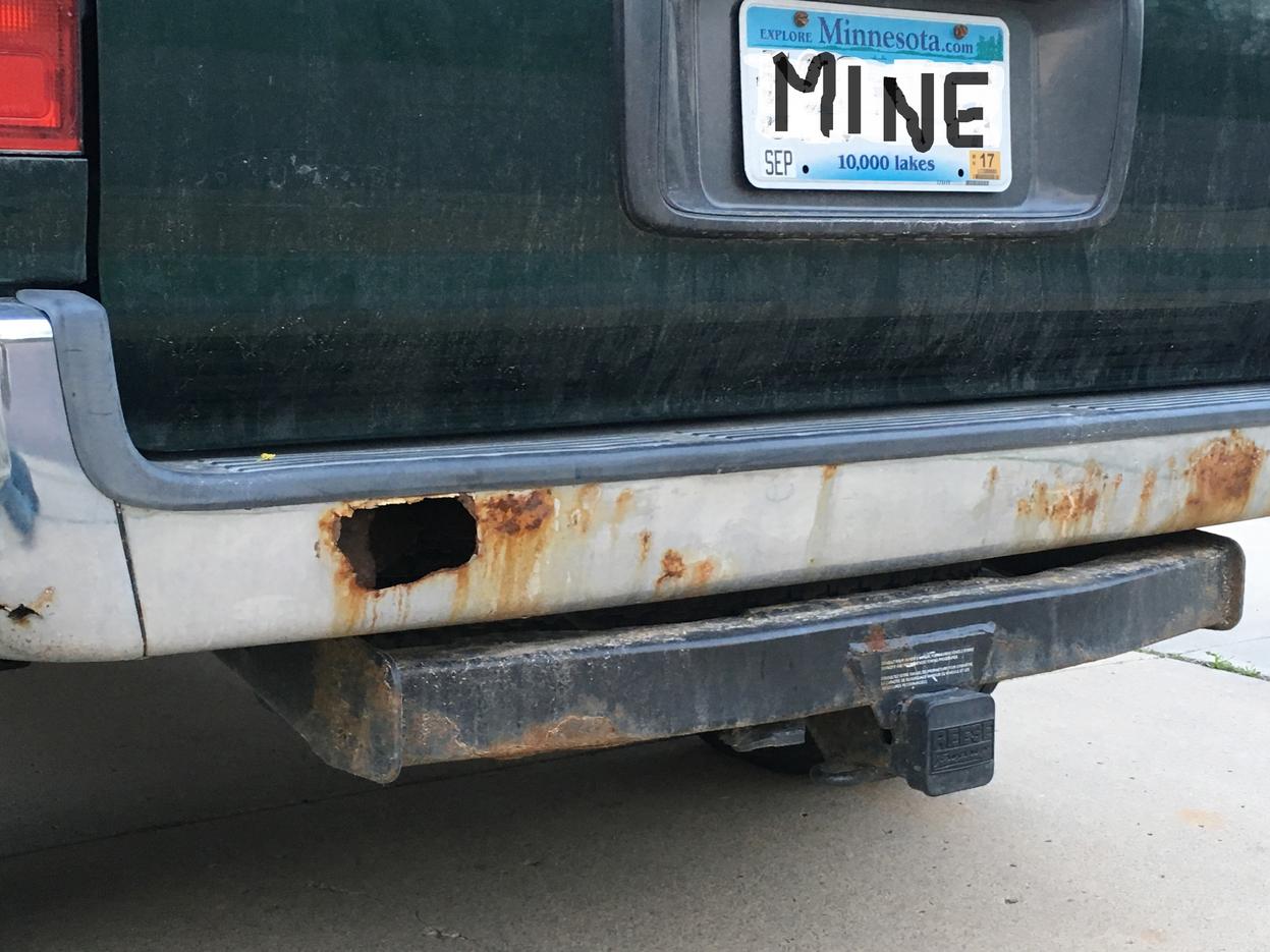

Rear bumper cover chrome has rusted hole and what not. best palce to find a replacement also are there any threads on here for procedure to fix? New to this forum, sorry for any redundancies...

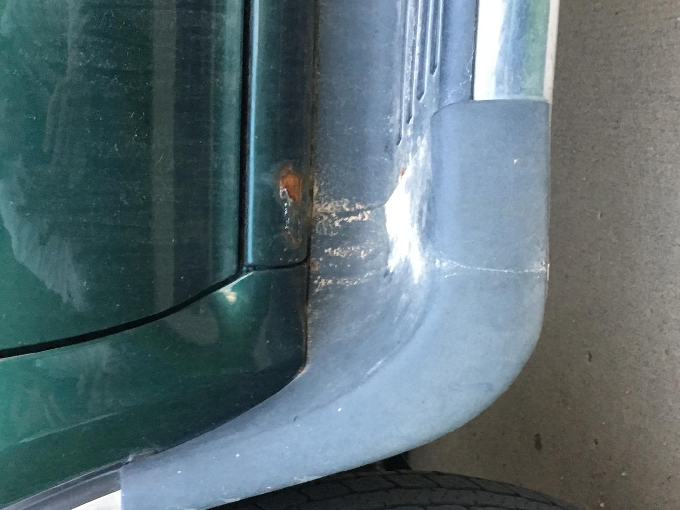

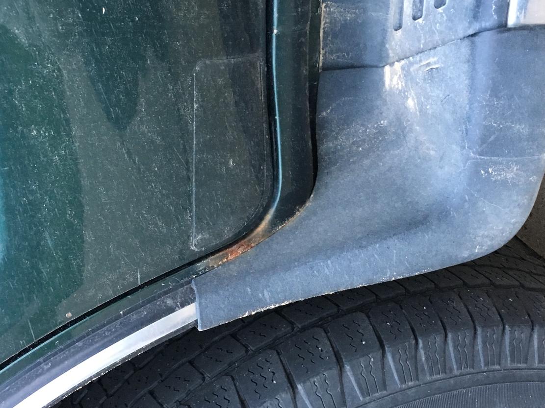

Couple of rust spots on body... we all love the T4R for great reasons and keeping this thing clean of any more rust is something I am willing to do.... as much as I can.. how does a guy go with keeping that in control?
