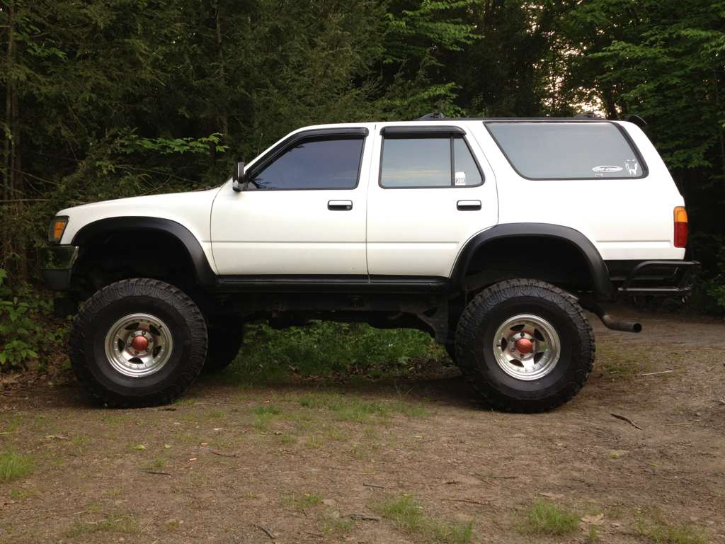

I am sick of getting hassled by the local PD. I currently have flares from bushwacker, but the are only +1.5". With my 35x12.5 I still need about 2-3 more inches of flare. So does anybody know where I can find 4-5 inch fender flares for a 93?
I have a 2nd Gen as well, and couldn't find anything ready-made bigger than those Extend-a-fenders, either. I've seen the pocket style flares made to fit, as OU4x4 mentioned above, but wouldn't know which ones to suggest to start with. There is also the molded rubber flare material that you cut to length and fit inside your current flares--won't look as good as a single custom piece, but if it gets the cops off your back, it might be worth it. Places like Low Range Offroad carry those. By the way, that's a darn good-looking rig!

Seriously though, have you tried to just add mudflaps to the back. Get some big rig ones and make some mounts. Most cops are going to hassle you for the rear as it flings everything up and out. As long as from the rear you have the tire behind a flap, that may be all you need to do. Look at all the jeeps out there.
I just saw that Bushwaker makes a cutout for the 89-95 pickups. offers 3" coverage. That would be your best bet. Pick up a set and work with them to make them work for you.
Bushwacker - Fender Results
If you have 4" tire showing past the fender, you will probably be fine with a 3" flair. Most cops won't mess with you over an inch.
