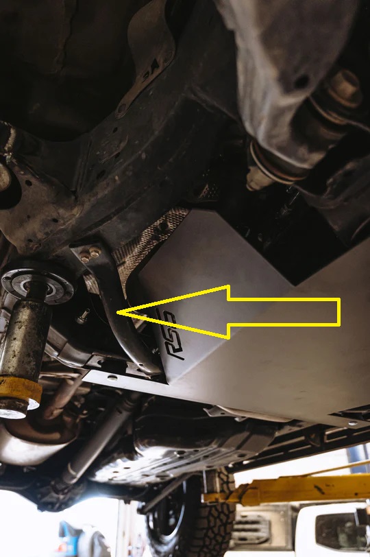

Ok, I just installed a RSG Cat Guard and it didn't seem like it provided the coverage it should. I contacted them and heard back almost immediately--they sent the attached picture. That bar the arrow is pointing to---there is one on each side going from the frame to the transmission crossmember. Those bars are important in the functioning of the cat Guard.
MY TRUCK DOESN'T HAVE THEM!
Would anybody be able to point me to a part number for these?
OR
Look under your truck and see if YOU have them? Are they OEM?
Mine is a 2011 SR5 4WD.
Thanks in advance!

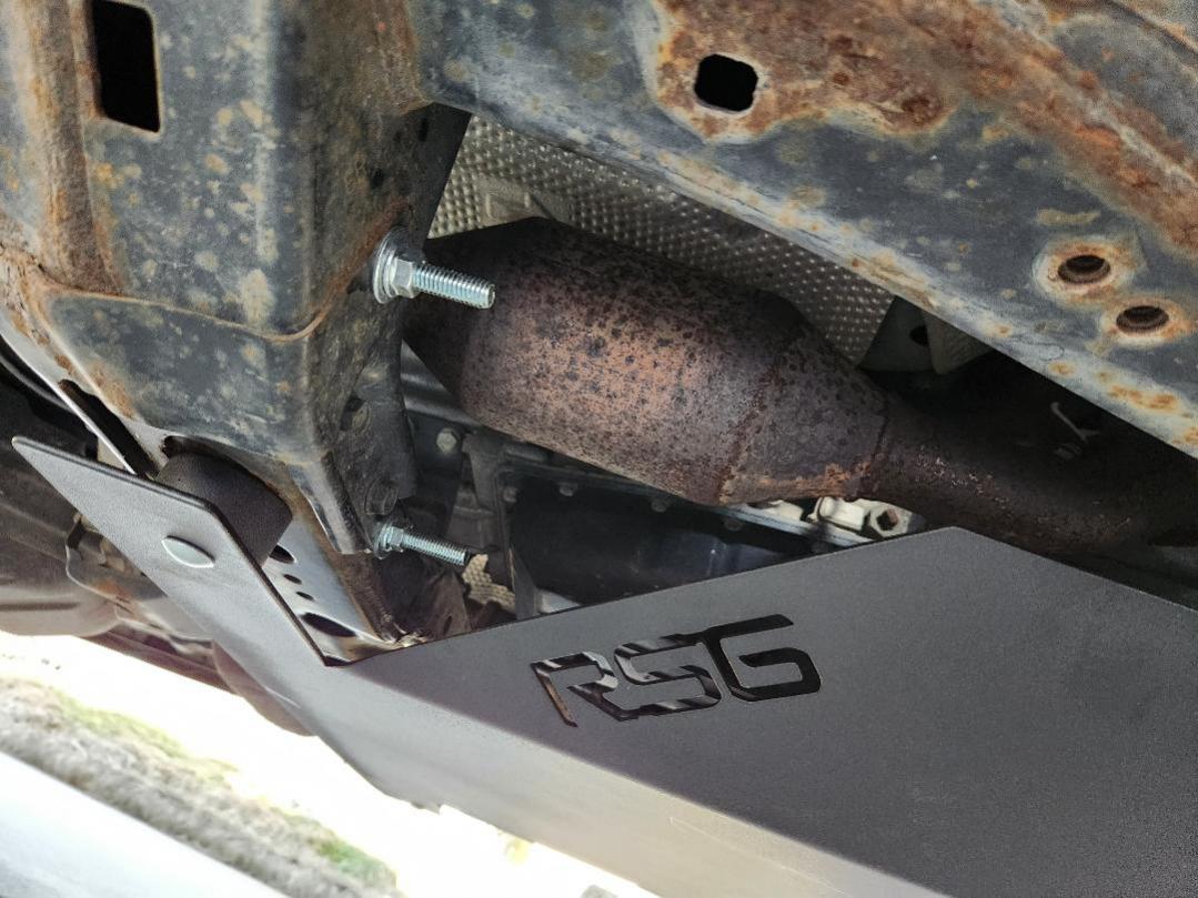

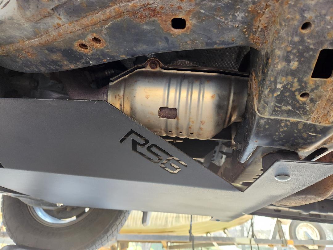

Here are pics of my truck with the missing bars. You can see the two attachment holes on the frame and the two holes on the crossmember. Unused, in my case.

Those bars are OEM frame stiffeners, and IIRC only came on Trail and Limited models.
51225-35040 Right
51226-35060 Left
