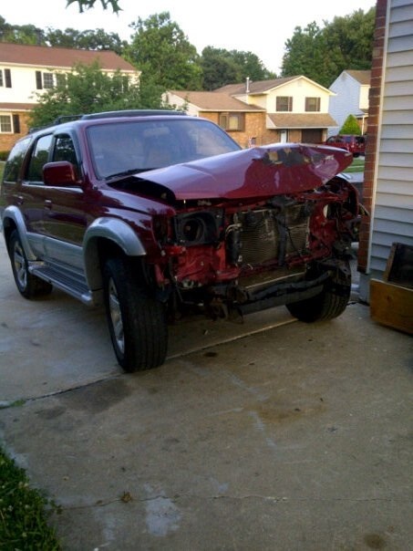

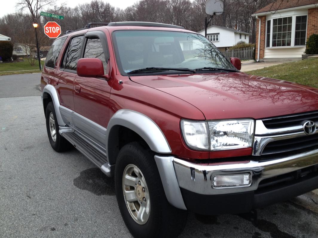

So I rebuilt tho truck From ground up car runs amazing only one problem is that keeps draining the battery I put 2 new battery's in it already its been almost 2 months And it starts to crank slowly any advice I know if it was the alternator it would show the light I've been threw 3 of these trucks love em strong trucks

I had the same issue with my 2000 T4R 4WD LTD. I ran into two issues. First, the daytime running light (DRL) module (located to the right of the battery and in the fender cavity) seemed to malfunction and drain my battery. I disconnected it (Don't like the DRL feature anyways) and the problem was solved. The 2nd time it happened, I had installed some interior LED lights. One of the light panels I installed had loosened up and drained the battery. I adjusted it and solved the problem. Not sure if this helps but they did work for my rig. NICE LOOKING REBUILD MAN!!
