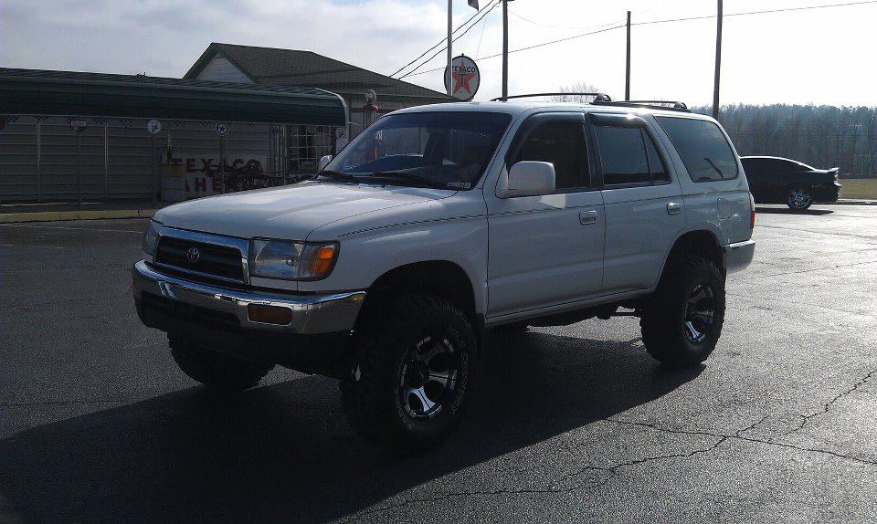

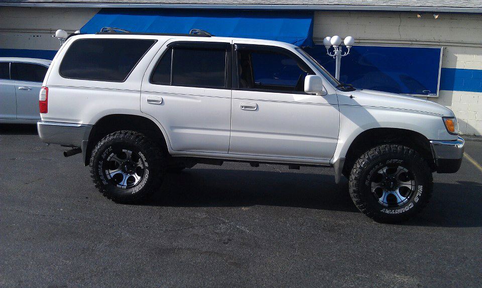

Just got started on building my T4R looking for advice on what to do. It's a 98 2wd SR5 would like to do a little off-roading and want to know what she's capable of.Here are some pics of the new wheels and tires looking at possibly adding a bull bar and a set of PIAA's what do you think?

X2 budget is everything, number 1 thing I can give for advise is read build threads. A locker in the rear would help for sand and stuff a bull bar or custom front bumper with winch would probably be nice to have. All depends on how you want it to be.
My budget is around 3k I'm currently deployed so i have a few months to do things as well. I have heard about doing the locker but I have no experience in that area. Also for exterior mods feel free to post pics of examples.
if you have a $3,000 budget, i would suggest selling the 2wd to someone and taking that money and buying a nice limited that already has a locker.
I have thought about that but around where I live there aren't to many in good shape for a decent price.Also I don't plan on doing any real extreme mudding.
you may regret dumping that much money into a 2wd, just saying.
your in the military man, get a loan, sell that thing and put your other 3K with it, build something you really want.
when i was in the military i spent money on cars like crazy, you always know what you are getting paid so its easy to budget.
Looks great. But sell her and get a 4wd. Expand your search and do some driving you'll probably find a keeper. You don't even need to be "off-roading" to get stuck in 2wd.
