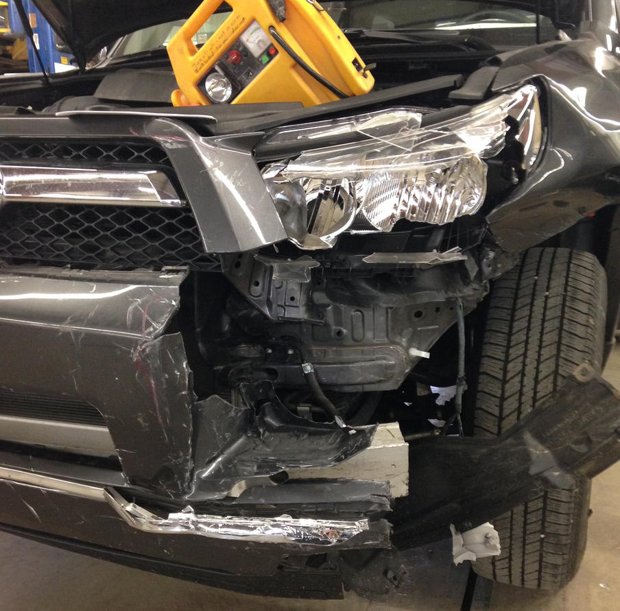

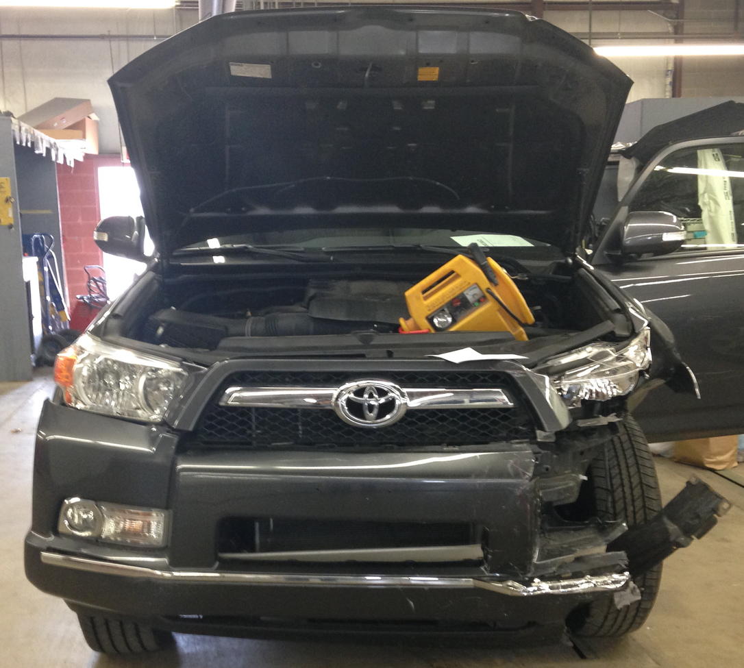

Hi all, new to the thread...recently purchased 2013 gray T4R....after I rolled an '03 in January :ohwell:

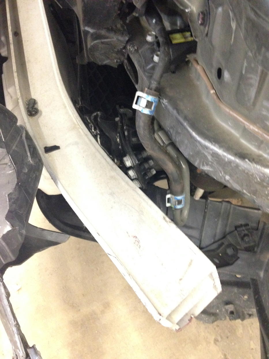

'13 was in an accident on Monday, Toyota on Toyota violence, Camry ran a light. My insurance is saying my T4R will likely be repaired, since it's still so new. I have major concerns given the collision center's initial comments regarding major suspension work, although they said they don't think the frame is bent. They haven't torn it apart yet. Advice welcome!
Should I take it to a dealer for an appraisal?
Should I try to get insurance to total it due to suspension damage?
If the frame is bent, how does that change things if the insurance wants to repair?

If the frame is bent I am pretty sure legally they have to total it. I'm sure others will chime in, but if you aren't comfortable with the extent of how bad the damage is and you think it could, even after repair, be unsafe then I would try and find out how you can try and get it totaled. Of course your insurance co will do what's most cost effective, but I'd read around and figure out what options you have.
It has been said many times that when a car has significant damage, it is never the same.
It goes from state to state but in Oregon if the frame is bent and it doesn't cost more than it's worth it's not totaled and with that damage just have them fix the damn thing right. Make sure the suspension is oem and is oem specs
Mine has been totaled 3 times (only once from me) :becky:
"Totalling" is a fairly simple process of what percentage the repairs are of the vehicle's value. A 4R's high value retention works against you in this scenario.
Frames can be straightened.
Didn't the airbags deploy? This would significantly add to the repair cost. It's also some indication as to the severity of the impact.
Odd, the Camry looks like it hit a flat surface...

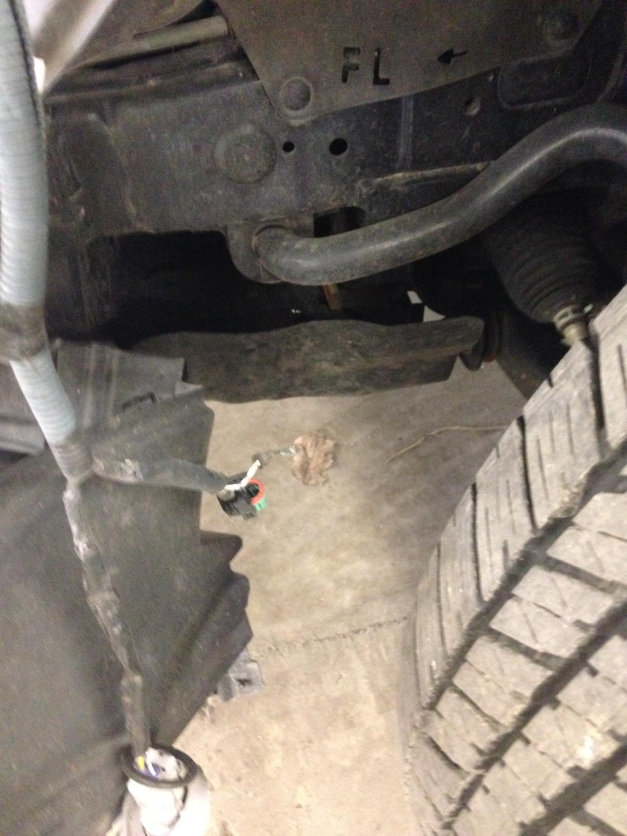

After an initial 5 weeks and $13k in repairs, my poor 4runner has been back in that damn shop 4 more times. There's a clunking in the front end that they can't figure out, they repair something every time, say it's fixed, and give it back. My last hope was for them to escalate to the dealership, which they did. Dealer had it for 2 days, the tech sounded really excited that they had found it when the collision center did it.
Picked up the vehicle after hours, drove it away, and sure enough the clunking/knocking is still happening.
Does anyone have any advice? I can't get rid of it, the diminished value is $10k less than what I owe on it, thanks to the airbag deployment. Insurance is playing the "we have to give the collision center every opportunity to get it right" game, but of course they're not footing the bill anymore because collision center guaranteed their repairs.

The sway-bar is hollow and is made to twist. It does however bend pretty easily. Try pull the sway bar off and see if the noise goes away. If it does its a bent sway bar and it it tapping something as it travels through it's normal range of motion.
Just a hunch, but I thought it was worth a mention.
I have fought noises like this before after a repair and I can tell you I have always found it by luck, and it has never been what I was looking for.
Other things to consider.
-Fender liner loose and tapping (can sound very loud in the vehicle)
-Bumper splash guard (plastic) flapping in the wind
