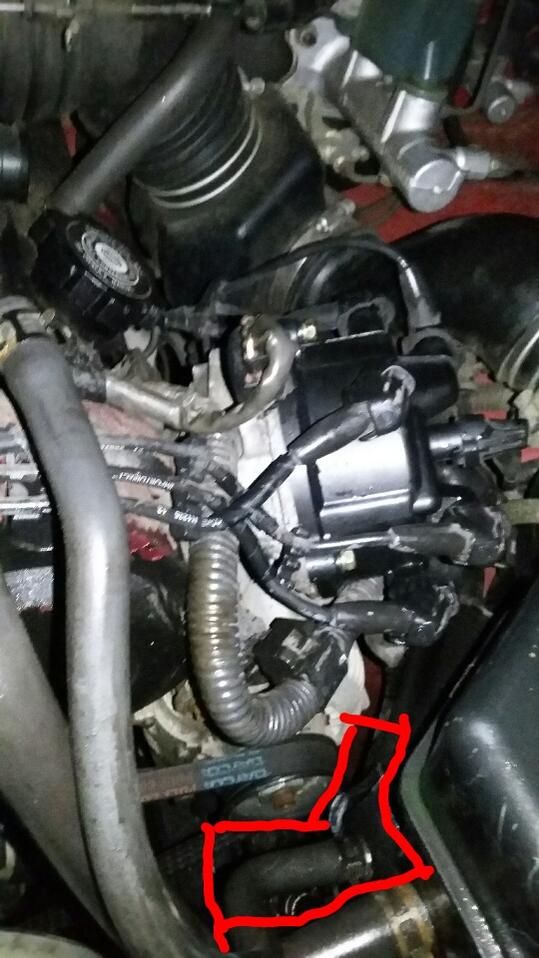

No, havent put new gas in going to this weekend. Yeah there is a crack in little black box in front of alternator but i plugged it off. Same results.
