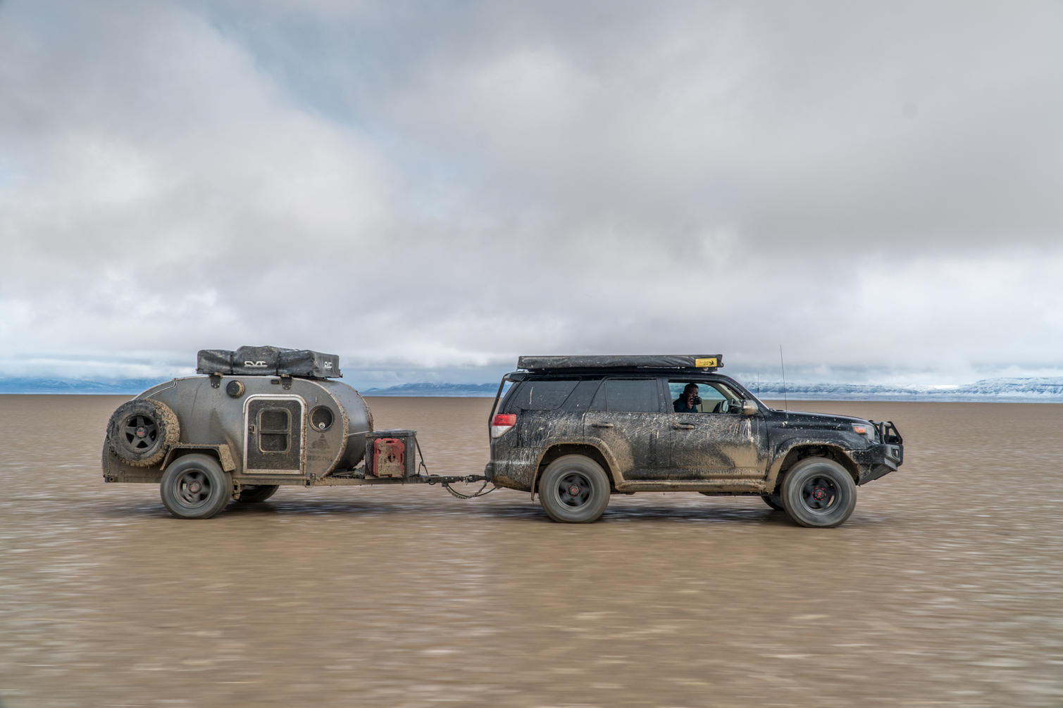

After camping with our Smittybilt Scout trailer 7 or 8 times now, I have come to terms with the fact that I need to beef up my rear suspension for better ease of use. I currently have the set-up below (2.5 inch) with an SSO front insert and winch for the only extra body weight on the truck. It still has close to factory ride quality and looks great. I would like to keep similar ride heights, but not have so much sag in back when the trailer is loaded, kayaks are on the roof, and rear of truck is loaded (family of four with both kids under 5, they come with lots of stuff).
I did add the lock-n-roll hitch with 4" lift that help level things out some, but not much.
3" lift / leveling kit for FJ & 4Runner
Should I just add some heavier springs in the back?
New kit all around and have flexibility for the future?
Ride quality is my only concern about going heavier, but may be unavoidable.
If you can - I'd start by moving the canoes to the trailer. No reason to carry the weight on the 4runner if you don't need to.
After that - I would put longer springs on rather than spacers. Spacers are going to end up with a harsh ride as soon as you load it up. The reason is that you'll be riding on the internal bump stops the whole time.
Another alternative is air springs. I'm not a big fan of the ride quality when empty with air springs. They tend to make the rear end very firm after just a little travel - kinda like having soft bump stops that you hit right away. But there's no question that they do a great job when loaded up. If you're doing a lot of towing miles - I'd go for air helper springs.

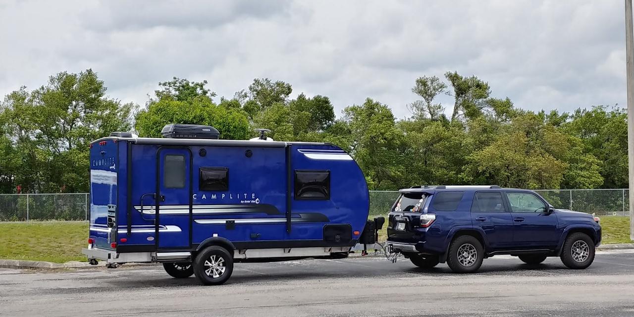

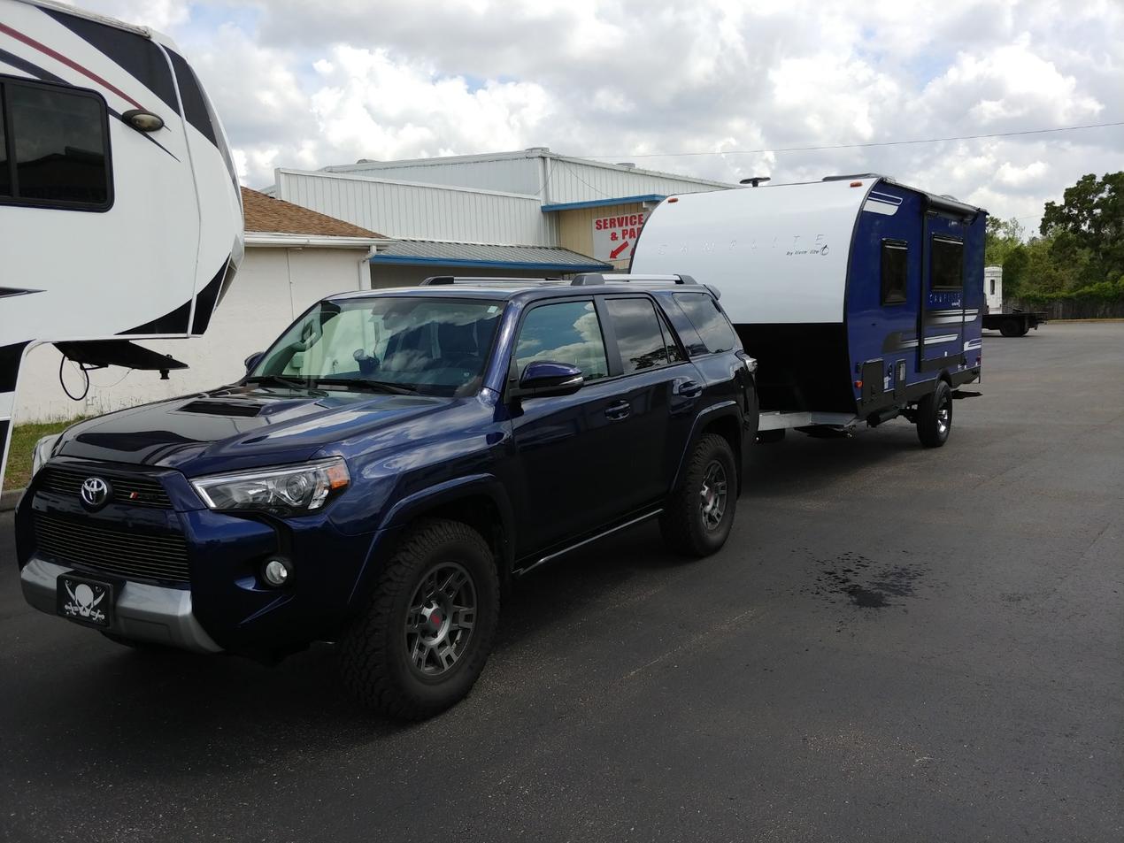

In preparation for towing a 16' travel trailer, I installed Bilstein 5100 front shocks and 5160 rear shocks, and a set of Firestone air bags in the rear. My trailer weighs 3210 dry and 4400 GVWR, with a 420 lb tongue weight. I towed it for a 5 hour drive home from the dealership, and it tows just fine.

Trailer tongue weight
Your trailer looks like it is too heavy on the tongue. The tongue weight should be ~10% of the total trailer weight. The trailer axle looks like it is too far back, distributing more of the weight forward to the tongue. Try weighing the tongue on a basic scale and find or measure the weight of the whole trailer.
I think that's a small trailer. With heavier rear springs you should be able to compensate for the trailer weight. If it lifts the rear you may need longer shocks to go with the springs. Air bags are an option too.
