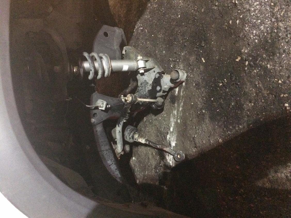

Long story short my son's 99 4runner suffered a suspension breakage last night. Thank God nobody was hurt but the entire passenger side suspension between the control arms broke off the truck.

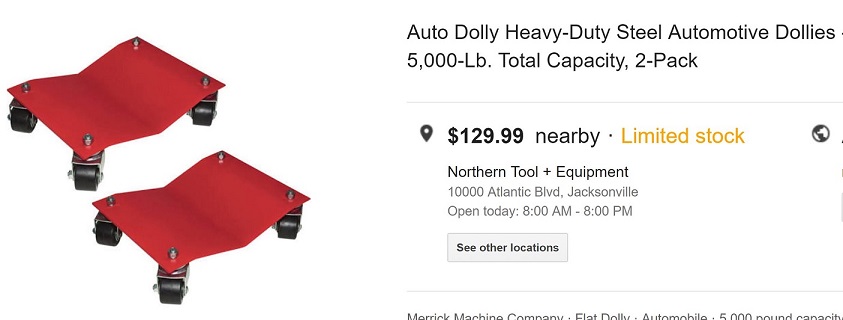

would something like this work? I figured if i laid the lower control arm on the "car mover" i could ease it up on the dolly and strap it down. What do you you all think?
https://www.google.com/shopping/pro...ved=0ahUKEwjtgPqU2s3WAhVIPCYKHc2lDfoQ8wIILTAA

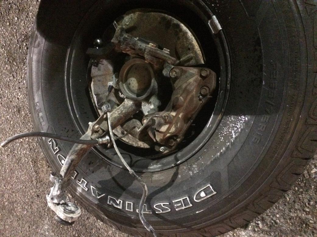

Im not sure what broke first. I suspect LBJ but will probably never know. My son had to "go look" for the tire and the knuckle is still attached to the tire but the tire and knuckle were totally riped off the car.

You cannot drive down the streets / highway with those "car mover things" (as you describe and linked) touching the pavement . Unsafe and illegal on the road. I think they are only for moving a vehicle around a parking lot. You could use them to help get the truck on a lift, maybe. Pics would help us a lot here.
BTW, did it break on a US roadway? Not off-road. If so then your full coverage insurance should cover everything.
PIIIIIICCCCCCCCSSSSSSSSSSSSSSSSSS please!

I hate to say it but your going to need a flat bed wrecker or a steel bed car trailer with a winch. Even with those "car mover things", without the steering knuckle and a Wheel the front end is going to sit on the ground. And you will still have/want to drop the drive shaft.
I think the OP meant he was going to put that under the passenger front then use that to load it onto the dolly. Can you post a picture? If the lower control arm is still attached you can load it on the dolly, strap to the frame, and pull the drive shaft
^^This will be a tough chore. You are going to have a Hell of a time getting those little dolly wheels up the ramps of any kind of tow dolly or car hauler. The insurance idea is great most polices have towing.

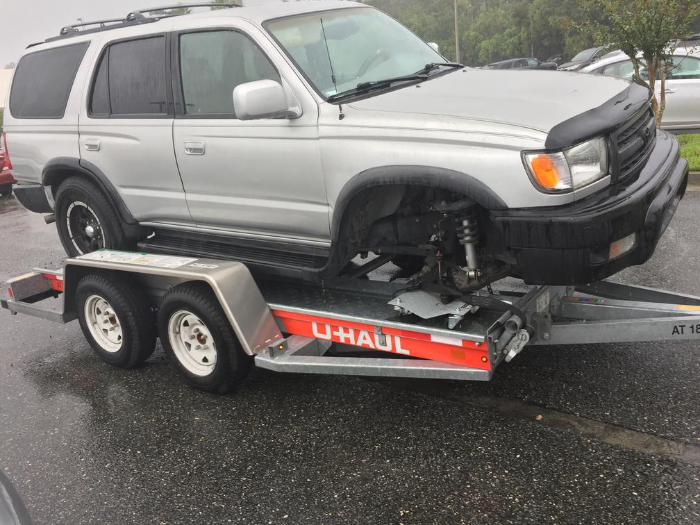

Here it is after I got it loaded up and before I strapped it in....Wasnt easy but so little is

Did you drive it up?
I did. Once we jacked it up and placed the dolly under the LCA I was able to back up and get aligned then drive to the start of the ramp. Then we jacked it up again and put the forward wheels of the dolly on the ramp and lowered the car again. I was able to drive up to where the ramp meets the trailer and we basically did the same thing. Then once more once toward the front of the trailer as there was a "bar" that the tire had to get over. Sounds easy but it took 1.5-2 hours to do lol. And of course it was pouring down rain!
