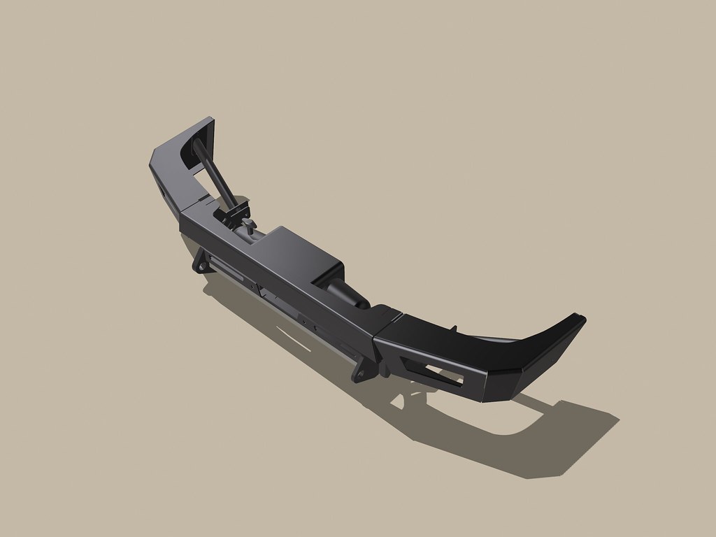

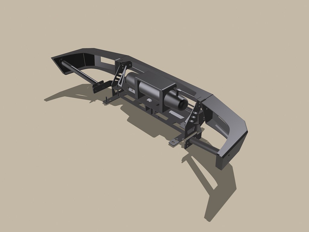

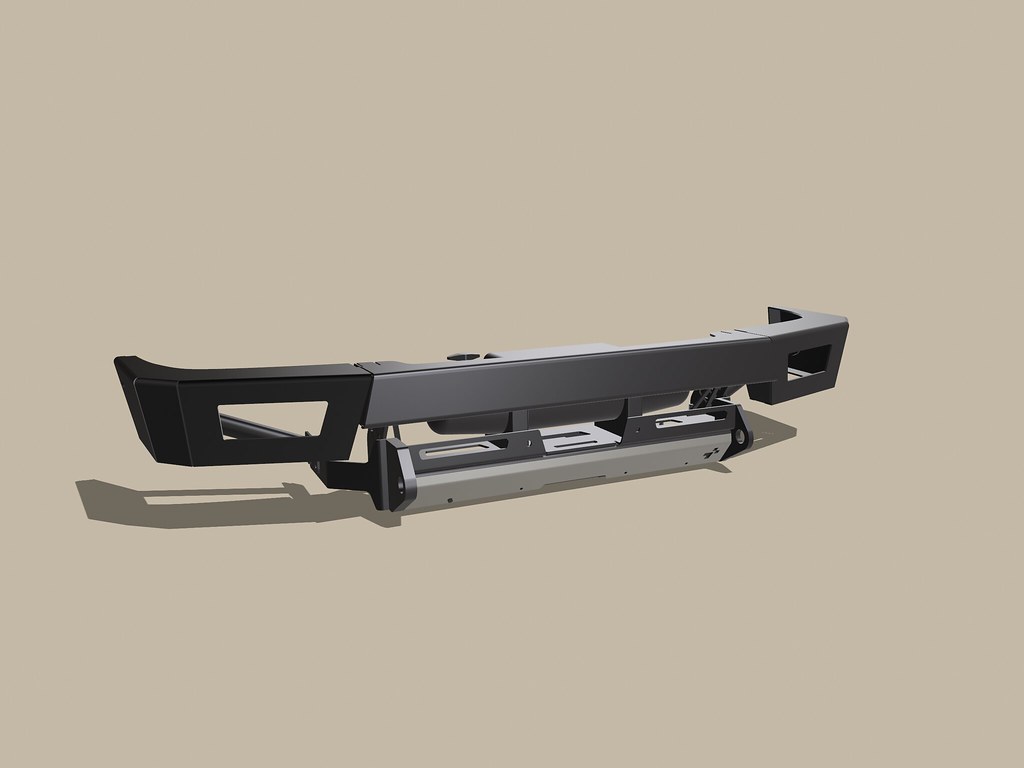

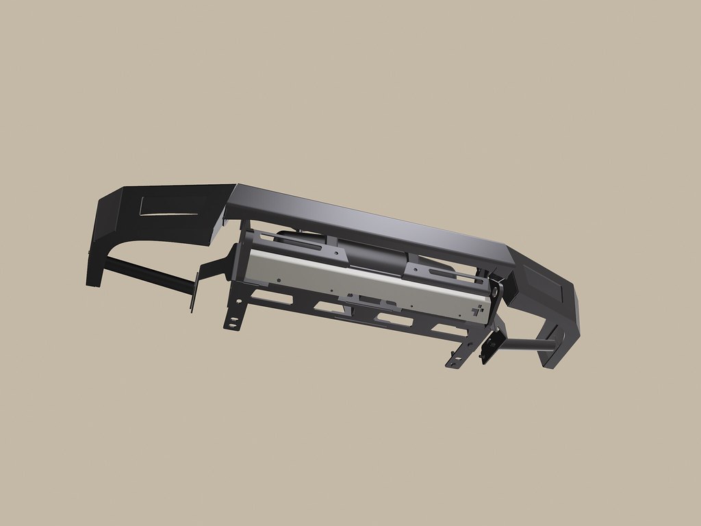

Hey everyone!
First of all, I want to appologize once again for the lack of updates and me not meeting my deliverables. I am learning more and more that if I am not committed 100% to stuff the sacrifice is that it just takes WAY more time than I want. (I own and manage another company - a hybrid creative and production agency)
With that being said - IT IS NOT DEAD. If anything it's getting better and better. I am a very detail oriented person and I hope that my self inflicted delays on this project and excessive revisions do create a product that stands out from everything else on the market. Our engineer (James Leath from Leath Design) has been a legend in this regard. His perspective on the project has been invaluable. I've said it before but will do so again - we are creating a product that isn't for everyone, and we are making some design decisions that may eliminate some of the market. An ethos that we think will pay as we expand the product line and continue slowly (but surely) building this out.
Bumper Update:
- Am considering deleting the lower-bumper with factory upper bumper option. 90% of our initial feedback has people wanting the full bumper. In reality we could make a small variant to be suitable for running our lower bumper with a factory 96-98 upper bumper but from an initial inventory perspective, this complicates things. I would like to encourage people to give feedback on if the lower bumper (on its own) has some merits. Let the people speak! lol
- The upper bumper and it's mounting point has changed drastically from a structural perspective. We want the upper bumper to be structural but modular and easily removable to access the winch for service. The design has the upper bumper being 3x components (LH, RH and Center) so it will also ship with ease.
- We have cleaned up a lot of aesthetic imperfections, IMO taking the design from "done" to "polished". It has been quite difficult to retain as many bent edges as possible to help ease assembly for the user and to keep the smooth and "pro" aesthetic that this creates.
- I have an order in for our first full steel bumper (upper and lower bumper) cut with all the new design changes. This is in the hands of the manufacture at this point. I do expect that I may run into a couple small things on the upper bumper portion but the lower should be production ready. I'm expecting this to land in my hands next week if all goes well with the supplier. Fingers crossed.
- I need to source hardware. Normal bolts and nuts are easy but I want to provide the nice flush anodized allen head bolts for the components that need to look good. Again, not any other bumpers on the market for the 3rd gen will go to this level of detail.
- I will likely still offer a full steel WIY option with a second option to be steel lower section with assembled and fabricated aluminum upper section. I think this would be the ideal strength/weight combination but will come at a higher cost.
Will ad some updated renders shortly.... Thanks again everyone for your patience.
