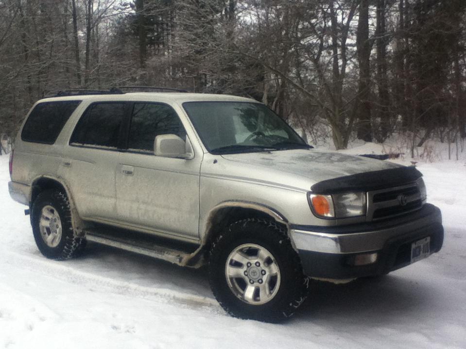

Hey Folks,
I'm new to this 4Runner gig.
I decided I needed a truck that can pull a payload when needed. I have always wanted to own a Toyota, and I need to have seating for my 3 kids. So that means 4Runner! To top it off, life is too short to be wasted driving an automatic. So that means 3rd gen is the newest one I could buy due to my personal snobbery.
I found this unit a couple hours from home last weekend. I live in Southern Ontario, where they dump enough salt on the roads to eat through an average car in minutes. It has a few spots of rust, but if I look after it I should be able to squeak 5 more years out of it, which is a shame because I'm sure the drivetrain has another 15 years of service to give!
2000 SR5 4Runner
4x4 5speed
223000km = 139000mi
I paid 3500 Canadian (3100 USD) and will have close to 4K CAD into it once I've done some repairs and maintenance. I'm not sure whether it is a great deal or not, but it is definitely worth that to me as it is a hard-to-find vehicle in good shape for this part of the world.
The only thing I wish it had is the diff lock. I won't ever need it, but I just want to HAVE it.

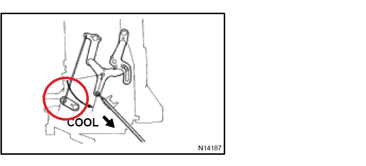

It failed safety due to not having any heat. If I move the heat selector dial, I can feel it bind. The water valve under the hood is free, so that leaves the blend door under the dash. I disconnected the cable at the blend door and the cable moves freely but the blend door does not.
The blend door is a confusing array of levers and voodoo clockwork. I wiggled the crap out of it and broke something. This something was a connection to a lever for some baffle or another that moved freely, but wasn't being moved because something is binding that it was connected to. Anyways, I wired this baffle open and now heat comes out. Not a lot but hopefully enough to pass safety. I'm not sure whether this paragraph makes any sense.
So I've got some heat. Will have the mechanic look at it next week and hope it passes safety. In the summer (did I mention it was -30C / -22F with the wind chill?) I will have to pull the dash and see whether I can get the blend door working properly. Now, for the emissions test:

If possible can you post a picture of what one broke and which one you wired in place? I've been having similar issues with my heat and I'm curious if it was the same issue.
The mechanic said that no heat equals no windshield defog, which is a safety hazard issue because you can't see where you're going. I can see where he's coming from, but if you drive with the windows down it is hard to get it to fog up. Either way, I wanted heat because my 3 kids didn't appreciate driving with the windows down when it is -30 out. I'm not going to pull the dash, though, until it is warm out as I don't have a heated shop.
I found a drawing from the FSM. I will attach it here. There is a red circle around the area I'm talking about. I broke the plastic piece that connects the connecting rod to the lever. The assembly is binding somewhere else and this lever moves freely. If I moved the lever one way, I got heat, and the other way nothing, so I wired it back to the control rod in the position the produced heat. Not an ideal solution but it gives me some heat for now.
