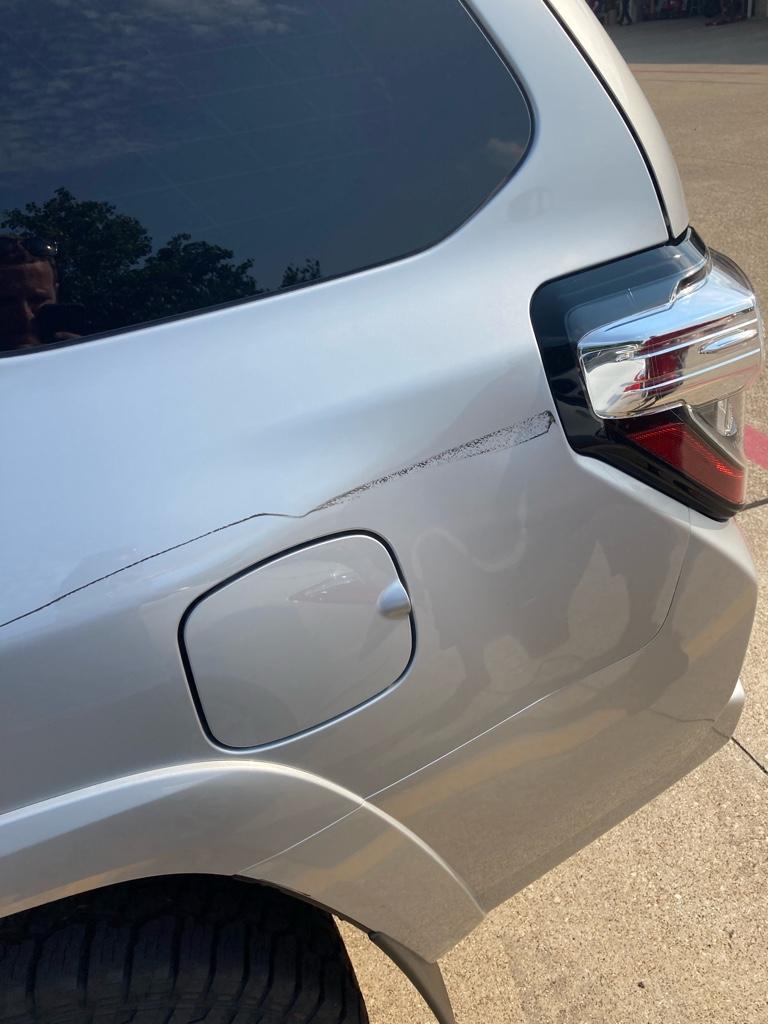

My 4Runner with 400 miles just got ko’ed in a parking lot. Luckily no one was hurt and they had insurance. How bad will this repair be and how much diminish value should I ask for? The bumper is also damaged.

Looks like paint transfer, no dents? If so it could be completely buffed out by a professional. Bumper might need new clips but could be massaged and reattached potentially.

I'd take some rubbing alcohol or acetone and get that paint transfer off. It should wipe right off.
Then I'd call a painless dent person for a quote. It doesn't look like there are any creases, so you may be able to get it fixed without paintwork.

To do it right they may need to sand and spray the whole side of the truck.
