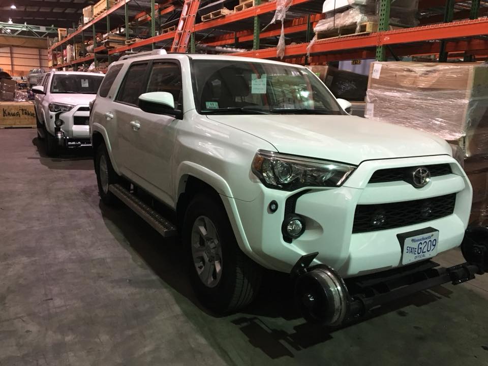

My day job has me playing with trains. Today I went to a facility that I rarely visit. While roaming around I saw some new, recently delivered, hi-rail vehicles. I went to check them out. They were the typical F-350s in various configurations.
And then I saw... two... brand new '17 white 4Runner SR5s. Both had hi-rail equipment added on. Aside from the track wheels, there were what looked to be very custom side steps, fire extinguisher, controller buttons where the heated switches are, additional warning stickers, and strobe lights.
I did not spend too much time looking at them. In the cargo area I noticed the spare tire which was just placed there. Obviously the hydraulics (I think it's hydraulics) and rail wheels take up that space. Overall they didn't seem hugely modified from stock. I'd love to, and will, look under them and under the hood.
I called up some people. They promised to take me for a spin on the rails in the 4R. I'll check them out in more detail then.
Typically, state organizations are required to buy American but it's only a certain large percentage. So if they bought a dozen Fords, there might be room for two Toyotas.
Then I was thinking - the price might be a big issue. I think a basic 4Runner SR5 might be cheaper than any other body-on-frame non-compact pickup vehicle suitable for hi-rail modification and operation.
I'll find out and report back. But in the mean time... this was very cool!

That's actually really cool. Are they 2wd or 4wd? Does it matter for this application?
It does not matter in terms of application. I was actually thinking about that as I was writing this - I simply did not look for the knob or the axle.
But I assume they are 4x4 for several reasons:
- It snows here, a lot and often
- All other fleet vehicles, aside from upper management cars (typically Malibus), are 4x4s.
Theres a shop here that builds them. All the ones ive seen are hydraulic, (except for the old style manual hi rails) I was told its usually 20-25k depending on application, but can be higher depending on options. Suspension obviously has to upgraded (probably just heavy springs) and tires as well. Ive used ford/chevy/dodge but never a yota. I ***** about my gas mileage with a lift, roof rack, ATs, ect. With those hi rails i would guess around 13mpg
Updating with a bit of fresh information:
https://dmfatlanta.com/products/railgear/rw-1013/
http://www.nscorp.com/content/nscor...ture/big-wheels-keep-nsoperationsturning.html
4x4's are used because of the increased ground clearance, and necessity of driving in loose gravel and dirt near crossings where they mount/dismount the track. The equipment is hydraulically deployed by a 12V powerpack in the cargo area.
The primary draw of the 4Runner for this application is that the stock wheels and tires align well with standard gauge rails. Larger SUV's and trucks require specialty inset wheels and tires to narrow the track width, which A) increases cost, B) reduces payload, and C) triggers expensive re-testing to certify that the vehicles are still in compliance with FMVSS standards. Anything smaller than the 4Runner is either a unibody, or does not have sufficient payload capability to be a useful starting point. Because of those same payload concerns, these are typically optioned without 3rd row seating, or have the 3rd rows removed.

These are probably used by supervisors for track inspections or to drive around the "higher ups" on rail to show them ongoing rail projects.
With regards to speed, I'm not sure about the US, but in Canada, they are only allowed to travel at 25mph (going forward, 15mph reverse ). If it is a supervisor, then the speed us up to their discretion up to the maximum rated speed of the hi-rail gear.
Neat Ditch/Rail lights (or cameras?) on the bumper corners. Might be cool to see what that tech/mod is on its own!
