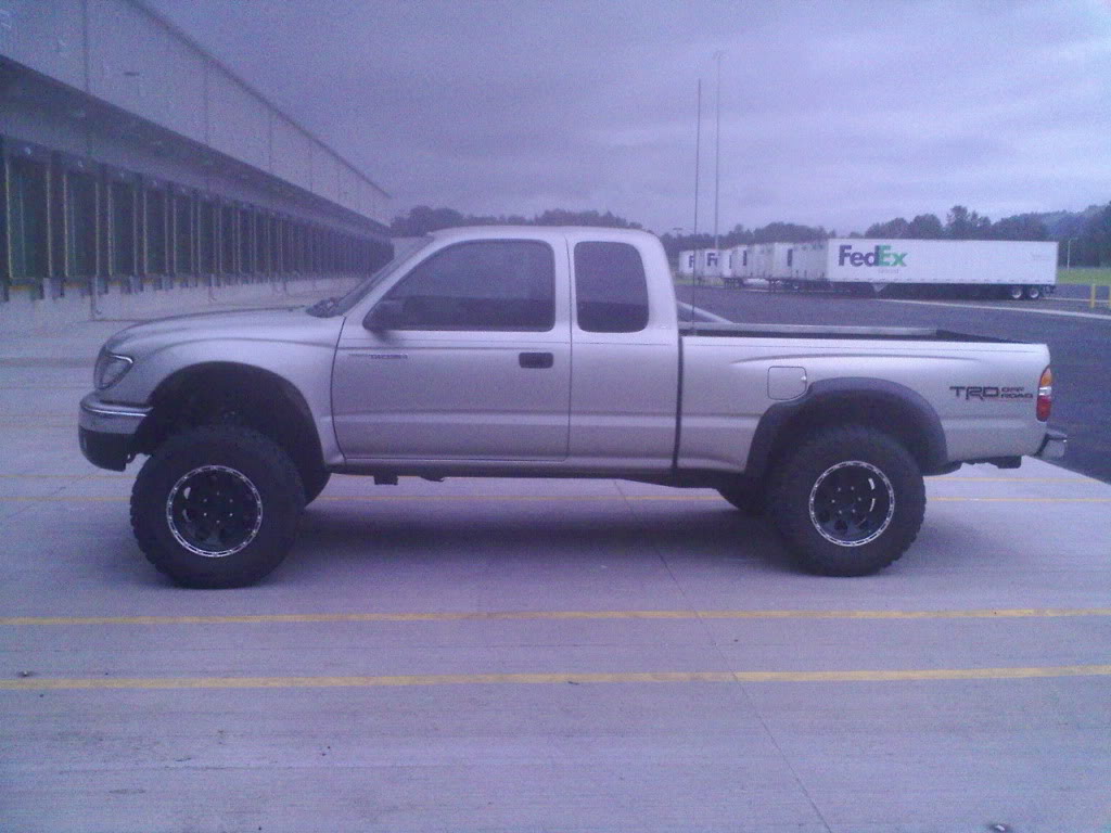

If you're looking to get 2 - 2.5" of lift in the front, you will definitely need something in the rear or you'll get the dreaded "bro" lean (as seen here on this Taco). :wow: The FJ coils aren't enough to level everything out. For instance, when I first installed my 5100's w/ FJC coils it was almost perfectly level from front to rear (set at 2nd notch for 1.75" of lift in front). I went to the top notch (2.25" of lift) and added the Superflex coils in the rear and I now have a 1" rake and love the stance.
I see what you mean, Thanks much for that info. That one issue solved. I knew it would pay to ask you guys.
