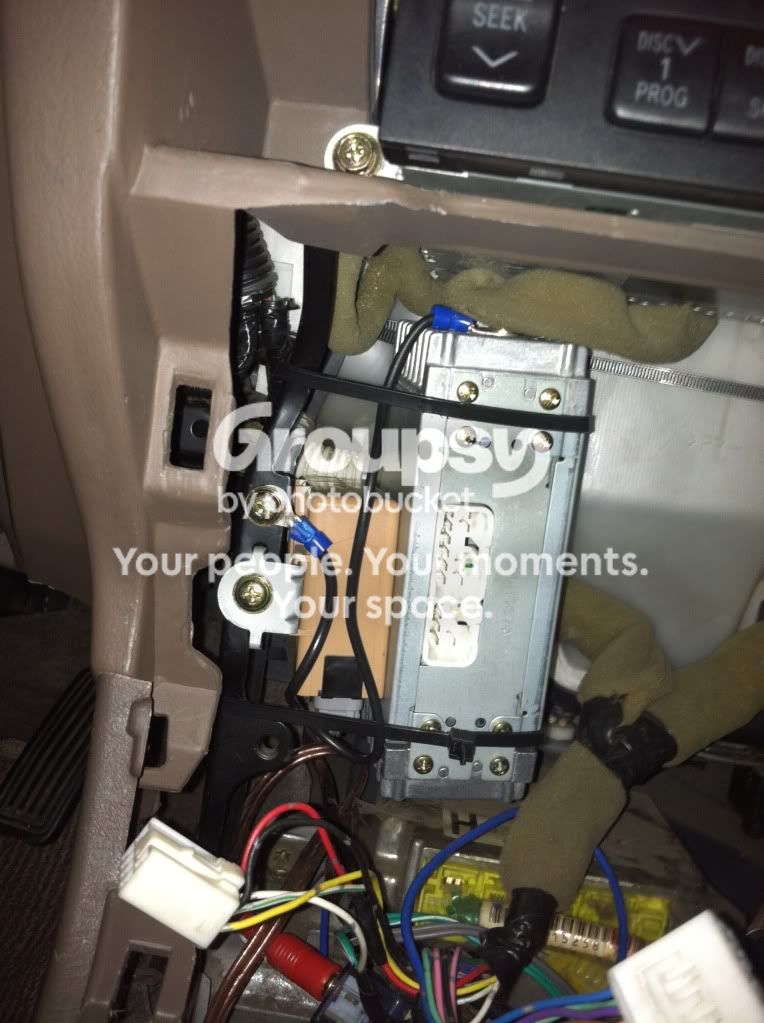

Thats odd. I', almost 100% sure ive disconnected my head unit, plugged it back in, and everything worked fine. No issues at all. Just had to reset my station presets.
Or maybe i disconnected my factory amp. Not sure.
Nevermind. It was my amp haha
