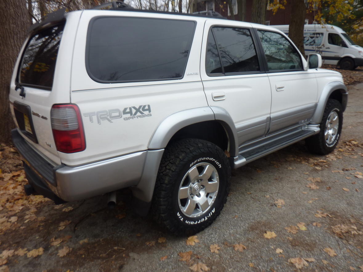

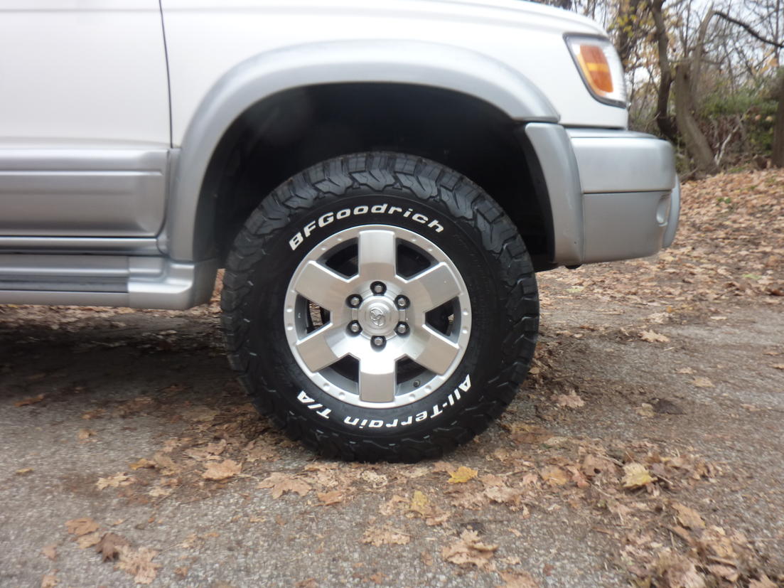

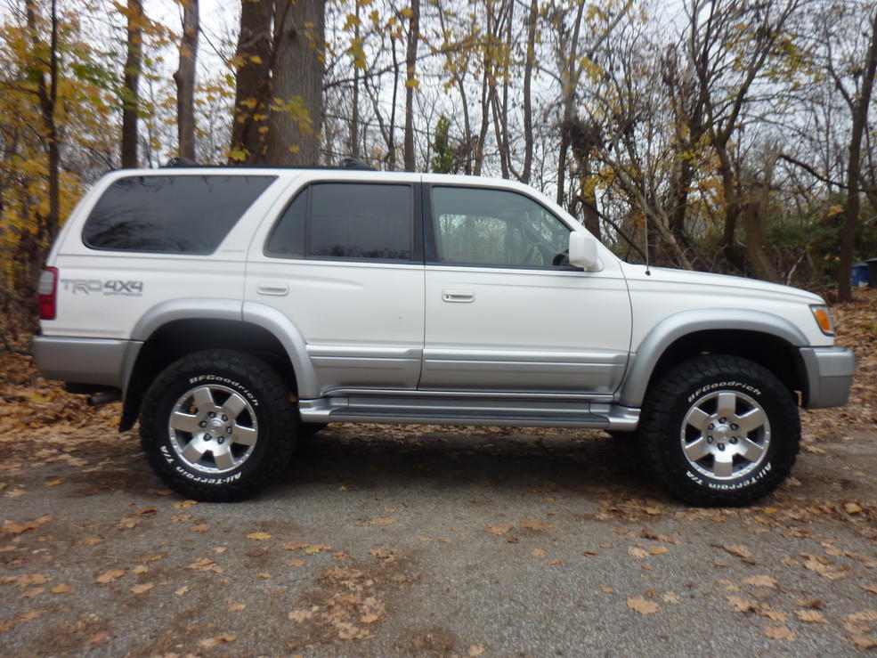

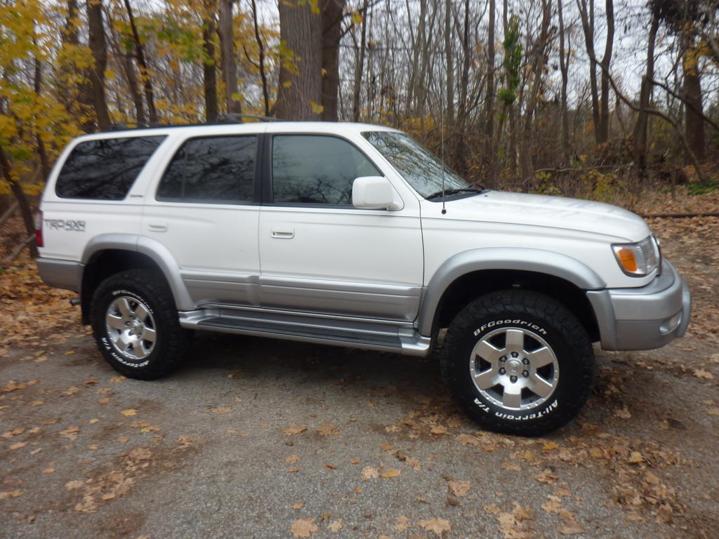

I've been eyeing these tires for a little while now. Finally pulled the trigger seeing winter fast approaching. Bought them from Tirebuyer.com for $799. Then there's a $70 mail-in-rebate. Then a $20 of coupon and finally $20 if using one of their installers, which there are plenty of. The tire shop I go to was one of their installers so it worked perfectly and was only $60 for the installation. Total price with installation and tax was $880.
My first impression of the tires was wow, these things look good. I have them mounted on 2007 FJ Cruiser rims, which I was a little worried about rubbing with the backspacing on those rims, but there's no rubbing at all. I have a Tundra/890/Billy 5100 lift. I've taken them down some nice bouncy trails and went over some NJ potholes and still no rub. They run very quiet at all speeds, even 90MPH. :police: No shakes at all. They took almost no weights to balance. I honestly didn't know what to expect with the E-rated tires but I can't tell the difference in drivability with the stiffer sidewall. We'll see about gas mileage however. They weigh 52lbs a piece so that's got to affect mileage a little.
