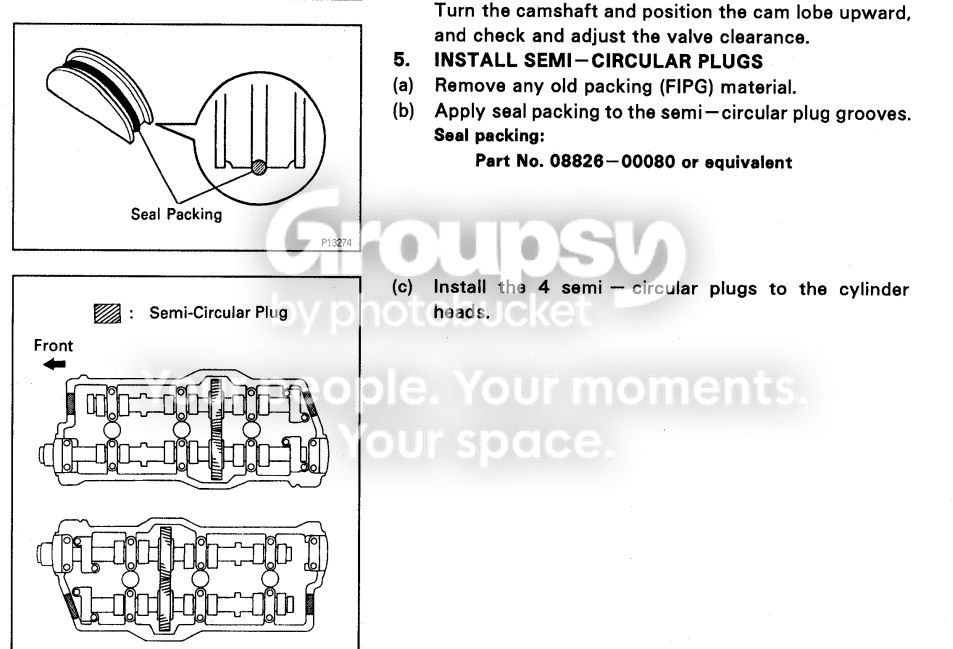

So you used RTV instead of the actual gasket made for the valve covers? The only place you use the RTV should have been the cam plugs.
I didn't replace the semi circular plugs as they were aluminum and appeared a non serviceable part.

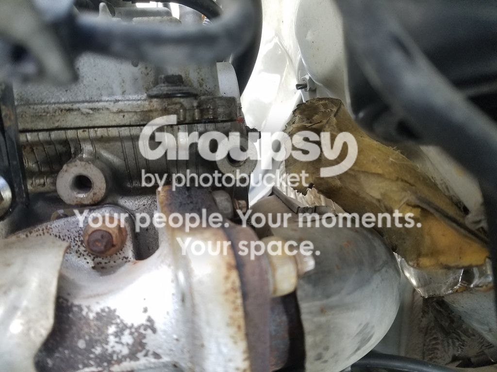

I did place the packing (rtv sealant) and I did use a gasket for the valve covers, as i remember buying them and using them. also have my refernce photos when i dressed the motors and they are in place on the valve covers. Here is the worst leak. You can smell oil burning when i push the motor hard. Looks like it drips right on the header to Y pipe connector.

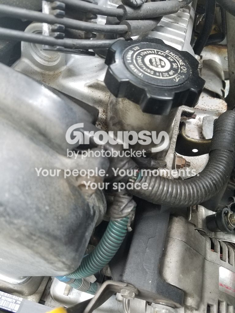

Also getting some leakage by my oil cap, never heard of that before. I wiped it off before the picture but you see the smudge.
Ill probably crank down the valve cover bolts another turn but curious if I was really missing the boat. I'm not seeing any leakage around the semi circle caps, ill get a pic tonight with a mirror.
At 275k miles, my oil cap o-ring was seeping/leaking too. The o-ring/gasket is still available new from Toyota. How's your PCV valve?

You don't need to replace the aluminum semi circular plugs, but did you remove, clean, and put new RTV on them? You should always do that anytime you're doing valve covers.

My cap has no o ring on the inside. Problem #1. Im glad someone else has gone to snug vs torque, going to pull intake and get to these guys this weekend. Snug it is.
Eh, the gasket/o-ring is probably there, just totally rock hard and flush with the cap. It seals against the top lip of the opening.
