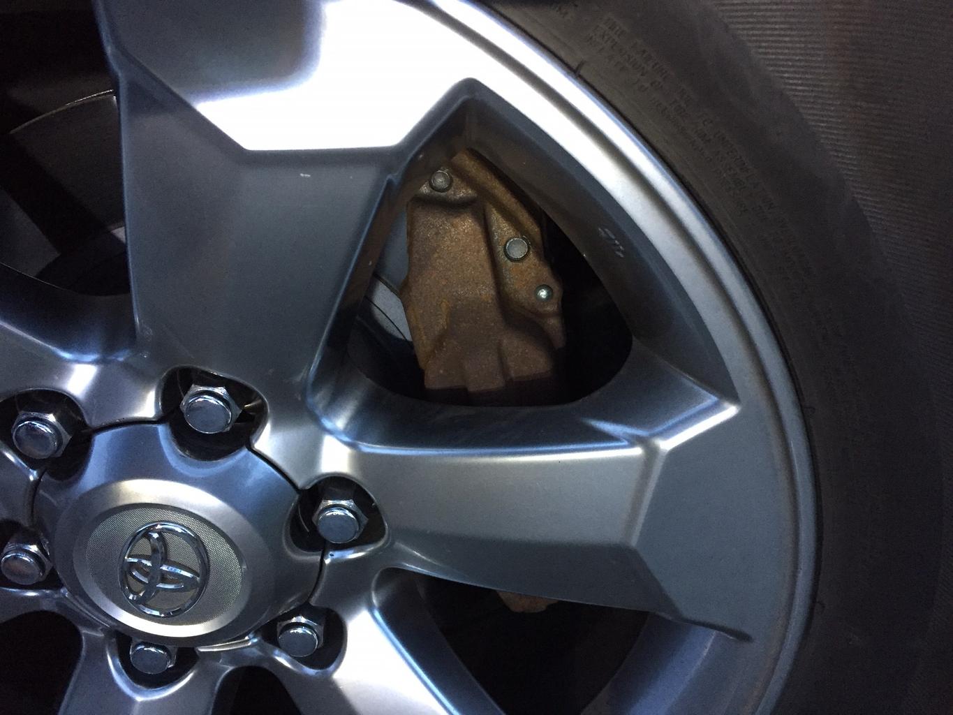

1. Both front calipers quickly rusted, see attached pic. Looks pretty bad and sticks out like a sore thumb when looking at the vehicle which is otherwise in new condition. Looked great/normal initially, but then went downhill quickly. Shop claims this to be normal as the calipers do not have the zinc anti rust coating to prevent this.

The only way to keep the calipers looking good and not rusting is to have them painted with high temperature paint, some people use black "grill" paint
but they make special caliper paint for painting them in just about any color you could want.

Yeah, they needed to be painted. Kind of annoying. I went through the same thing.
Search my posts and you can find me painting my calipers on the runner. Not easy, but a good weekend project. If you're handy you definitely can pull it off!

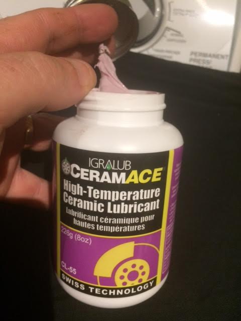

My mechanic uses an expensive ceramic paste to lube Caliper pins & stainless steel shims (on pads).
- some garages don't give these two critical steps, enough attention
CeramAce is a high-temperature fitting and release anti-seize paste containing more than 30 percent solid ceramic base.
- Waterproof and resistant to salt water, acids and alkalis, the paste protects against corrosion and does not get gummy.
IGRALUB LUBRICANTS http://www.autosphere.ca/carcarebus...1/igralub-lubricants-cermacace-carbonlub-bss/
