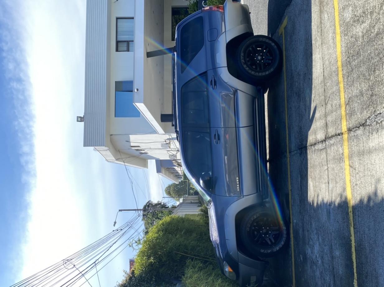

hello guys im new here and i'd like to ask few things
first of all i bought 4runner 2006 diesel turbo
and i would like to please know what kind of engine i have
i read online that 4runner come with v6 or v8 engine
and i asked a mechanic and he told me its a v4
does it make any change when i want to buy suspension?
i live in costa rica 5 hours away from city and in general there are not many options

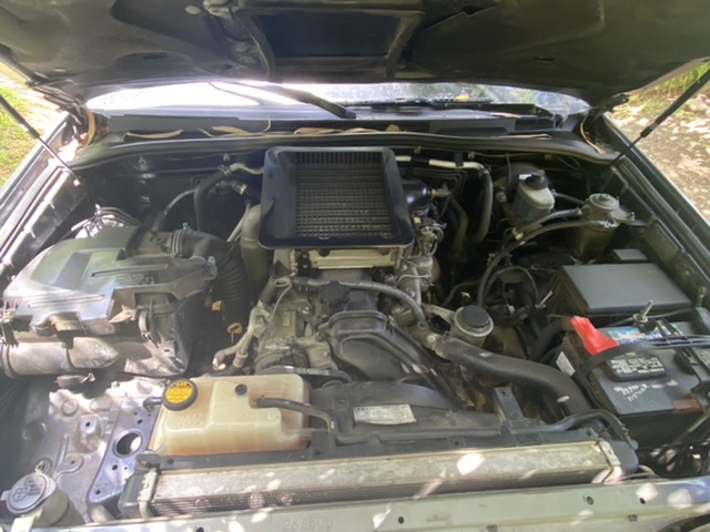

We don't get that engine option in the USA. A turbo-diesel would definitely be interesting, but I can't see any reason the suspension options would not be the same. My 2005 4Runner has the V8, but I used 2010 FJ springs to level up the front. I had to expand the lower bracket to fit the shock in, but it rides higher and much nicer than the failed XREAS. I just used standard KYB shocks on the rear.
My guess is your engine is an I-4 (inline 4 cylinder). Like was said we don't get that option in U.S. As far as suspension, a guess is that it is same as U.S. models, so you have a lot of choices. Look at some suspension discussion for 4th Gens as that is probably what will fit your 4R.
Your mechanic is corrent, you have the 3.0 L 1KZ-TE I4 turbodiesel that is specifically produced in Latin America. Unfortunately, I'm not super familiar with the engine, but the chassis looks pretty similar to an American 4th gen 4runner.
