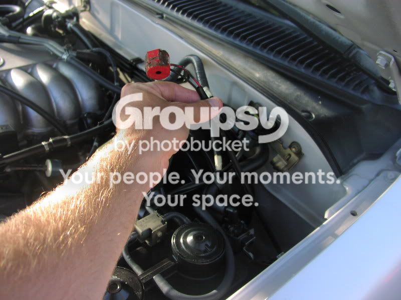

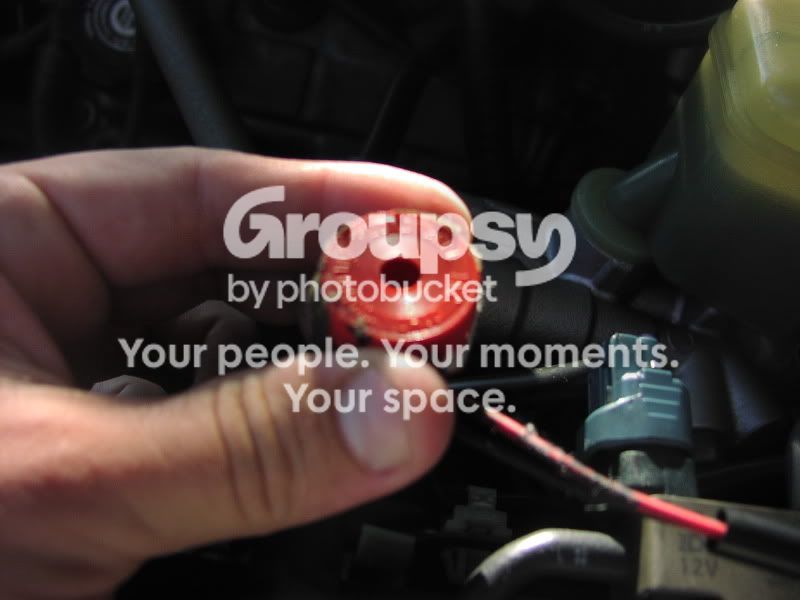

Well I found the chirpper today, not quite sure if this is the stock chirpper or not though.
Its resembles a red screw on bottle cap. Its a attached to 2 wires, a power and a ground that go straight through the firewall, from there im not sure.

Awesome man, thanks for the pic. That led me right to mine. Only mine has some foam-like stuff around it. I think i see where the wires have been taped aswell. Might explain why it doesnt work most the time..
Cool Im glad the Pic helped. Yeah mine had some foam bits around it, most were worn off. The wires did have electrical tape on them, but they do seem to be sodered (sp?).
