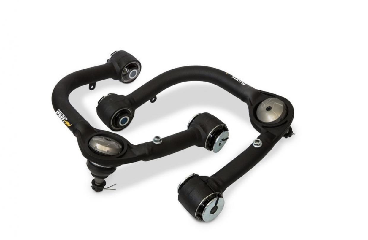

A local shop is starting to advertise these. Not sure if they are a new product, or just new to them. Thoughts ?
“Landcruiser 200 series 07-20
4runner 10-20
Tacoma 05-20
Forged Ball Joint Housing
Forged Eyelets
Heavy duty greasable ball joint
OME balljoint protective cap
GIIRO bushings, free pivoting, grease free and maintenance free
Increased camber and caster for 2 inch lift
Mount provision for OE ABS wires
ARB Integrit powder coat finish
Tested and passed to meet VSB14 requirements “
That seems like a good price compared with others out there. I had Camburg before SPC, they were definitely better. The Camburg cost a little more, the challenge was getting more caster when I went up a little in height, hence my switch.
On that link above it says an increase of 2.5-3.5* of caster with 2” of lift. That might mean if you are going to 3” this might not be the best option. So much variance in trucks that it seems hard to say.
Installed them today, went well. Will post a thread with pics and tips and such once I achieve this ridiculous post count that is preventing me....
Bought them on Amazon of all places.
