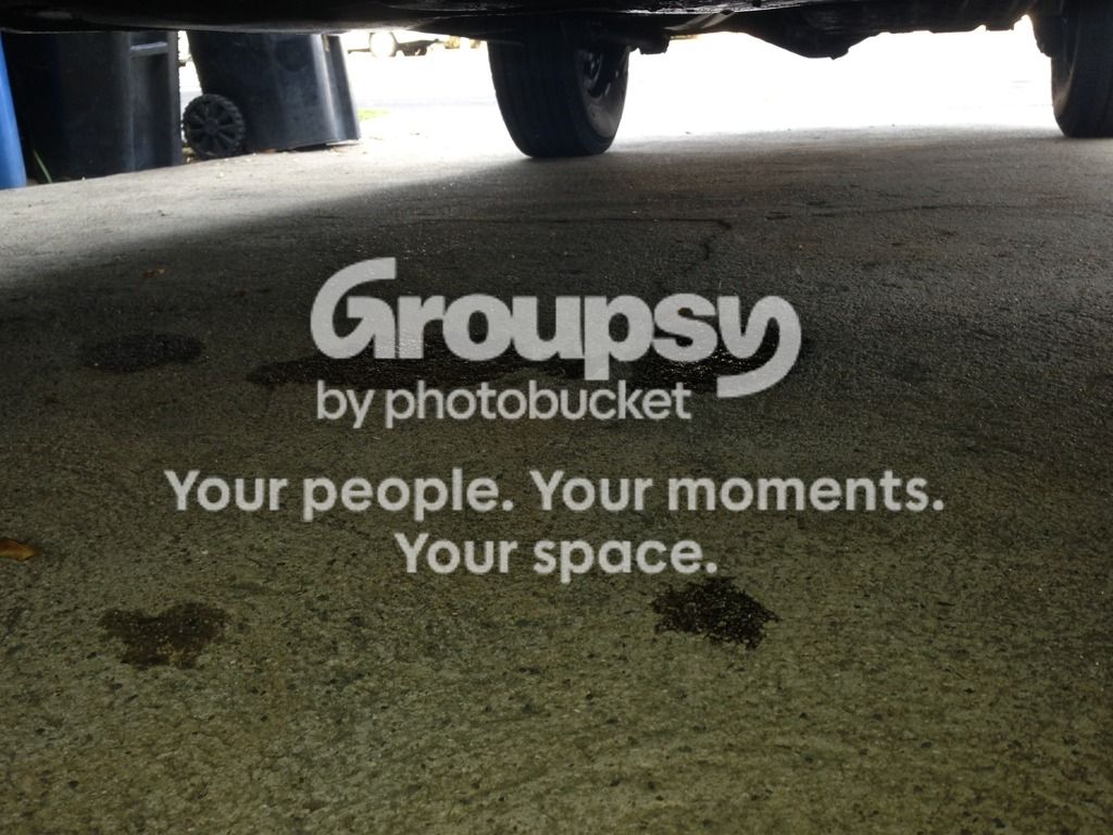

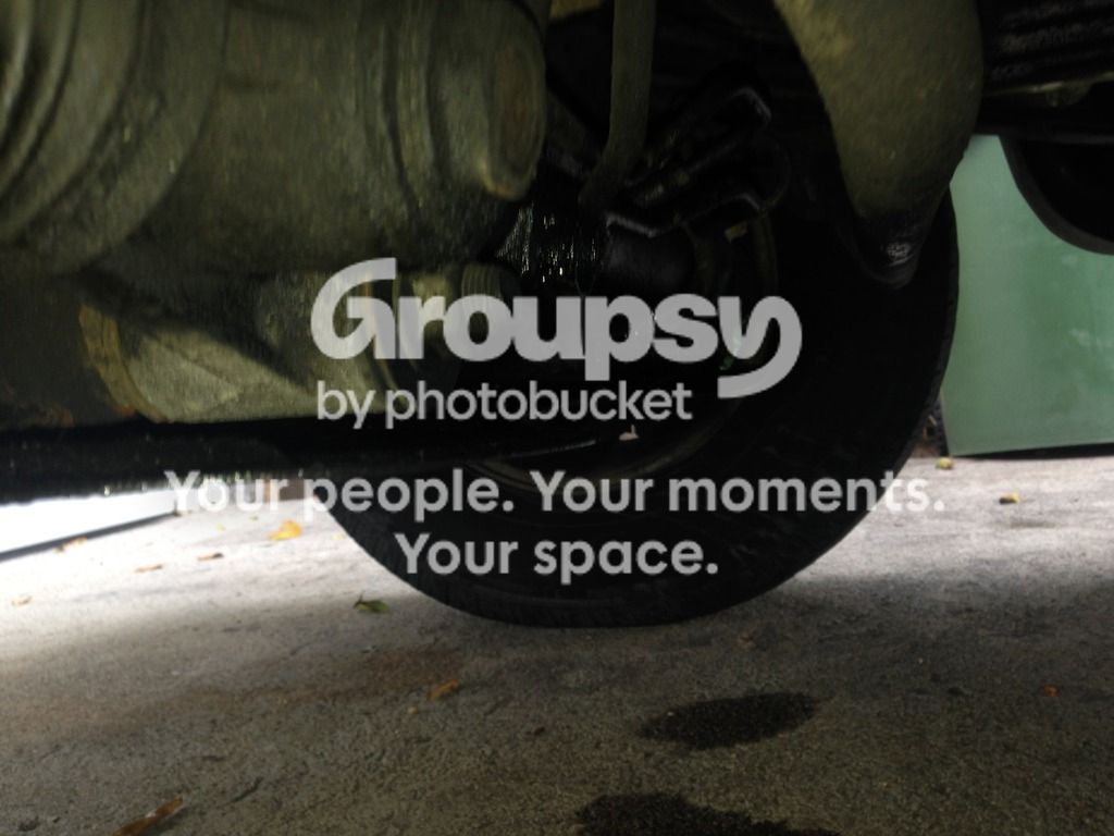

My main concern the oil leaks. (atleast what i think is an oil leak...could be PS fluid although when i dabbed a papertowel at the small puddle it looked and smelled like oil). The oil leak is mainly rolling off the skid plates in several spots. When driving, you can smell faint oil burning coming through the vents. The valve covers dont seem to be leaking from what i saw, see pics.
392_zpsts3zb52b.jpg~original
From behind the skid plate:
394_zpsbcnva5bq.jpg~original

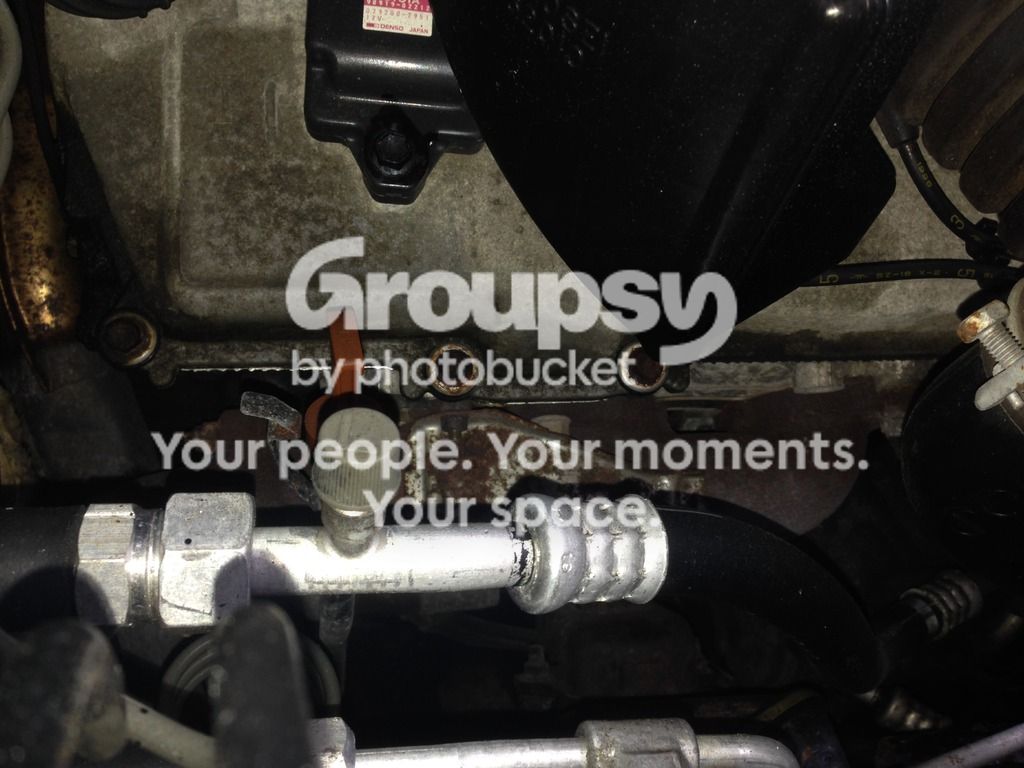

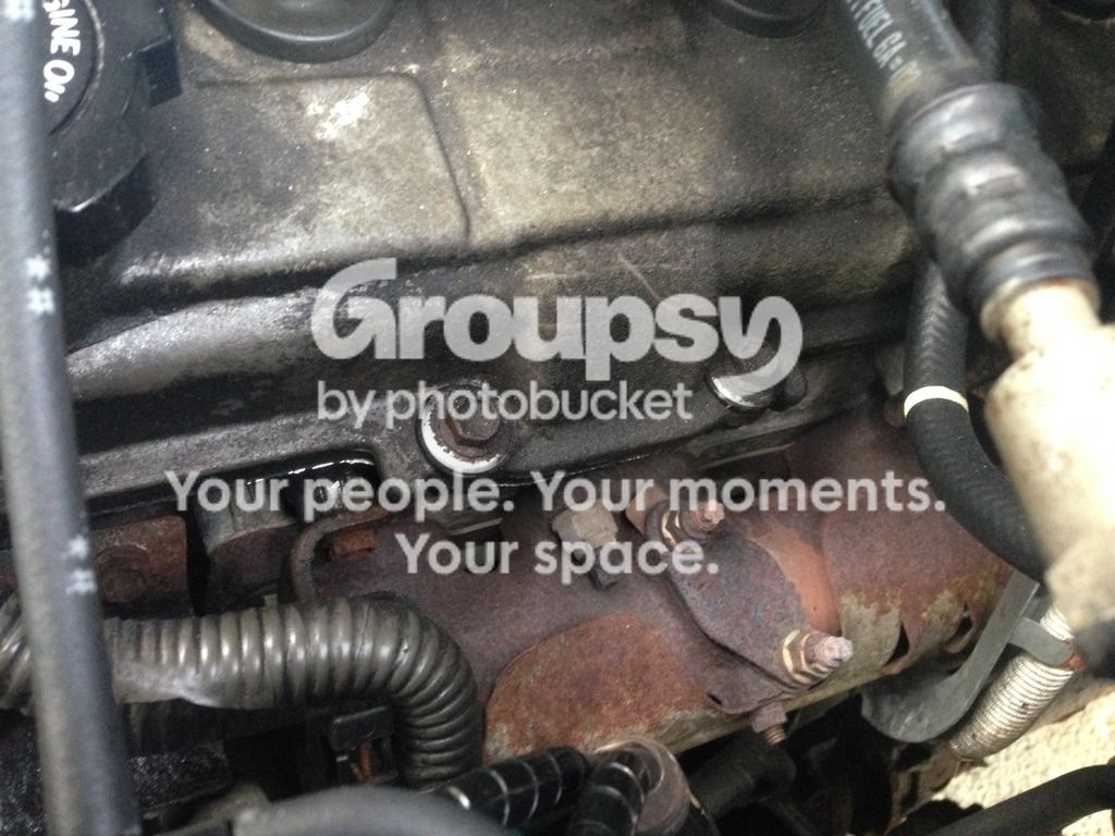

valve covers:
388_zpsjzkkjjee.jpg~original
389_zps7ljcqew7.jpg~original

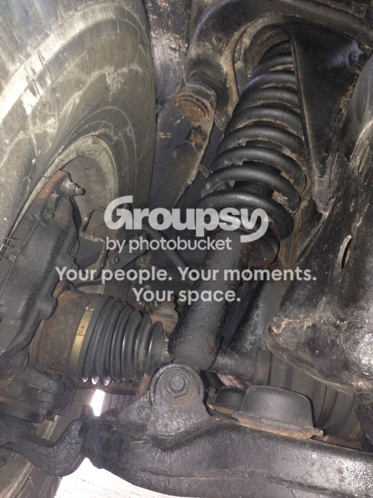

The other thing is rust. It looks like the P.O. treated the 4runner for rust before, it spent most of its time in NY state.

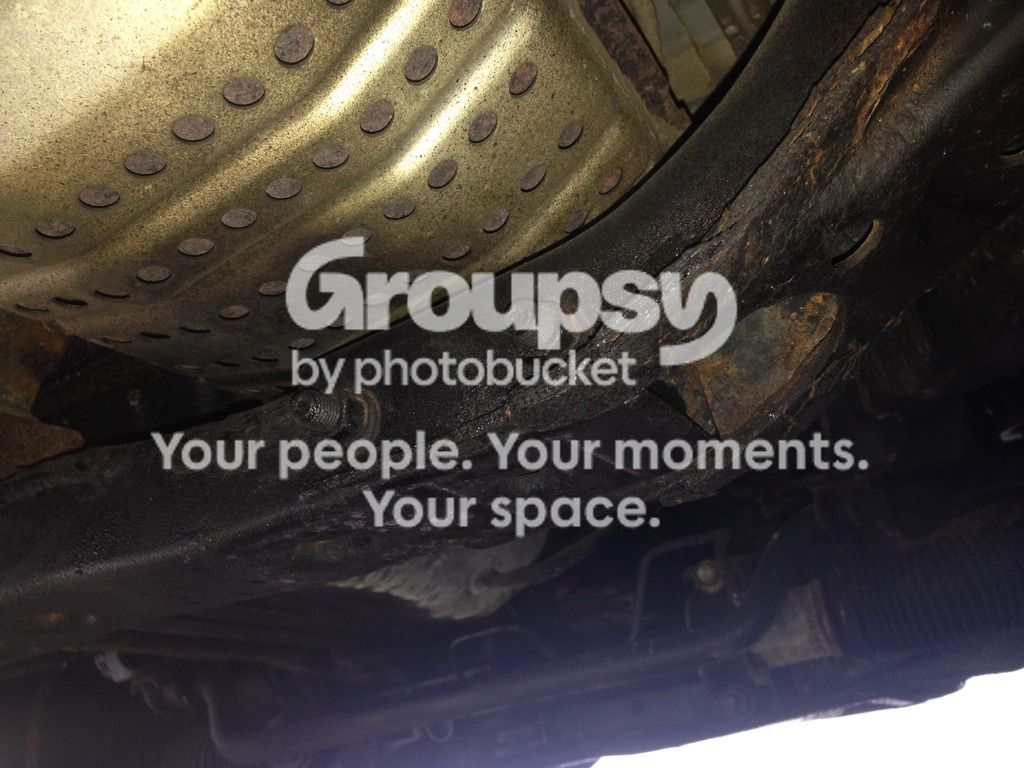

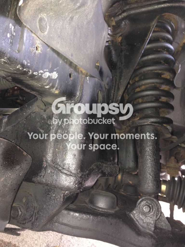

Pics of undercarriage:
393_zpsocvbwch6.jpg~original
391_zpsjp8x4ptz.jpg~original
390_zpssimtmaav.jpg~original

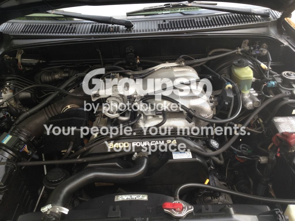

Kinda deceiving when looking at the engine from the top (intake manifold has been painted):
387_zpscpe7ujvp.jpg~original
Seems like it has alot of new parts. Let me know what you guys think.

Looks like power steering fluid on the rack that's wet.
Engine oil on top of the skid plate is normal from oil changes. The valve covers look good.
Even if you put a little money into this truck it is low miles at the end of the day. If you have any mechanical skills you can do a valve cover gasket job your self if needed. As for a steering rack it is a little harder but still can be done also. I would not worry to much about the timing belt just because the worst it can do is break and just die on you. This is a non interference engine so it will not destroy the engine if it goes. It will just be out of time and you will need a tow to a shop in the end, not a big deal.
I thing all and all if this is all the is wrong you did really well. Hope you enjoy the 4Runner. As for the engine power it is normal. They didn't even make 200hp new so I guess you will be getting a super charger in the near feature. Enjoy
Blue
I'm thinking leaking cam plugs and/or half moons. Tune it up. They are not rockets but if you leave the tires and suspension stock it will hustle along when you need it to very nicely.

I will seek a second opinion on the leaks. As for a tune up, i dont know too much of the history on this vehicle but cables going to the coil packs look good, air filter looks good, and the oil level looked to be within limits and golden in color. Idk about spark plugs but idle is at about 600rpm and is smooth. I had a 2003 camry that needed its maf sensor cleaned out regularly, but i'll hold off on the 4runner until i get more acquainted with it.
