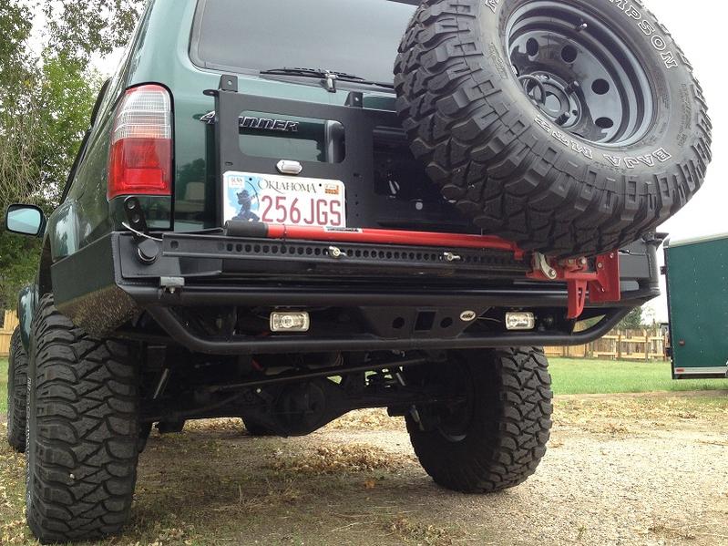

Out of curiosity and an idea that might help you out what LC coils do you have? Do you know the wraps or color codes (you might be able to visually see the color codes depending on how old they are)? I'm running 7.5 wrap LC coils currently (color code: double pink grey white) with a CBI hybrid rear w/ swing out, high lift, 33 inch spare and some other weight in the trunk area. I can get you my rear height measurements and if you have the same coils it will give you some idea of how much your rear will tuck down.
His ad said 8.5 wraps but I haven't got under there to check em out.I could check tomorrow after work and see what they are. Thanks for all the help. Are there good pics of your rear bumper and tire carrier on here? I'd like to check it out to see if I like it.
Just checked out your build thread and the pics of the rear bumper,that's exactly what I want. How much did it run if you don't mind me asking?
8.5 wraps with no weight in the back? That's gotta be fun on washboard roads. Knowing that your best bet is definitely going to be toytec coilovers. You'll get about 3-3.5 inches of lift from those depending on where you set them and what weight coil you get. With a rear bumper with tire carrier I imagine you will get about 3.5 inches of lift from the coils you have now. Possibly down to 3 depending on how heavy your bumper ends up being. You'll probably end up being level to a little raked in the back all said and done.
The CBI is pretty sweet I would recommend them without question! As far as the actual hybrid bumper goes this is one of the best pictures I have.
The cool thing about CBI is that you can customize the actual swing out arm. Mine is just the original one, that way I have the option for a can carrier if I want. I know there are guys on here with custom swing arms (BigFishAllDay and Ameining come to mind) so you can look around for some ideas when it comes to that. Oh and it ended up being between 1200-1300 with shipping and powdercoating.

That's definitely a good lookin setup,kinda pricey so I may have to wait awhile before I can manage that and front coilovers. I'll get the suspension right then I'll worry about a bumper. Thnx for all the info
