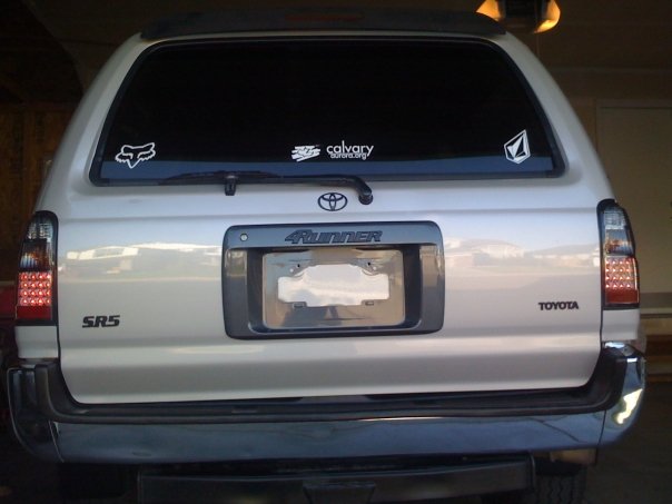

New pic of leds tails. On my truck.
looks real nice eddie, the rear end of your runner looks good :bigok:
i think i will upgrade to black LED tails after i get my rims and tires and what not.

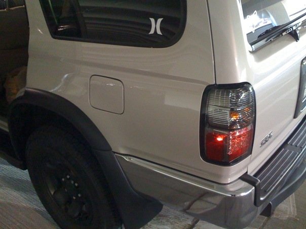

the answer is YES... install LEDs and run the risk of the ABS light coming on... If it does come on by a resistor and that should solve the problem. When I put those pics up, the ABS wasnt on, no problem, but after putting a 921 bulb in the third brake light, the ABS popped on...
ABS is inactive if that light is on, so I took it to the dealer to have them get the code and find a solution... The code is: 49, and it comes back to a brake pedal sensor error, the dealers solution was to go back to stock lighting, but I think i'd rather get the resistor... So there is my update to my issue, it all happened to me in thepast two days, so fresh off the press...
