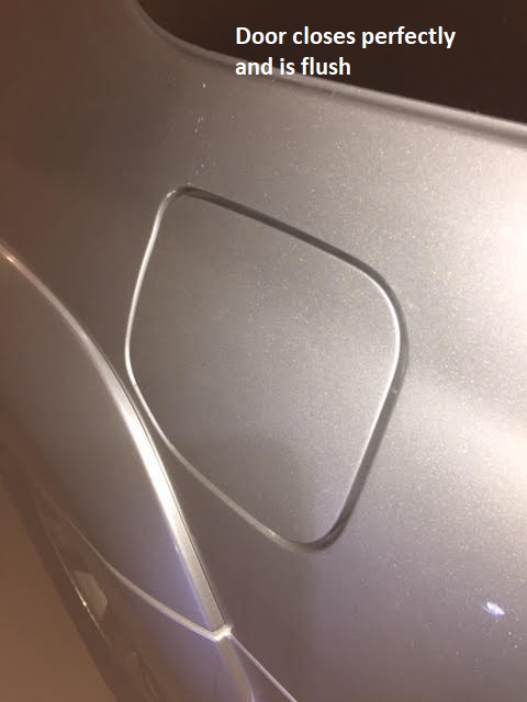

Nice clean 4 Runner-Fuel Door Fix Part 1
I also just purchased a silver 2007, now with 169k miles. I just tucked it in the garage for the winter after a 2k miles trip over 6 snowy mountain passes, across windy open prairie and through winding Indian Reservation roads. It performed like a champ. But as expected on my 2 night trip I found several little things that need immediate attention. One such fix is a rusty pin on the fuel door.
Since we need to accumulate 15 posts before we can create a thread I hope others with similar problems will be able to find this post here.

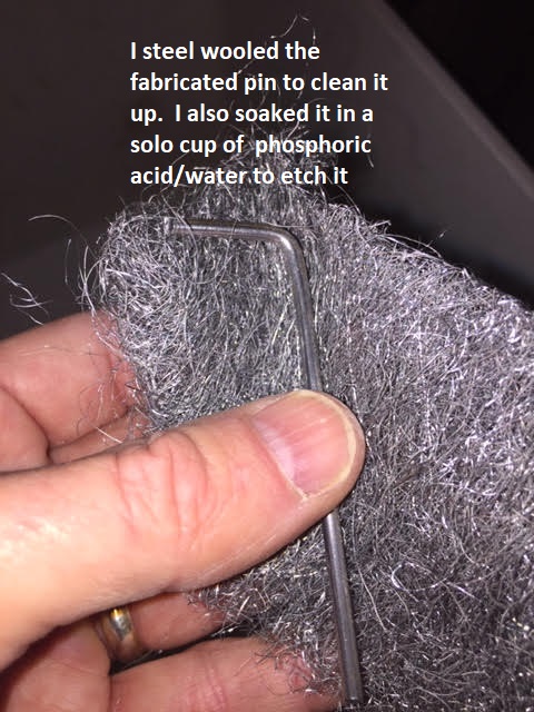

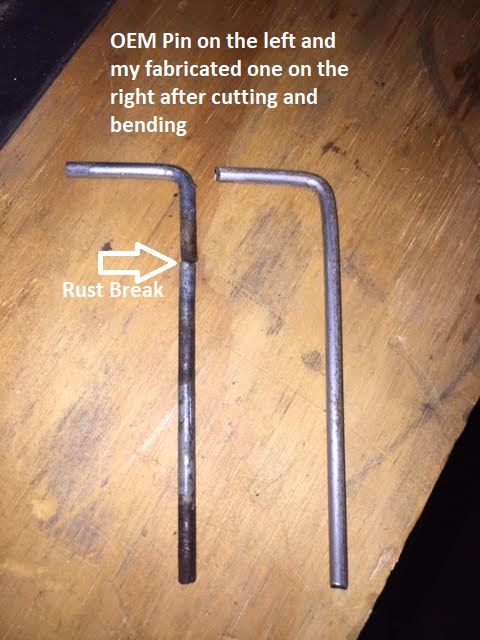

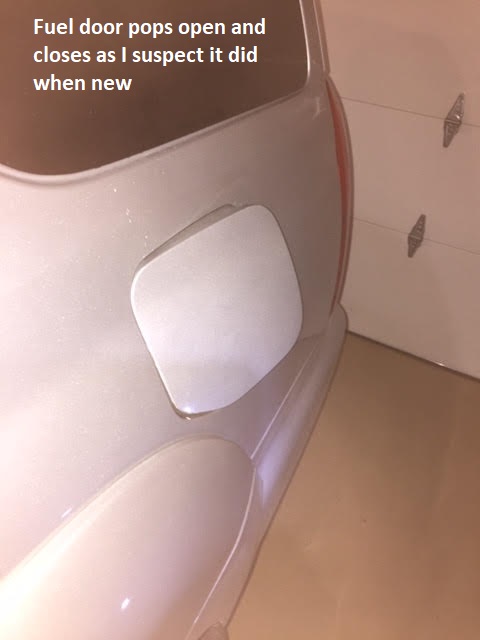

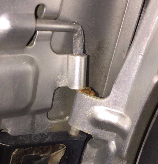

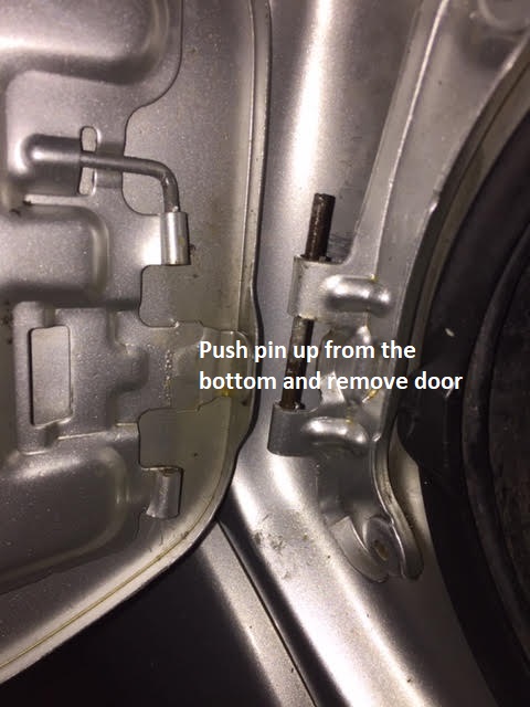

My fuel door was not closing flush on my trip from Chicago. I needed to push it flat and then still worried that the wind might rip it off. I noticed that the hinge pin on the fuel door had rusted through and the door was hanging on the pin. Here is my DIY Fix. I will continue with a second post to show putting it together and the finished project.

Fuel Door Fix-Part 2

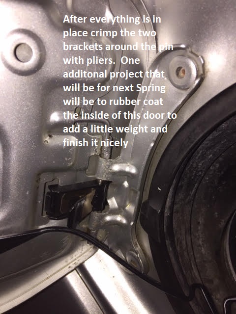

After removing, matching and cleaning the fabricated pin its time to insert the new pin in the bracket on the car. Start from the top and clip the bottom hinge on the door over the pin. Its important to leave the top door bracket open to allow you to shove the hook into the holder on the door. Use large pliers to close the hinge brackets around the pin. Reattach the spring and reattach the cap strap.

Great work! I'm having the same problem with the hinge pin rusting. Is there an actual OEM part number for the hinge? Or do I have to fabricate one or buy an entire new door?
You can't just get the hinge because it's spot welded to the fuel door.
You'll have to get the door to get the hinge and then have it painted, it only comes primed, or repair/replaced your hinge pin as Snagglepus did.
