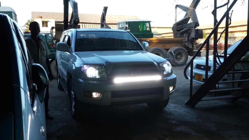

i have recently bought a Toyota Hilux surf(4runner) SSR G japanese spec.
Model: VZN215W
Year: 2003
Engine: 5VZ (3370CC)
Now since i am new to this car and i did not get any manual with it.i would like to know which oils to use and how many litres in the following areas
- Transfer case oil
- Diff oil
- Engine Oil
- Power steering fluid
- Transmission Oil
please help me get the above information so that i can service the car thoroughly before i start using it
