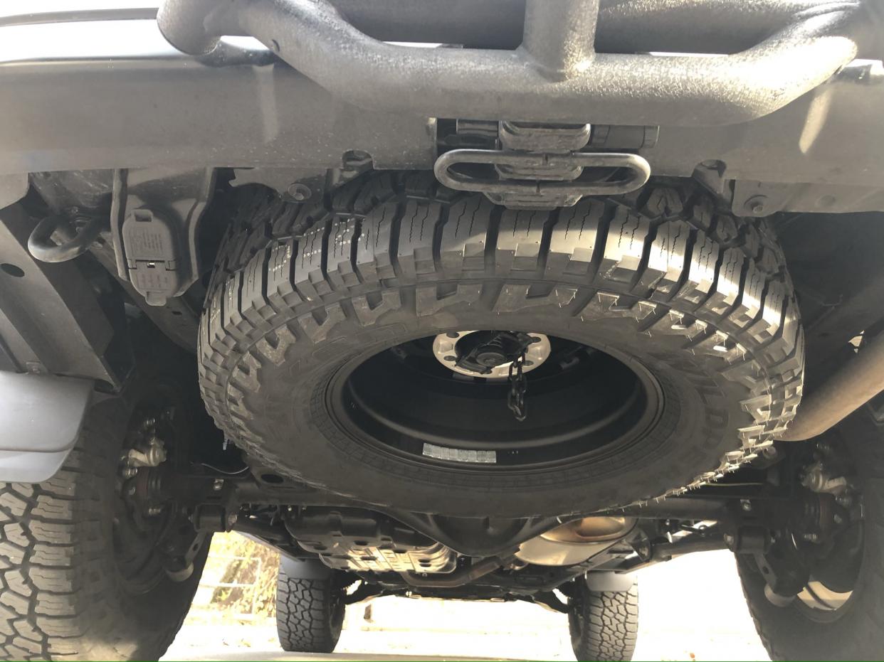

I think having a matching spare tire and wheel is important on a four wheel drive vehicle. When I switched to 285/70-17’s on my Pro, I purchased a new 285 and a new TRD Pro wheel as a spare.
I do a five tire rotation and feel comfortable knowing I have a matching spare tire and wheel.
The 285 fits in the spare tire well, but I do not have KDSS, which may be a little more difficult to fit.
I have KDSS and a 285 spare and didn't have any problem fitting it underneath - have about 1" to the KDSS sway bar.
