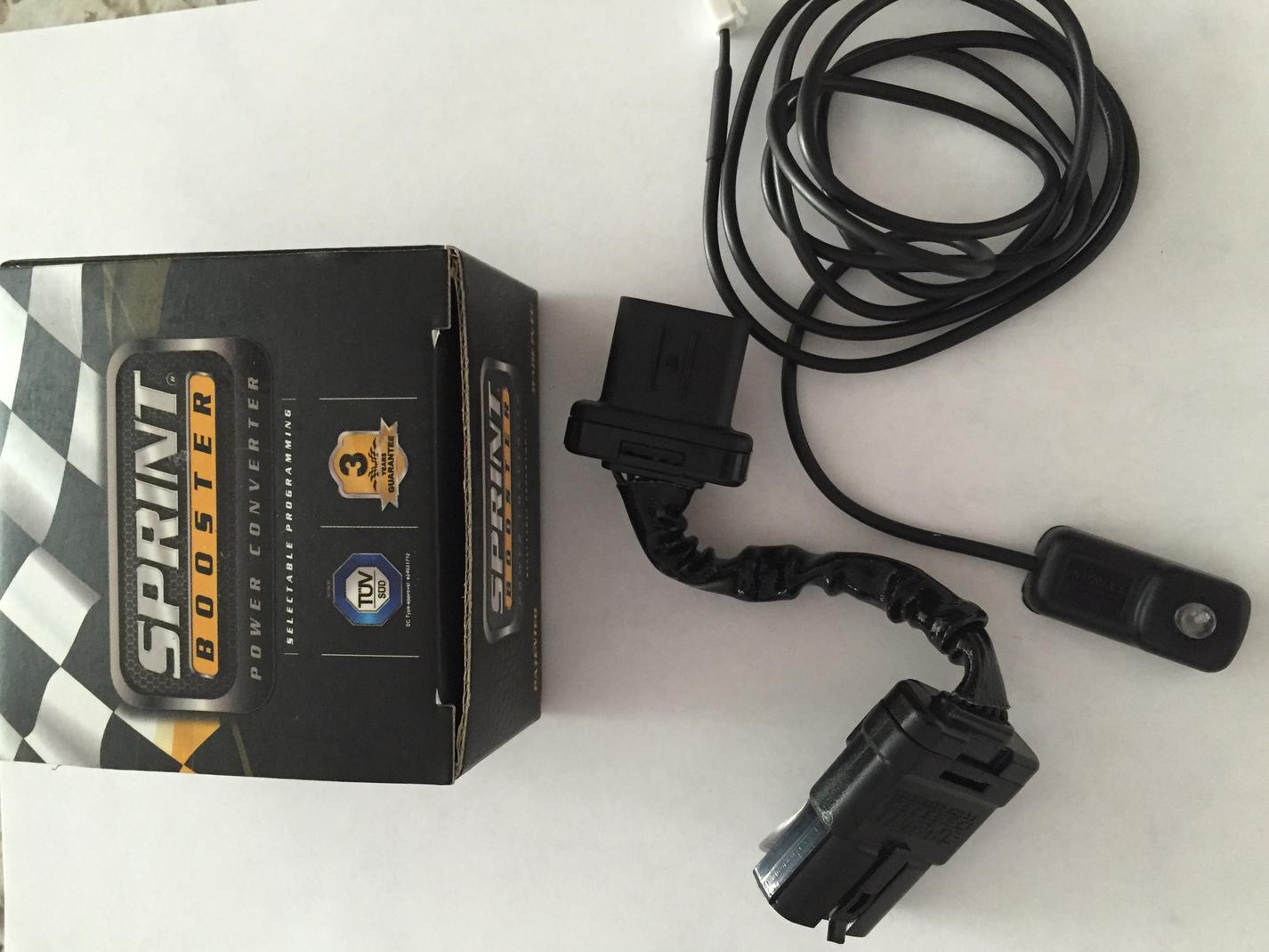

Here it is. But Laurie has the car till late tonite and I'm going to a bachelor party in a limo. Looks like a one minute install I'll do tomorrow.

Ok are you ready for my simple opinion after testing in the city and mountain driving? If 300 bucks is a lot of money to you forget about it because it is not groundshaking. As I suspected in town its not needed but in mountain driving I really like it. Actually I like it in town but in the green mode. The red mode is too twitchy. No lame ass throttle is a perfect description. You breathe on the gas pedal and it gets with it. If you dont buy one your not missing out on alot. I wont send it back because I have the 300 to spend and its fun.

SPRINTBOOSTER THROTTLE ENHANCER
WHAT'S IN THE BOX
THE FUN SWITCH
Just installed this today in my 4Runner, took about ten min tops to install. Your probably asking yourself what the heck is it? It's the Sprintbooster Throttle Enhancer.
Basically it remaps the stock throttle to more aggressive settings. There are three settings to choose from, completely off, sport, and race. It installs in between the factory wiring to the gas pedal and the pedal itself. Install is super easy. Unbolt the gas pedal from the floor using a 10mm socket. Next use a small flathead screwdriver to push in the release on the factory wiring harness clip and unplug it from the gas pedal. Plug the switch cord into the Sprintbooster. Next plug one end of the Sprintbooster into the factory harness and the other the gas pedal. Position the gas pedal and the wiring from the Sprintbooster to where you want it and then bolt the pedal to the floor. Your done!!!
I completely bypassed the sport setting and went to race. Whoo Daddy!!! This is the way it should have come from the factory!!! Feels like I gained a bunch of horsepower when in reality the Sprintbooster adds zero power. It simply remaps the throttle for much better response. Check out their website for all the technical stuff.
So what are the cons to this. The only one in my opinion is it's not cheap and it doesn't actually increase the horsepower. Some may have a problem spending the $299.99 price for zero HP but let me tell you it vastly improves the drivability and fun factor of the truck. Look around and you may be able to find a better deal.
It's nice that it has different settings and I like that you can turn it off completely. This comes in handy in slippery conditions, when your wheeling offroad, and if your taking it in for service.
To be fair I've had one of these installed on my Z06 for several years now so I knew what to expect. I just didn't know if they made one for the 15 4Runner (actually you need to buy the one for the 2014 but it works fine on the 2015). When I found out they did it was a no brainer for me. Now my truck runs the way I want it to and no more weak sauce response!!!!
