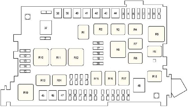

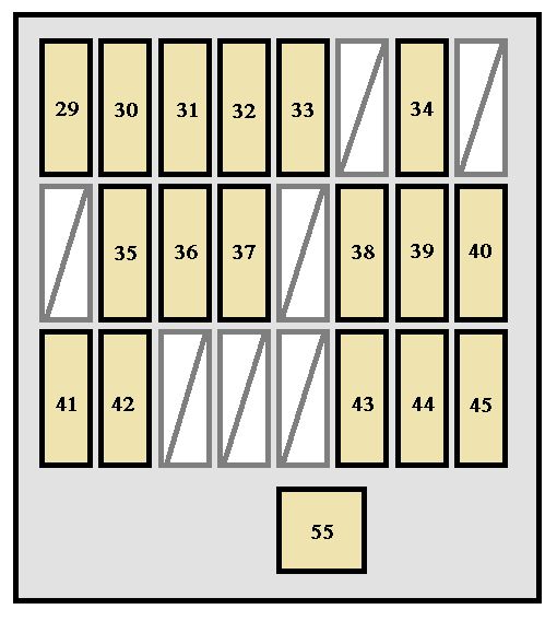

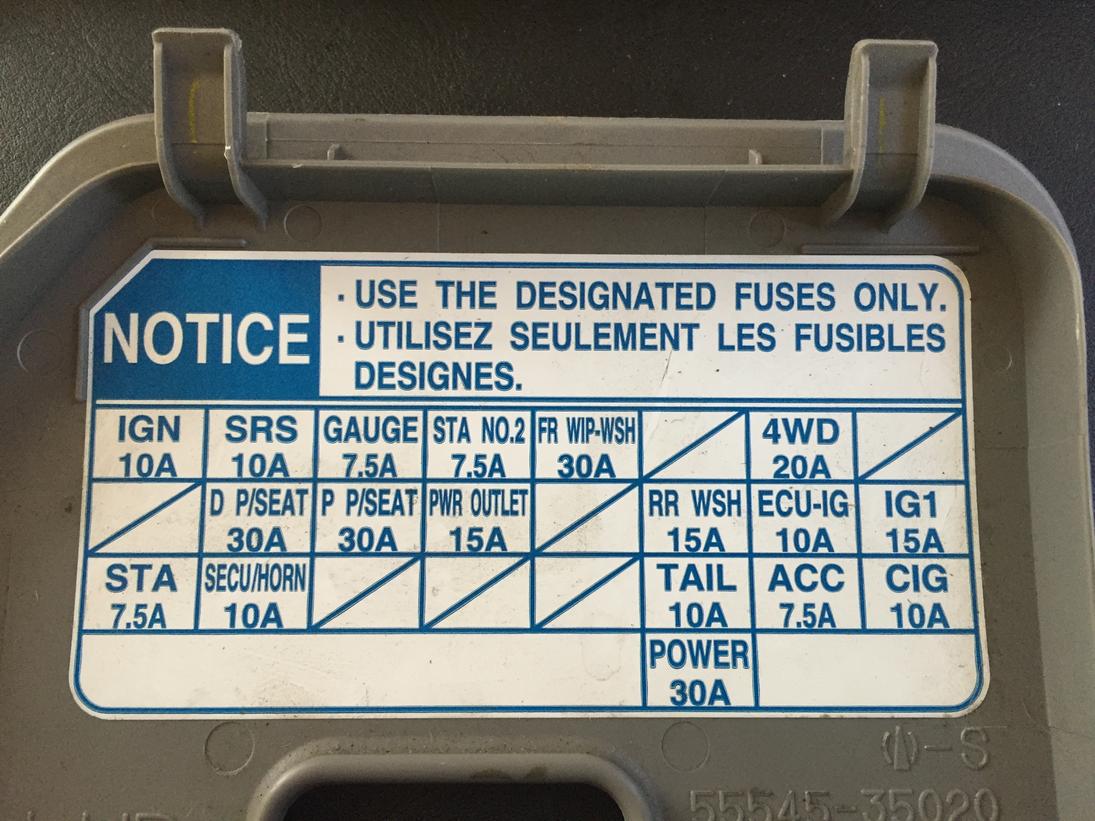

The mirror runs off of the switchable ACC 7.5A fuse lower left driver side kick panel. Also, check fuse #21 in the engine bay which gives power to the HomeLink wireless remote control (garage door opener) constant hot, courtesy lights, keyless entry etc... while the truck is off.
Hope this helps.

You can also check the plug to the mirror they are notorious for just disconnecting with road vibration fuse 21 in engine bay also controls dome lights its a 10amp and bottom left in the cab is the sta 7.5amp fuse are the ones to check could also be a faulty mirror it just died
