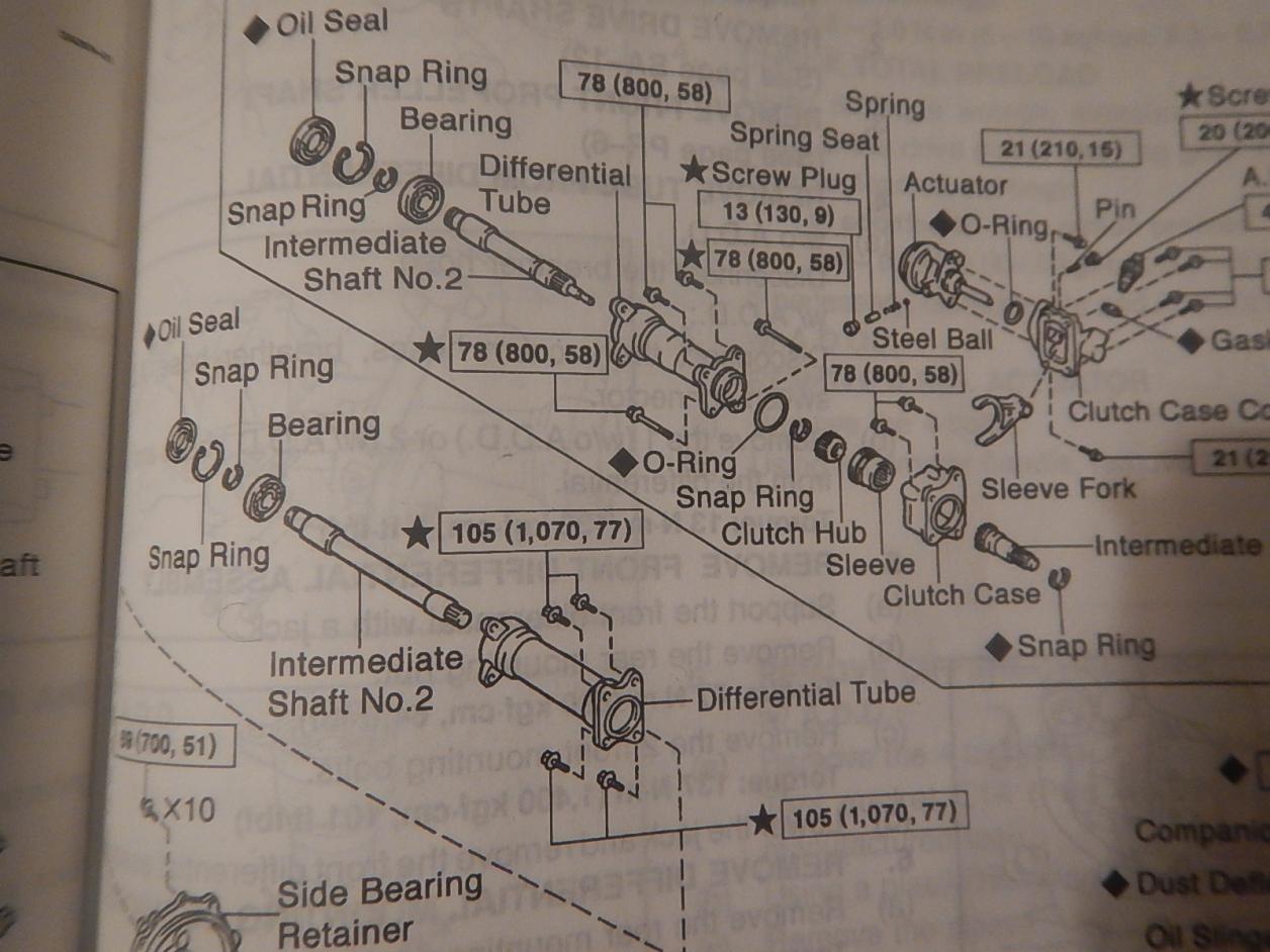

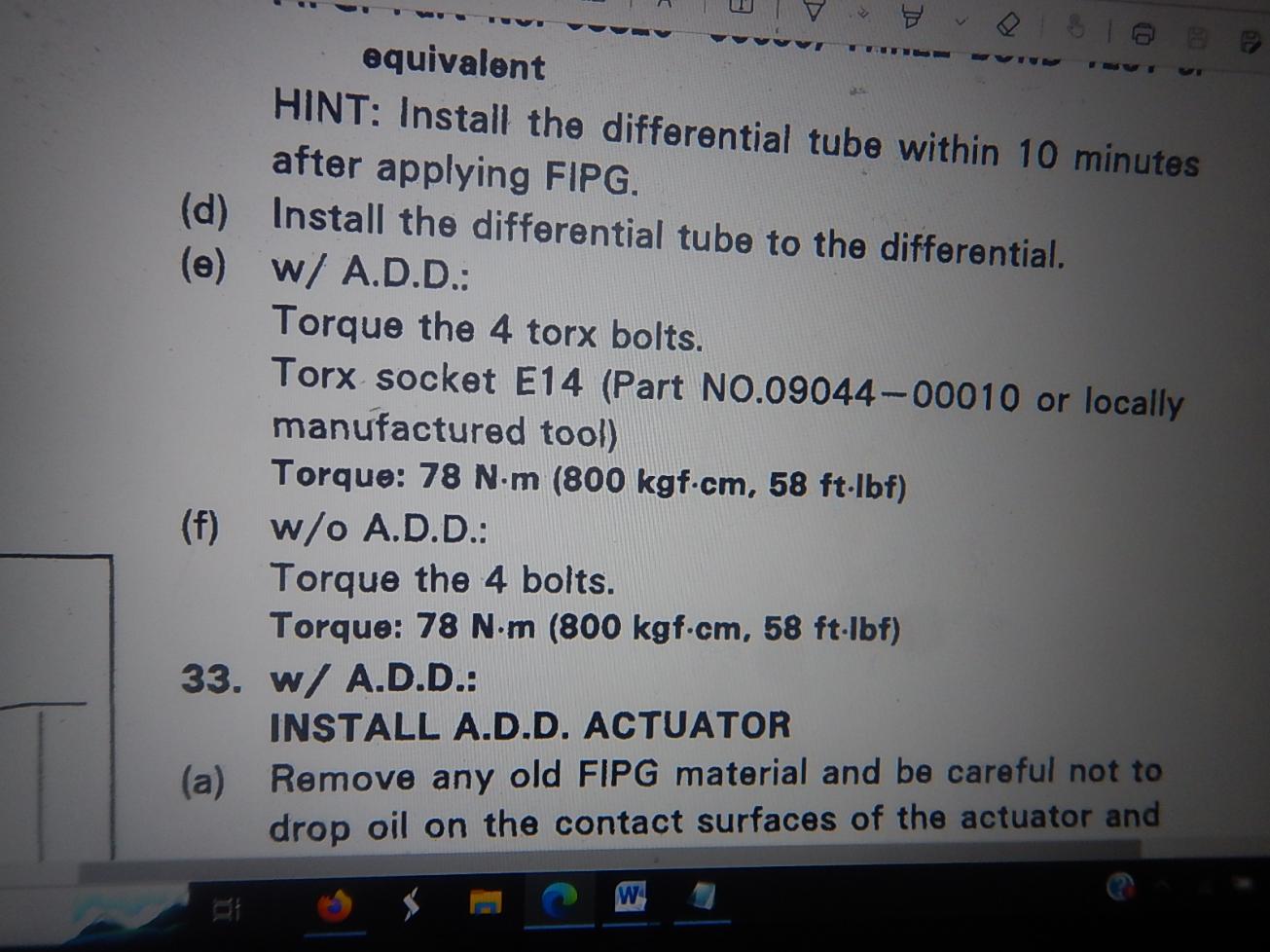

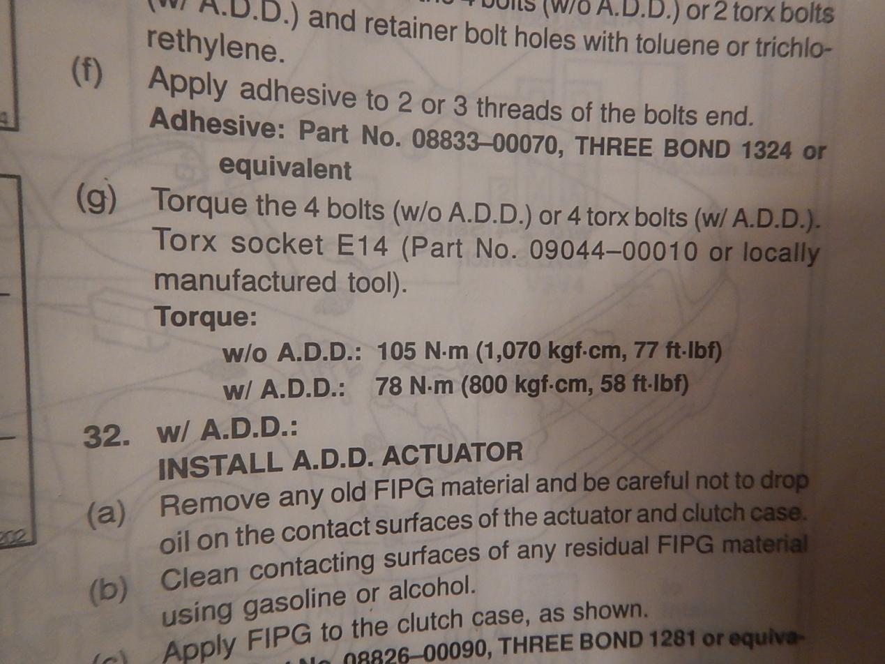

Hey I am completing my manual hub conversion (using 1996 Tacoma parts) and am finding conflicting torque specs. What are the torque specs for the Tacoma non-ADD front differential tube bolts to the 4runner front differential?
The torque specs listed in my 1996 4runner factory service manual specify 58 ft-lb for the ADD diff tube (E-torx bolts) and 77 ft-lb for the non-ADD diff tube (Hex bolts). But I also downloaded a 1996 Tacoma factory service manual which specifies 58 ft-lb for the ADD and non-ADD diff tubes. I was originally just going to go with 77 ft-lb, but I don't think they made non-ADD 4runners in 1996. So can anyone help me out. Thanks.
From 1996 4runner FSM:
