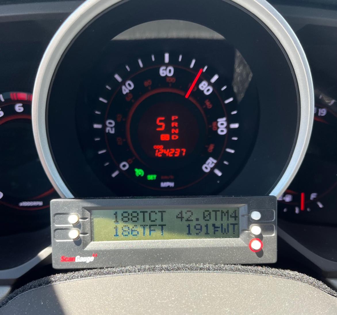

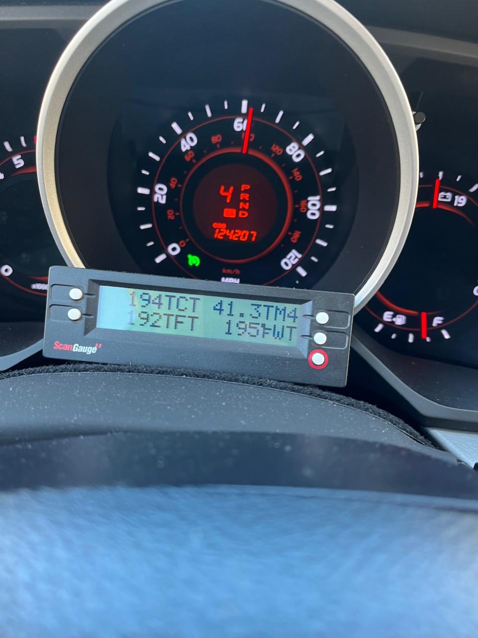

I've been fourwheeling in low-range in sand, in 110° F temps, with the A/C blasting, and the warmest I've seen for coolant temps is 197° F, and 207° F for convertor temps on my Scangauge. Both temps are well below where you would get an overheating warning.

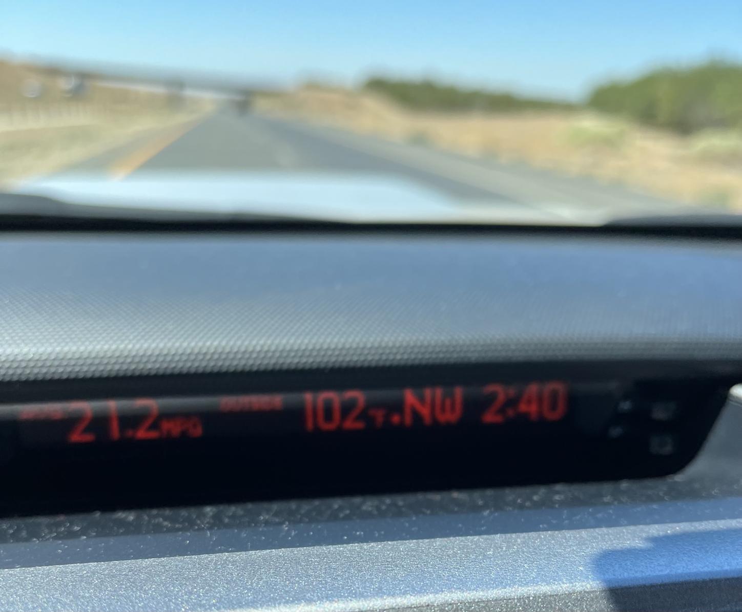

I need to change my first post a little. Found a couple of pics of my ScanGauge from a roadtrip in 102° temps. Shifting to 4th for steep grades helps to keep torque converter temps reasonable.
