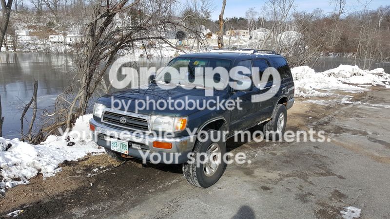

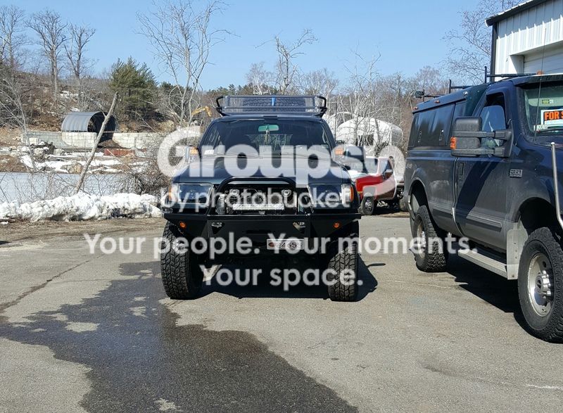

Finally able to post up and get a build thread started. Trying to get it rolling before I forget what I've done to it so here goes.
97 Runner SR5 - 170,924 mi
Updated Pic 2/23/2017
20170223_113226.jpg~original
20160423_171908.jpg~original
20160215_104024.jpg~original

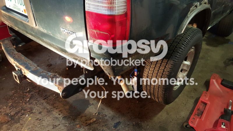

Cut my rear bumper off a few nights ago and ended up installing the rear half of the lift today. OME 891's, Rough Country shocks, adjustable track bar and removed the sway bar. Went from 35" to 38 1/4" in the rear.
I'll edit the post in a bit with pictures.

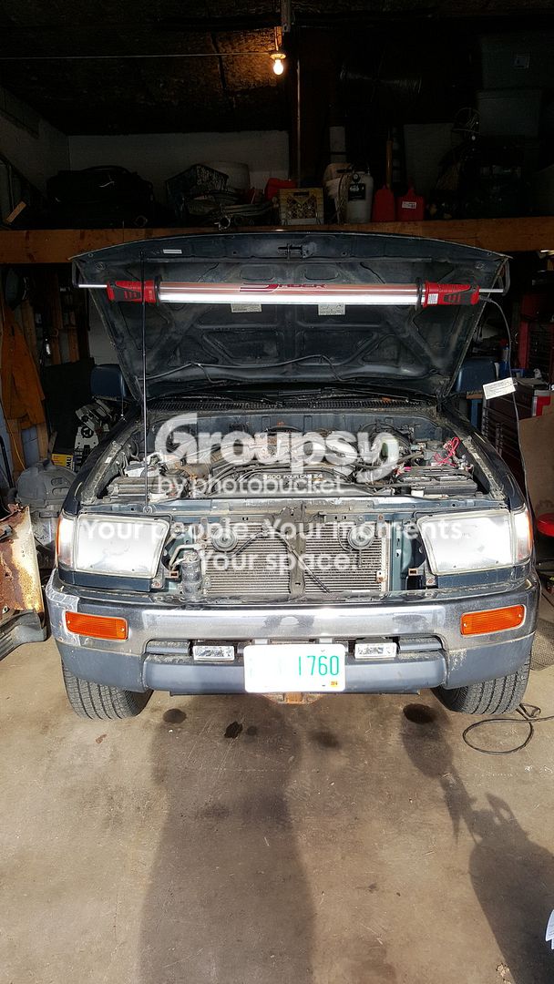

Productive day out in the cold today. Pulled my grill so I can install the trans cooler when it comes in. Might prep for the Satoshi mod too.

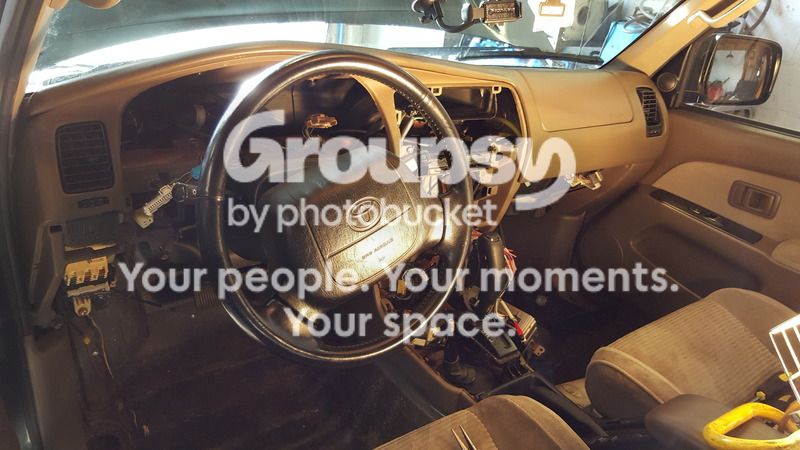

I ended up finally gutting my dash too. I had mice or something living back there so I wanted to clean it out. Im sick of the urine smell. Theres marks from it dripping down the front of the glove box. Air bag looks to be intact though so I think im good. Also decided to mess with my radio, its not working and Im not sure why. If I hit the reset button it kicks on for a second and shuts off. I can hear a relay somewhere behind the dash click, but nothing after. Im doing some research on that now. If it comes down to the deck being back I might switch to a double DIN with a screen.

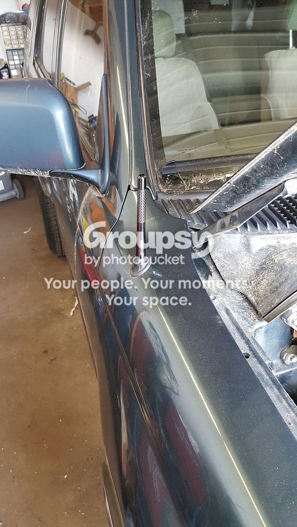

Installed my new stubby antenna. Havnt tested yet because my radio is still crap, but that should be fixed soon.

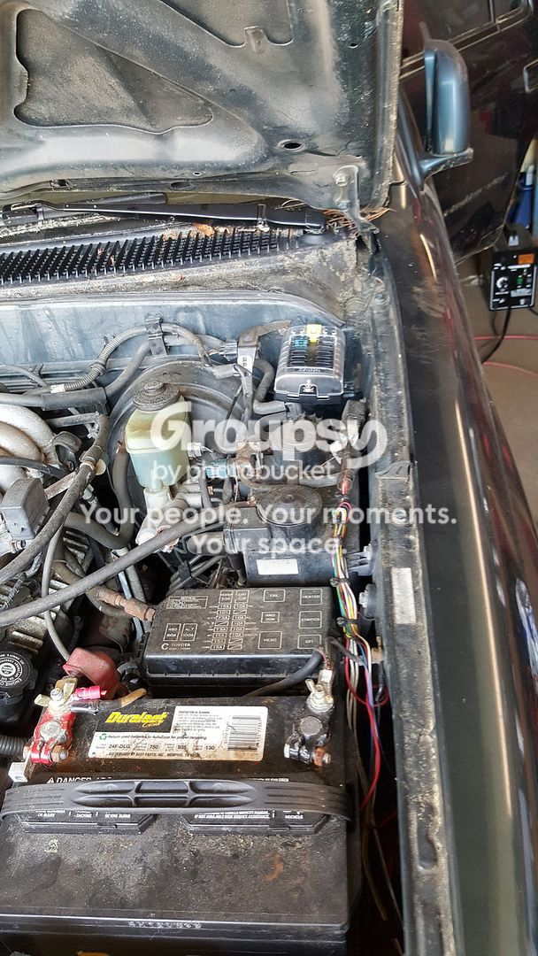

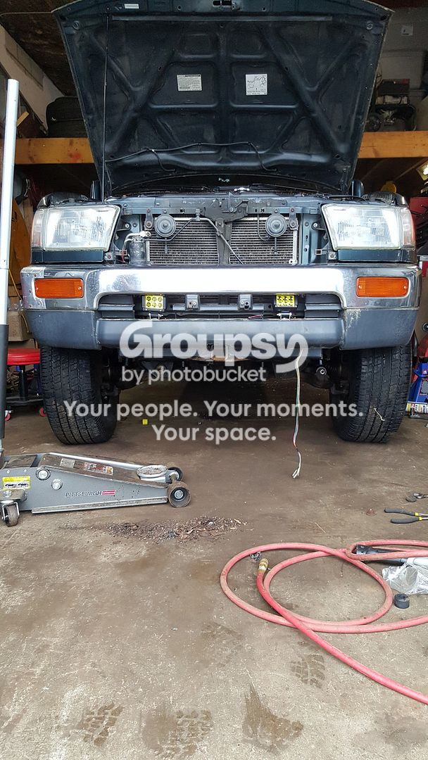

I mounted my new fuse block and ran my power wire today but didnt connect it yet. I need to pick up a new positive battery terminal tomorrow that has the multiple ports for audio equipment.

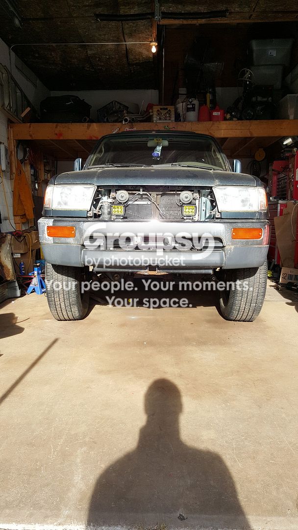

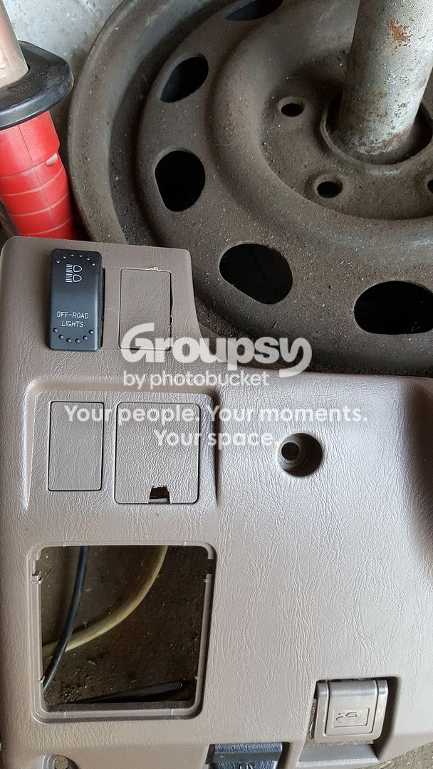

Mounted my new switches in the dash and my LED pods, which unfortunately need to be moved somewhere else. I didnt realize the bumper wasnt as uniform as I thought. I need to rethink this I guess.

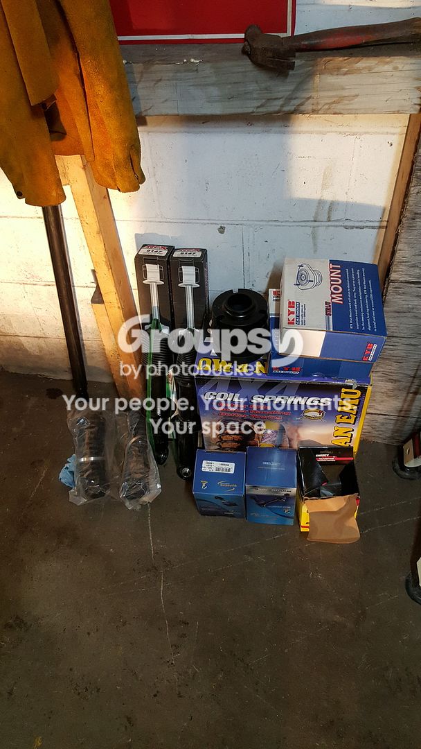

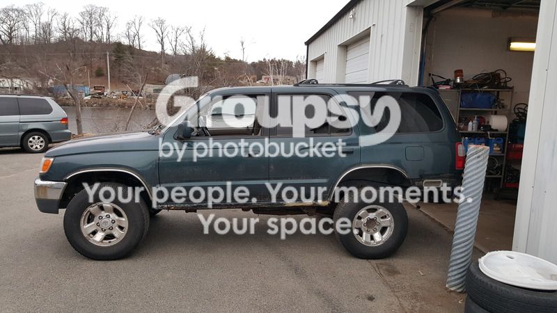

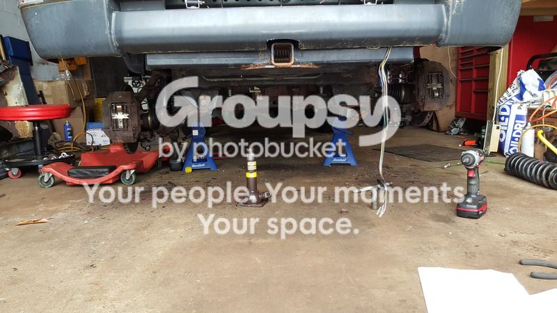

The big ticket item for today is that I started the lift on the front end. I pulled both front struts (after a bunch of fighting with studs spinning and what not) and then rebuilt one of them. Im using new struts, top spacers and preload blocks, new bushings and the old coils. If Im not happy with the final product I will see how much I need to gain before getting coils. Im hoping I can roll with the stock ones for now.
Thursday Im going to rebuild the other strut, install the diff drop and install the struts. I also still have parts rolling in. Im hoping my ultragauge will be in as well as my trans cooler. Im just playing the waiting game with those. I cant wait to mess around with the ultragauge though, I checked their page again the other day after I ordered it and really want to test out what it can do with the 4runner.
Almost forgot, replaced the air filter too. Not a big thing, but the mice had taken a few small bites...
Didnt take a whole lot of pics, but heres what I got.

Had a couple hours at the shop today. Finished the lift and diff drop in crunch time before going to pick my kid up from school. Im super excited about that. Also managed to wire in the fuse panel and install my deck plate. The last part arrived today, drivers seatbelt from Toyota.

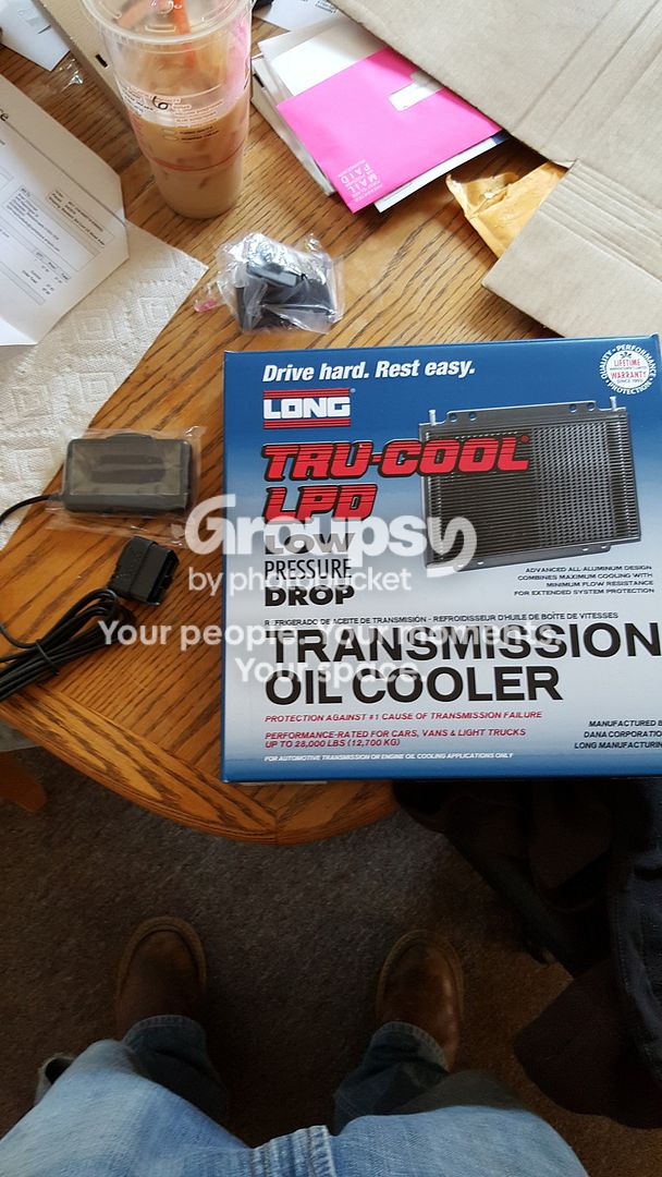

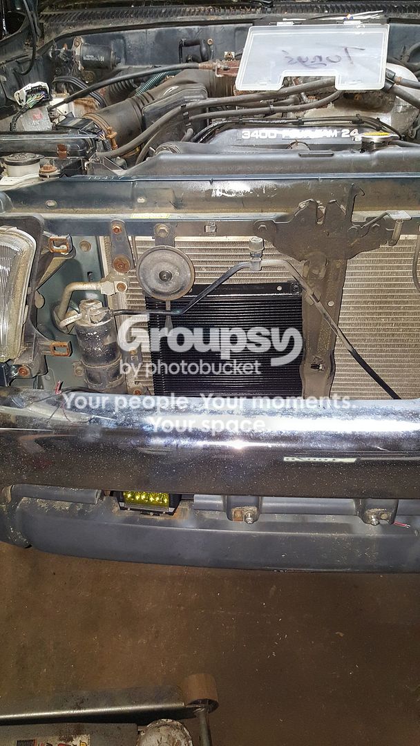

Well, it's been another productive day. I mounted my trans cooler last night and ran the lines today. Got it fired up, shifted through the gears, and didn't have any leaks. I'm pretty pleased with it.

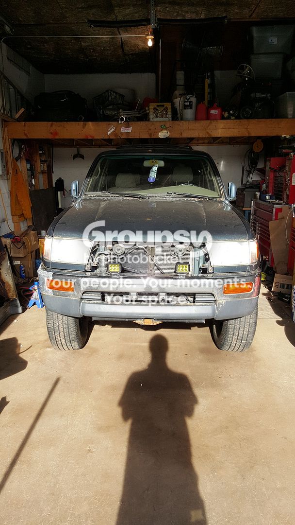

I also remounted my LED pods and got them all wired up. The coloring is a little weird with the yellow tint, but they work. They are super bright for an Amazon special. In the process I got half of my dash back together. Last night I ended up pulling my blower motor and it was about 1/2 full of acorns too.

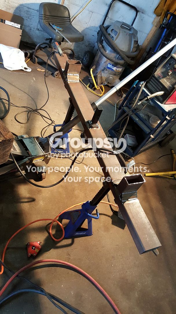

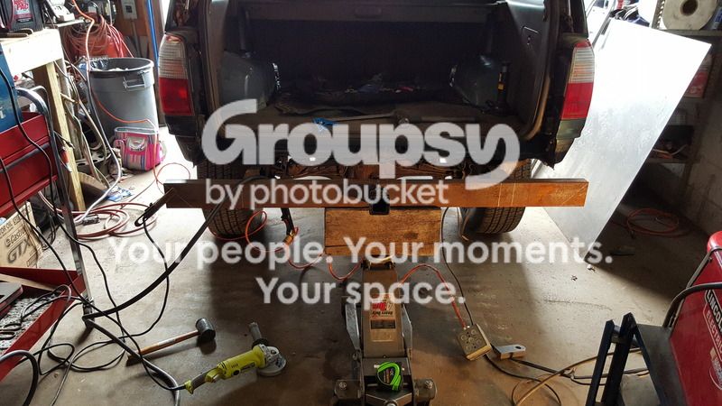

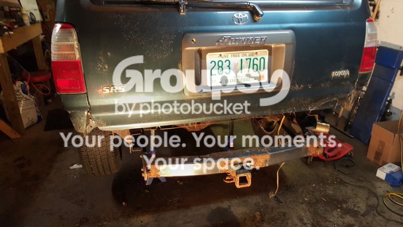

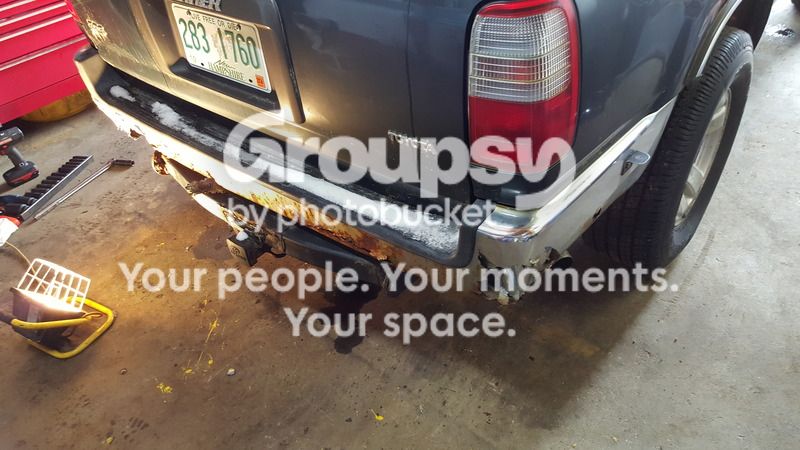

Got some more work done yesterday. I finished the rocker on the driver side and got it coated with bed liner. I have most of the bondo done on the passenger side, but it should be finished tomorrow and painted.

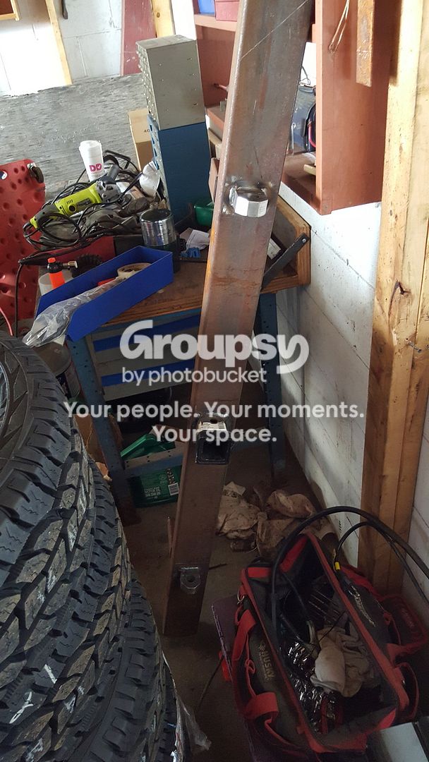

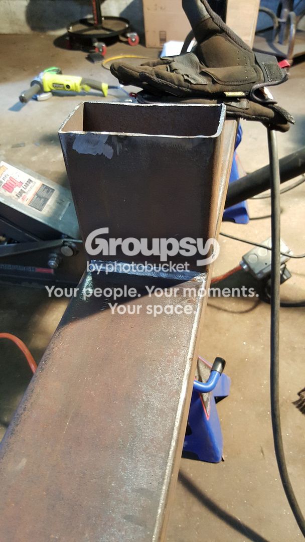

I finally got the grave digger cut off the rear too and started prepping the frame to coat before I start the bumper. Im waiting to hear back a quote for material. Heres what I put in the order:
6' - 2"x5"x1/8" rectangle tube
6' - 2"x4"x3/16" angle
20' - 2"x2"x1/8" square tube
4'x4' sheet of 1/8"
I still havn't quite decided on a final design, but this should cover it. I already have weld through d-ring tabs and a receiver for the bumper.

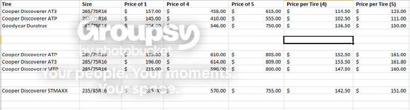

I'm also jumping on the DTD tire deal. Not sure what tire I want to go with and its the last day of the sale. I talked the wife into letting it slide since I have a tire that wont hold air and the lift went in... Im thinking of going 265/75R16 AT's since I might be moving to Cali for work and will most likely need to pull a small trailer. Let me get some input please! Stock tires I went from 35-37.5 ground to fender and rear was 35-38.25.
tires.png~original

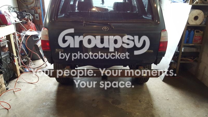

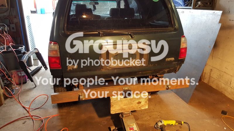

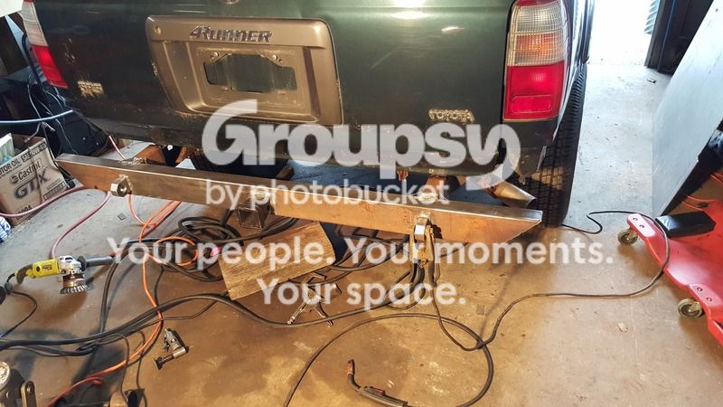

Its been a slow week. Started my rear bumper and the new tires came in. The bumper SHOULD be done tuesday as long as my wife doesnt interfere again... Hopefully I can get my tires mounted this week too. Heres some pics.

Well, heres todays update. Bumper got put on yesterday. The center section atleast... Heres some pics for everyone. Next is the wrap arounds and body work on the passenger side. After that all I have left to do is get a new radio, reinstall my blower and dash pieces get my tires on, alignment and then it should finally be ready for registration and inspection...

For external work, I got my LED pods aimed and they work awesome! Not my first pair of them but I am pleased with how they came out with the yellow lense tint. It makes a slightly funny color but it will work.
