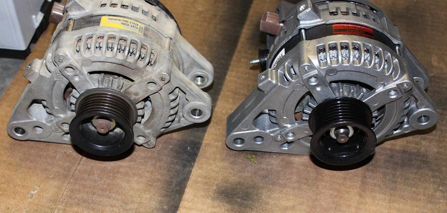

Last week, on the way home from Redmond I noticed this increased sound from the engine area. Sounds like a bearing Bzzzzz sound.
Has been averaging 95*f for the last few weeks.
Then I notice that the battery is slowly loosing voltage as I drive.(scangauge2) Thinking the alternator went out. Front driver side engine bay area for the Bzzzzz sound.

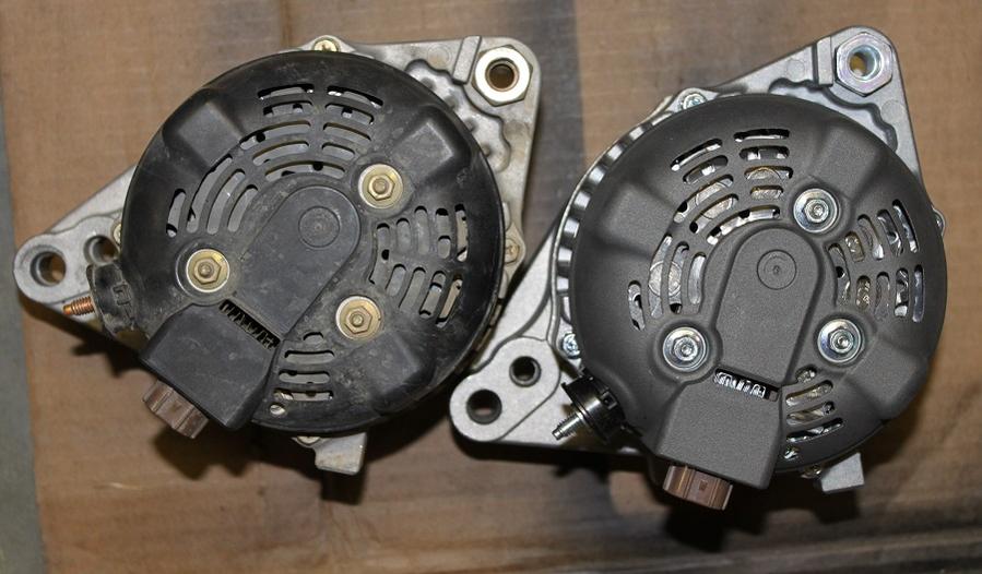

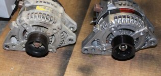

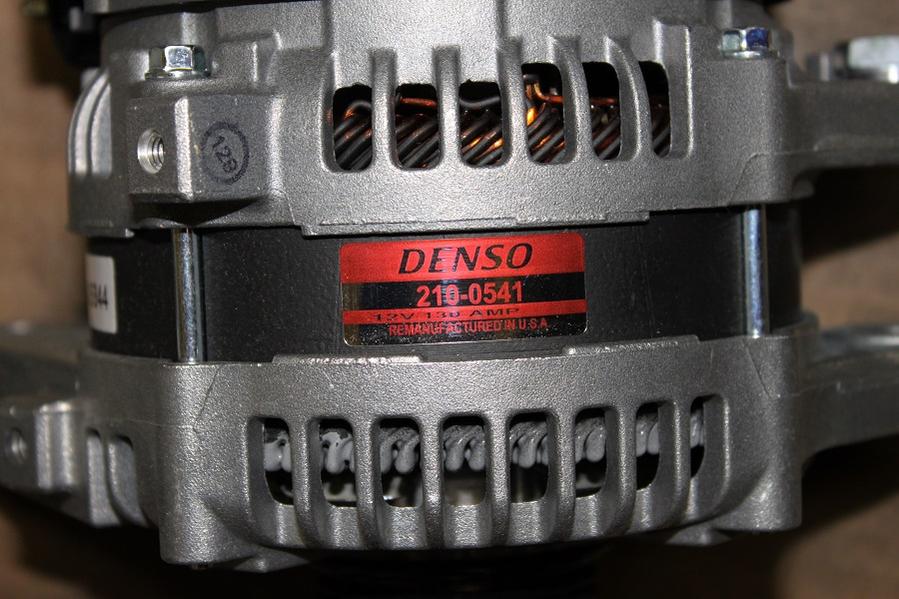

Replaced the alternator with a Rockauto Denso reman. Looks identical.
Seems like its is charging now but it still has the Bzzzzz sound...like a bad bearing or something...That I thought was the alternator...wth?
Went through all the fuses and they look good.
Wire to engine bay fuse box looks good.
Pulled the fan belt and spun all the idlers and any spinny parts I could and it all sounded fine...no grit/resistance in any of the bearings.

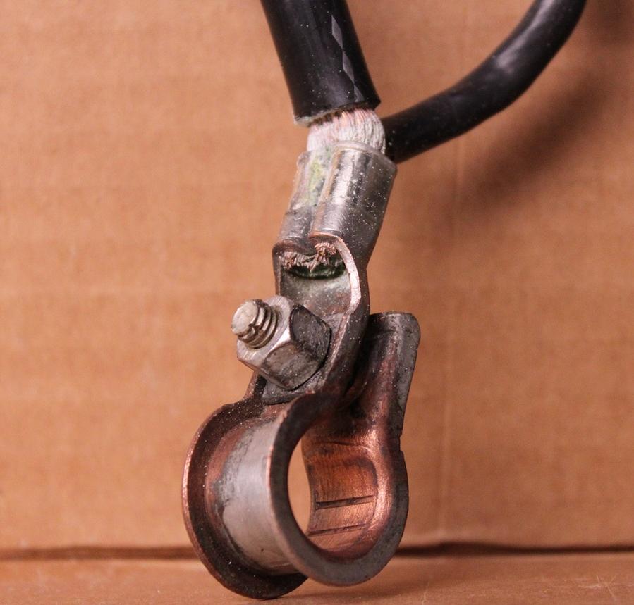

I am at a loss...going to fix the grounds and see, some corrosion and separated strands...why the noise though?
So thinking I would just upgrade the wires like I have seen a few other T4R members do..."the big 3".
Went to the local stereo place that had $8 a foot for 0g...I decided I didn't need to do that.
I am going to just do the Negative side ground now to see if that helps any.

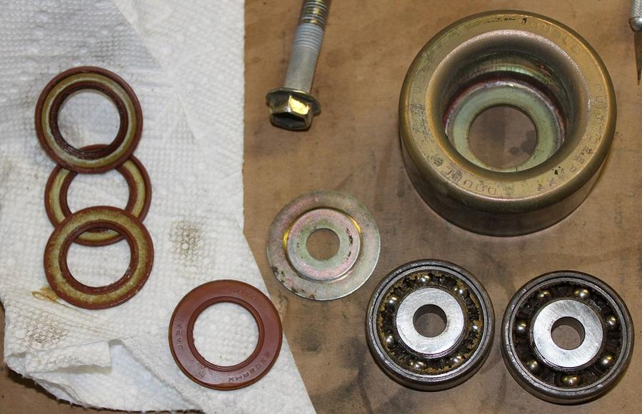

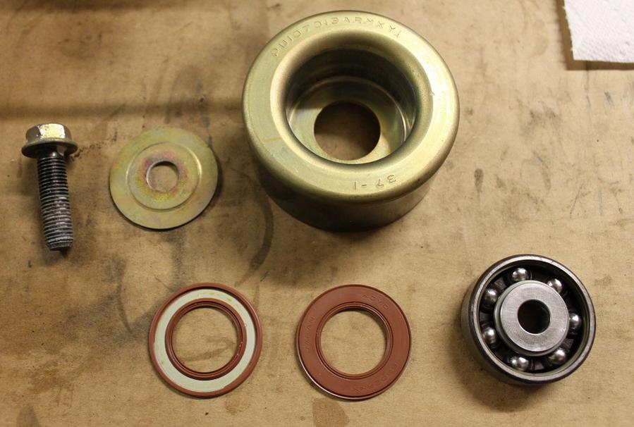

Just got all excited and had to dump some pics.

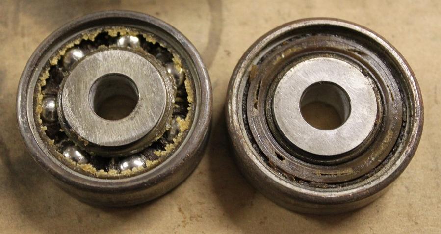

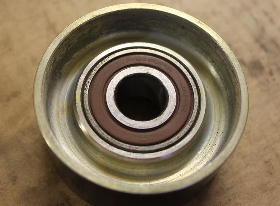

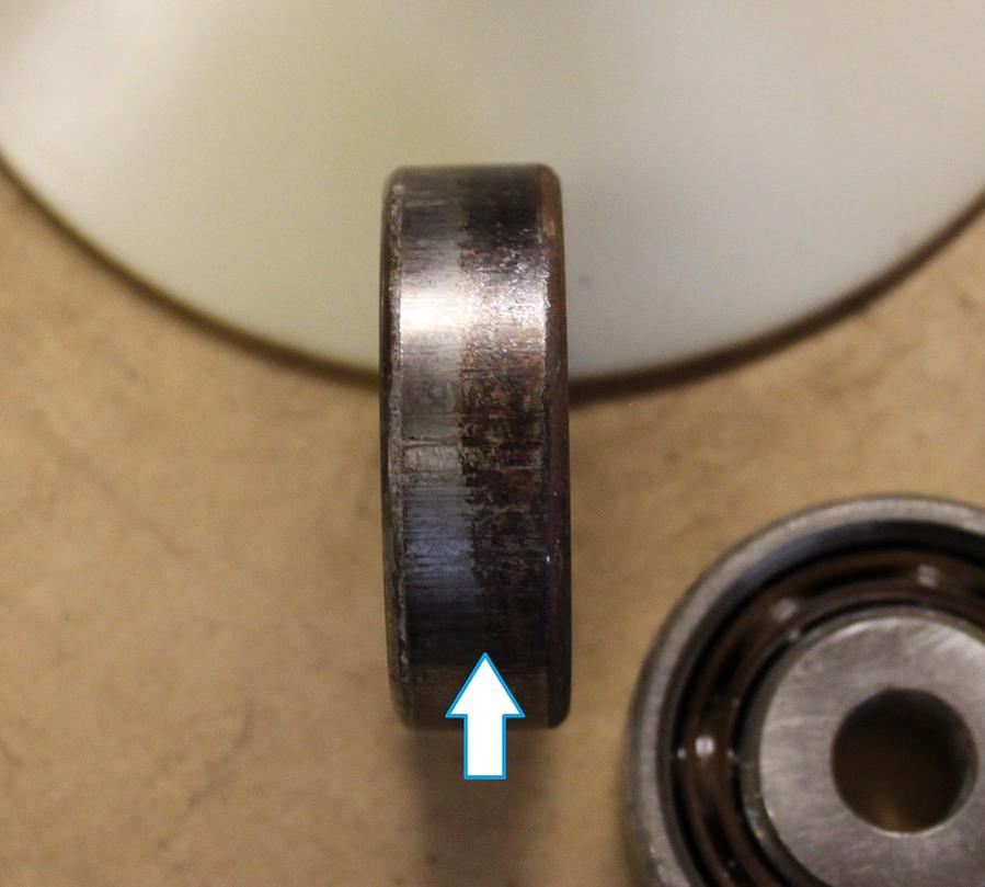

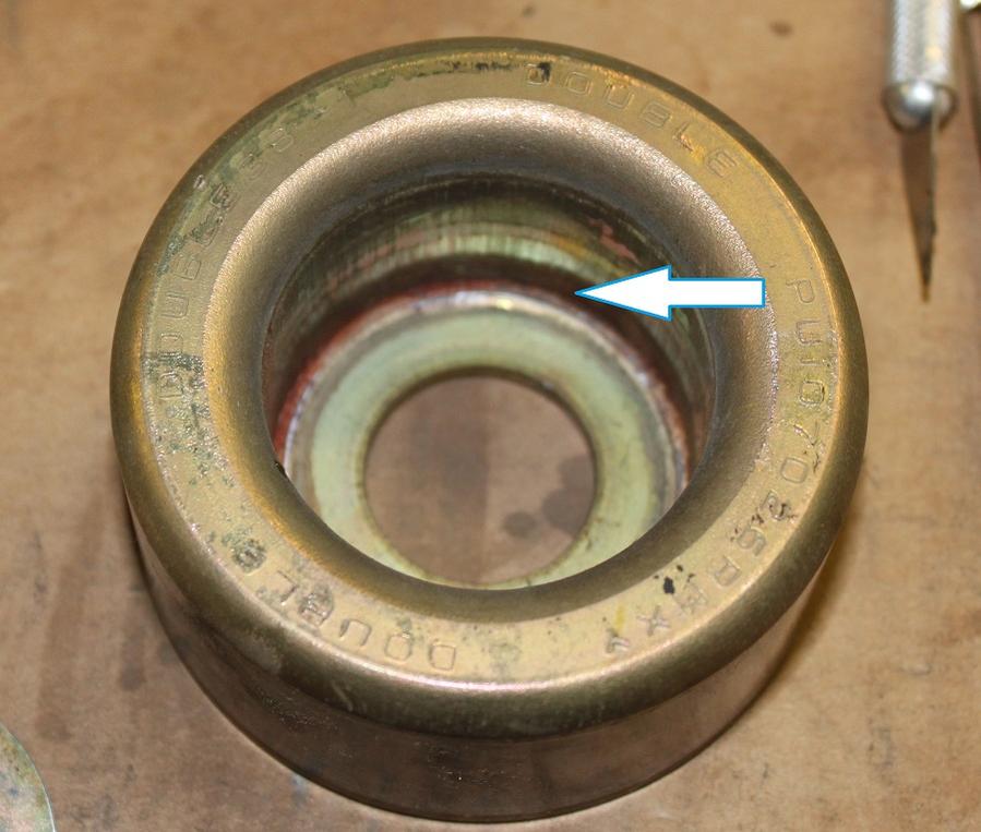

Bad Pulley bearings you say?
I think the leaking water pump introduced antifreeze into the bearing at some point. Can see wet/rust marks. Blue arrows in pics. Also a white powder...dried antifreeze.
I just pulled the bottom pulley and found this mess.
Cleaned it up and stuffed in my favorite Purple grease.
Will order up new bearings after I go back and read a few threads...seems like there was a bushing sleeve issue...

Still have a tiny, grrrrrr sound but I may just be hypersensitive now.
I think its fixed.
Cleaned the #2 and #3 idlers and the tensioner bearings.
The seals on the tensioner bearing was not friendly, bent and tore it a little...whoops.
The others were easy.

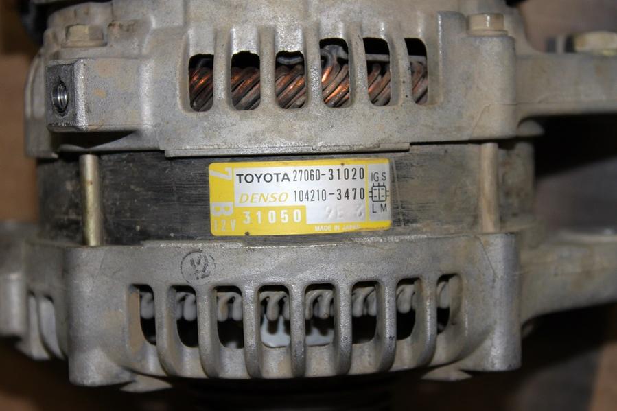

I was thinking I would get the OEM alt rebuilt or get a rebuild kit and do it myself.
Took my OEM alternator to a local, long time in business, auto electric shop.
They said..."we don't even touch alternators any more, try this other place..."
Went to the other place, complete other side of town, he said... "we don't rebuild or repair these any more."
Tested the alt and it tested 'good'...bah. Said the belt kept slipping, smelled like burnt rubber when he handed it back to me.

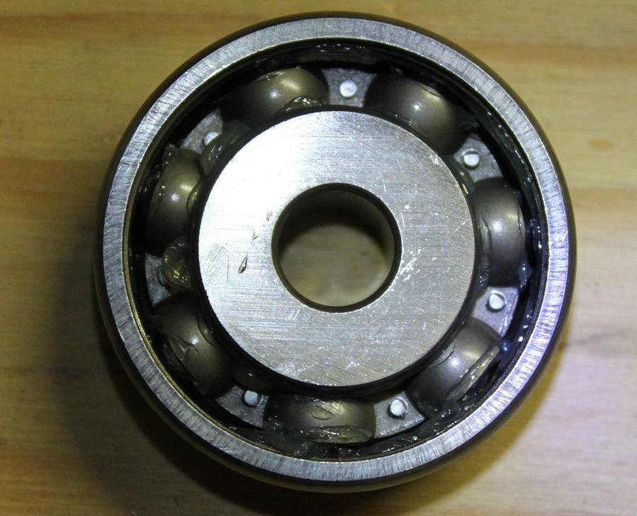

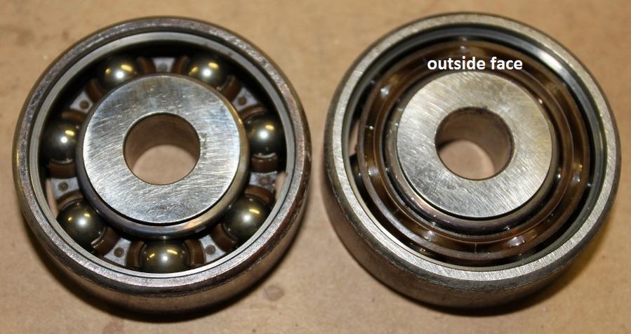

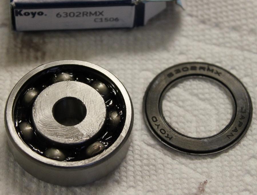

In case anyone wondered the difference between the black and red seal Koyo 6302RMX bearings.
The ball race is metal instead of plastic and there was not much of some type of clear grease.
Cleaned it out and did the UPG Royal Purple.

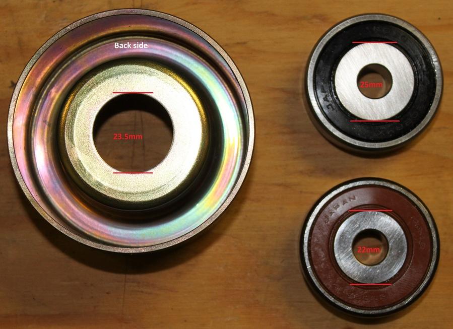

Went to install the new black seal bearings...not only do they not work I found out to much lube is a bad thing.
Grease is starting to get all over the engine front, from my re-grease, guess I will try 'less is more'.
The inner race is to large on the black seal bearings and comes into contact with the pulley.
Wishing I would have just gone that Gates pulley kit route now.
Pulley= 23.5mm
OEM koyo 6302RMX (red seal)= 22mm
New koyo 6302RMX (black seal)= 25mm
