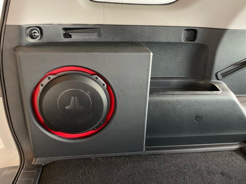

Not bashing on OEM Audio at all. But was curious if you considered having a local stereo shop quote you on a complete sound system with a custom sub enclosure? I went that direction after reading about the bass not living up to expectations for some and them wanting to add a second sub on the OEM audio setup. Seems that if you had a good 5 channel amp/components/sub enclosure and DSP you could exceed what the plug and play package gives you without needing to consider upgrading the bass. My sub enclosure is small and out of the way and honestly it's overkill for what I had in mind but sounds amazing.
Considering mounting a D-ring on it so I can use the cargo net.
Is that a 10 inch sub? All wood no fiberglass? Love it!
