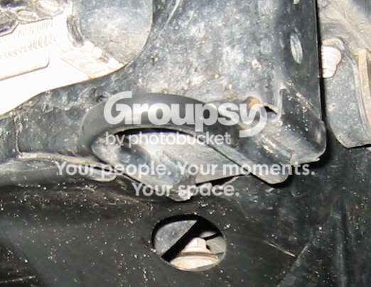

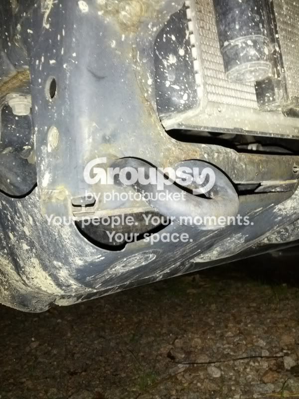

my tow hooks are different from this post. i didnt know that the newer 4th gens had different tow hooks.
my 09
IMG_20130926_223708_zps6037b2c0.jpg~original
an 05
4runnertowhook.jpg~original
Your later 4th gen hooks look just like what is on the 5th gen, with the hook going through the frame.

Interesting, the '09 4th gen loop and 5th gen loops appear to be stronger.

The loop on my truck doesn't have excessive rust like the pics in the link. It looks like pic of the 05.
