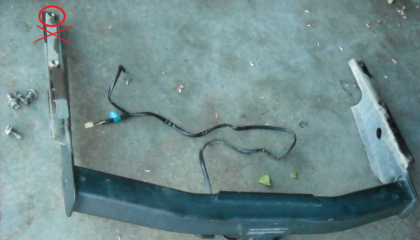

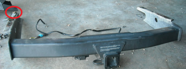

Looking for suggestions on how to go about removing my OEM tow Hitch. I have the same hitch in these pictures, albeit not mine and sourced from the forum, but the sweet MSPaint edits were done by yours truly.
Anyways, I've successfully removed seven of the eight 17mm bolts that secure this thing to the frame. As you know, the four, aft-most bolts thread directly into the frame, and the four, fore-most bolts thread into the stupid piece of flat bar with nuts tacked to it.
Problem is, numero ocho isn't cooperating. The impact successfully twisted and ripped the flat bar seen in the pics at the "X" mark. Now, the fore-most nut on the driver's side just spins freely inside the frame with the remnants of the flat bar it was originally mated to.
This section of the frame is about 2" tall, and about 18" deep from the opening at the rear of the frame.
I've tried the longest box wrench I own with no luck. the bolt spins freely. the nut spins freely.
Shy of cutting this bolt/tow hitch with a torch, anyone got suggestions?

I wish I could, but the bolt's only really released itself a thread or two....just enough to get it to spin on both sides. Essentially, the hitch is in the exact same spot as if it were completely secured into place.
Shy of pulling out the feeler gauge, I'd estimate the gap between hitch and frame to be about 1/16th inch. smaller than any sawzall blade I've come across
