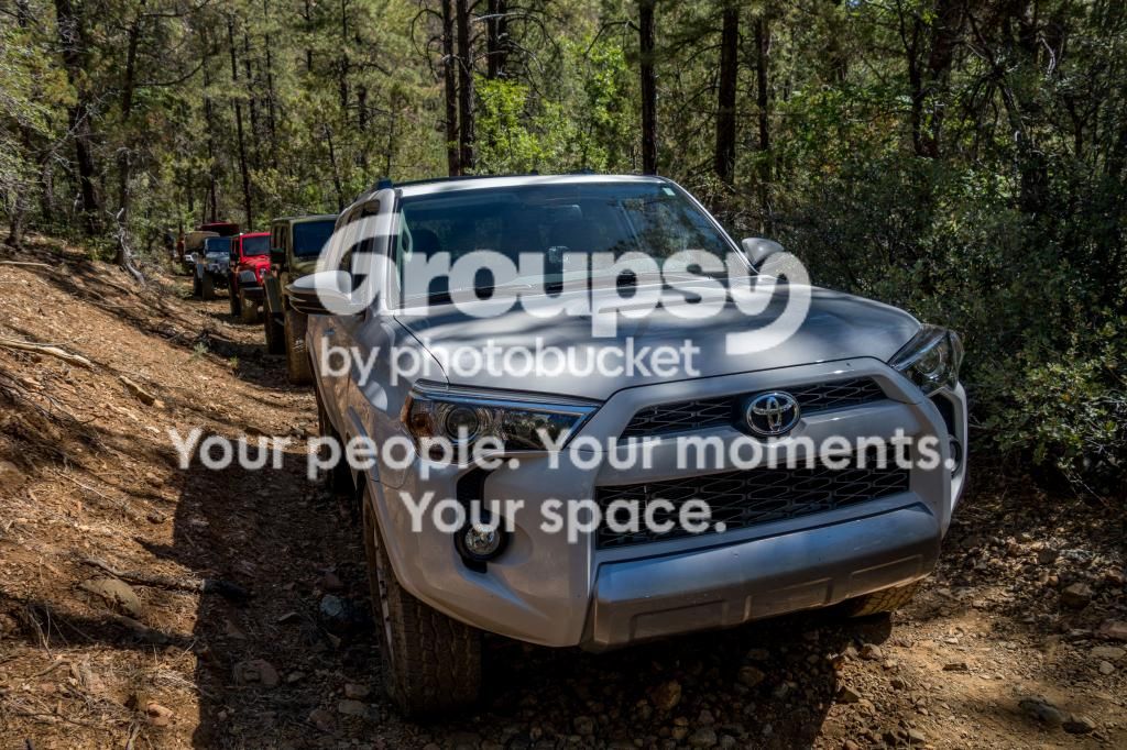

I posted this in the "What did you do in/to your 5th Gen today" thread but wanted to also post it here as it relates to running "P" rated tires.
The Prescott, AZ No Club Club had a recovery course this weekend; great time and learned a ton about winch's; hi-lift's etc...I was the only T4R; rest were Jeeps...I'm just running stock rig with "P" rate Toyo's (didn't air down) and had no problems running the trails. It was very narrow & rocky as hell in places and got tons of pin striping. There were 3 punctures (1 jeep while going up the fairly steep hill we practiced on and another vehicle lost 2! He stayed behind for a friend to get him.

With the Jeeps
