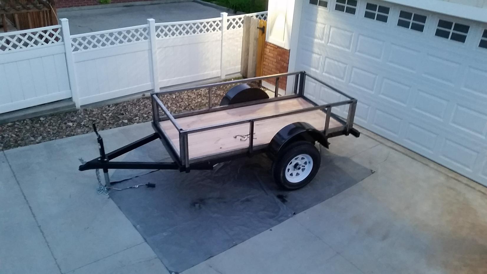

Seems like a nice trailer to start a build with, even though it is expensive for what it is. As a reference I brought a M416 back from the dead, bought it for $600 in 1967 tank ammo hauler status. Stripped it all down and had it all sand blasted, powder coated, stainless steal hardware, tires, rebuilt axle, led lighting and complete rewire, etc., etc....
All said and done I have about $2300 into it. Now the expo build begins :decision:. It's at the fabricators shop now......so starting off with the trailer you are looking at is pretty smart in my opinion. It's all new and a blank canvas. Please post a build thread about your trailer when you get the build going.

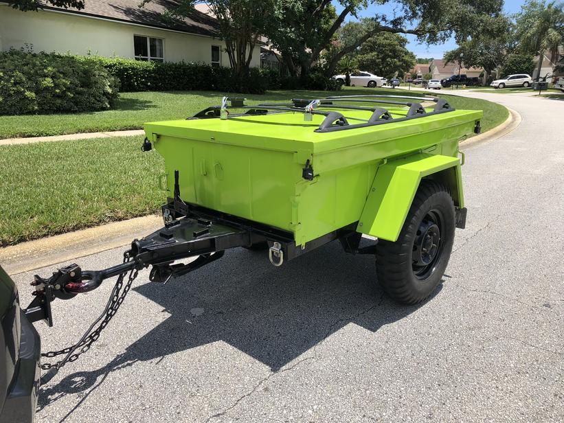

[MENTION=140851]Vinsil[/MENTION] My patience paid off with this bad boy we found and towed home from Jacksonville yesterday. Found it on CL. Took us a year to find one at the right price and in decent condition. Fully restored m416. The color is hideous because the owner painted it to match his Jeep. Oh well I guess it matches my Seahawks gear. Toyota hub/wheel conversion coming followed by a custom rack for our tent. Good luck with your search, hope you find/build you unicorn soon.
Real nice score man!!! I’ve got cash, none for sale anywhere near my AO. Gr at setup, super jealous!!!

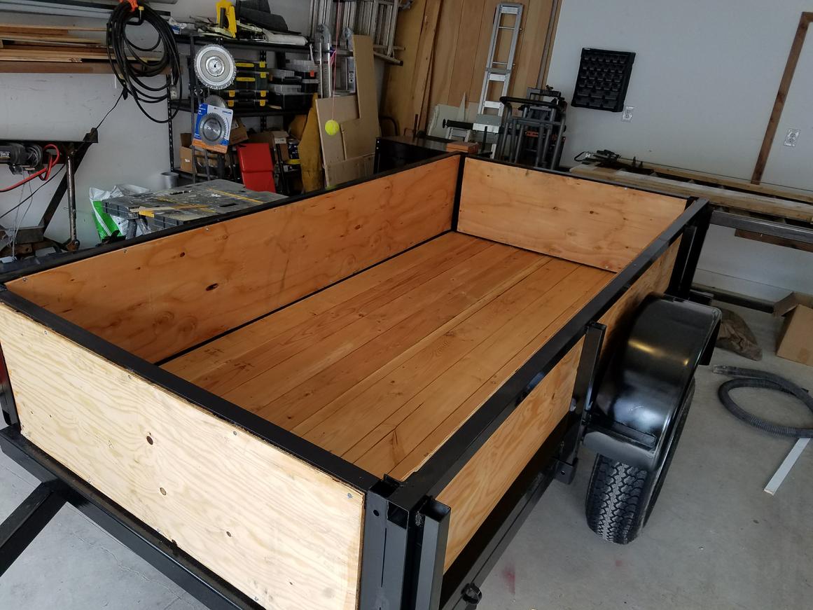

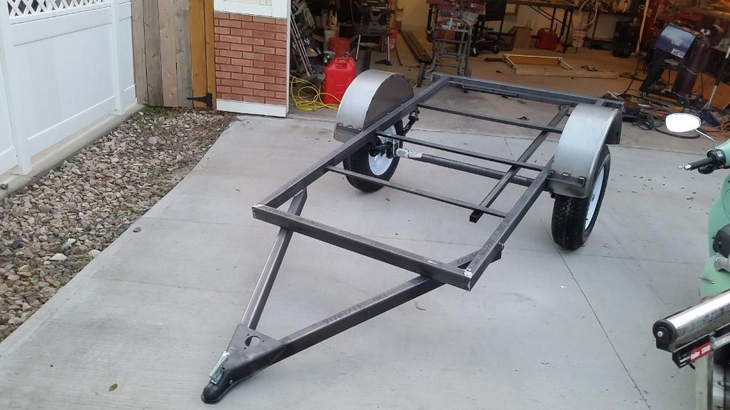

If you do build your own, I can send you a few drawings of how I like to build small trailers. If you don't have a good band saw - get all the main tube parts pre-cut at the steel supplier. It costs me $2 per cut. (I have a band saw so I do it myself, but next time I'll probably just get a pre-cut batch of parts ready to go). The main goal for me is just making them very easy to build. I can usually build one ready for paint in a day. Parts cost about $750 for the basic flatbed version. More now with tariffs on all the steel and stuff.
I've simplified my design to use only 6 pieces of 2x3 rectangular tube, an axle kit, premade fenders, and about 30 feet of 1.5x1.5 angle. Goes together quickly and makes a really solid small trailer platform. You can customize to your needs from there. Mine has all removable sides so I can also haul flat stuff. I normally just use it for hauling trash to the landfill. When I'm done with a project I'll usually sell the trailer and build a new one in the future as I need it.
This trailer should cost around $1,000 without brakes. Maybe $150 more with brakes. I don't see any reason to want or need long travel suspension. I could see the value in upgrading to torsion axles for more ground clearance with smaller, lighter weight, tires. (add another $200ish) But if you're using matching tire size for your truck - any axle setup will have more clearance already, so I'd go with a regular cheap one.
A sheet metal shop should be able to make a really nice top cap that will fit on a set of tool boxes around the edges. I'd have to price it out. My guess is something like $250 for the top cap. Or you could design it to match a specific truck bed size. Then you'd buy an off the shelf taneau (I dont' know how to spell it) cover. No reason to reinvent the wheel for this. Use stuff you can already buy if possible. It'll save a lot of headaches and money.
Just a few more thoughts from my experience. Hope they help you find what you're looking for. If you want some drawings of cut lengths and such shoot me a PM. They're about as easy to build as I can imagine. Or we should do a group buy and I'll build a dozen of them.
