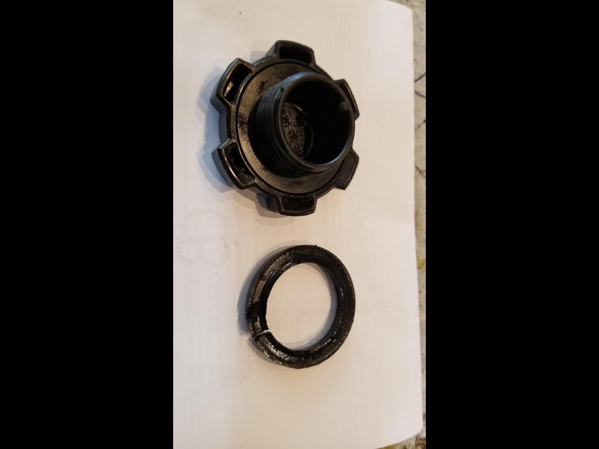

Replaced the gasket on my 2000 today. I had to dig the old one out with a pick tool.

I recently replaced the gasket on my '97 3.4. The new gasket exactly matched the old one, and the filler cap screwed on as normal. Maybe the cap on your 2002 is different?
At first I thought the gasket was plastic and part of the cap. I assume they just put the new one on top of the old one.
From what I’ve seen the tops of the caps differ in look of the print, but they all have gaskets. Often the gasket is so hard you don’t realize there is a gasket.
I’m lazy, I just order a new cap. They come with a gasket installed.
mine too was so hard I thought it was plastic part of cap. Not hard to replace and now my valve cover stays so much cleaner
